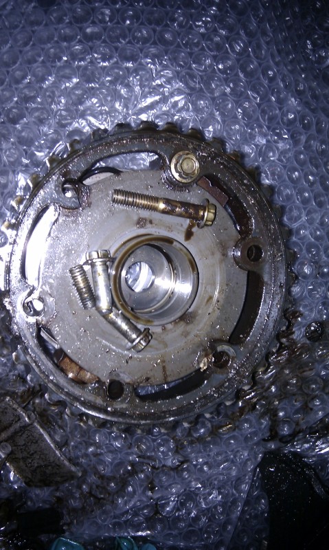

Danny at 519 repaired an engine where the dephaser had shredded itself,
the last time I was there he told me he'd never seen one fail quite like that.
The pics are on here somewhere.
  DON'T SEND ME PM'S!!
it still exploded though
someone tightened the blanking cap up so tight it cracked around the bolts and it all rattled loose until all the bolts sheared and everything parted company.
looked like the top end had just been (badly) rebuilt after another belt failure
