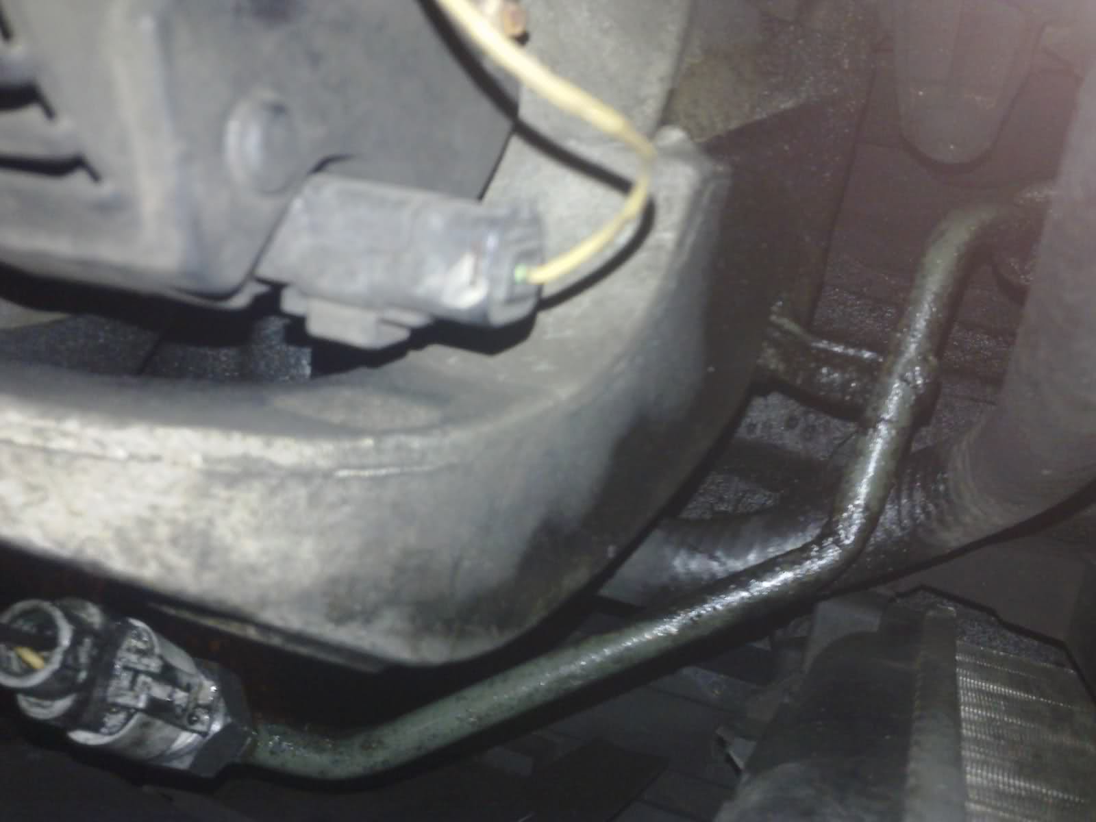

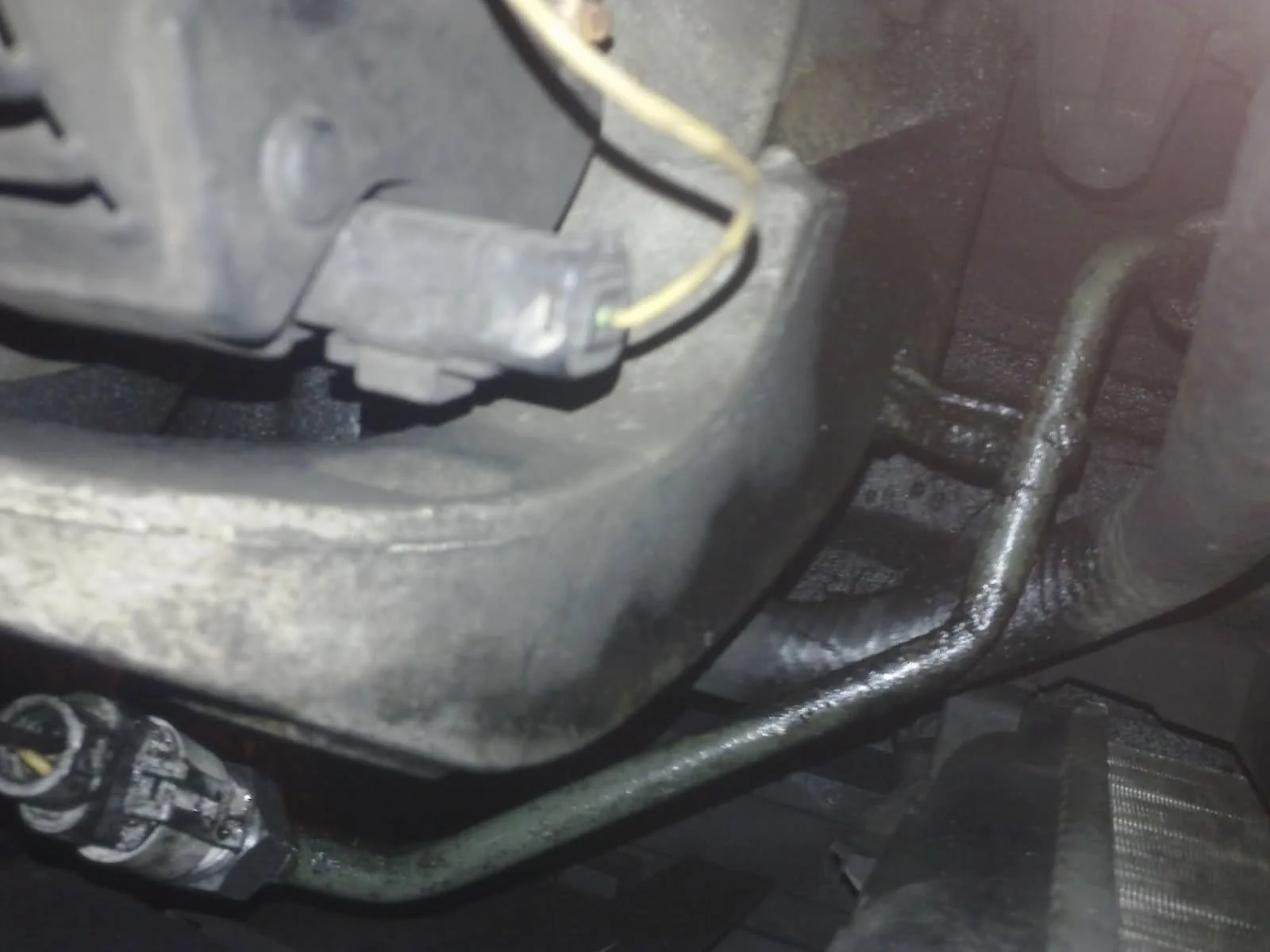

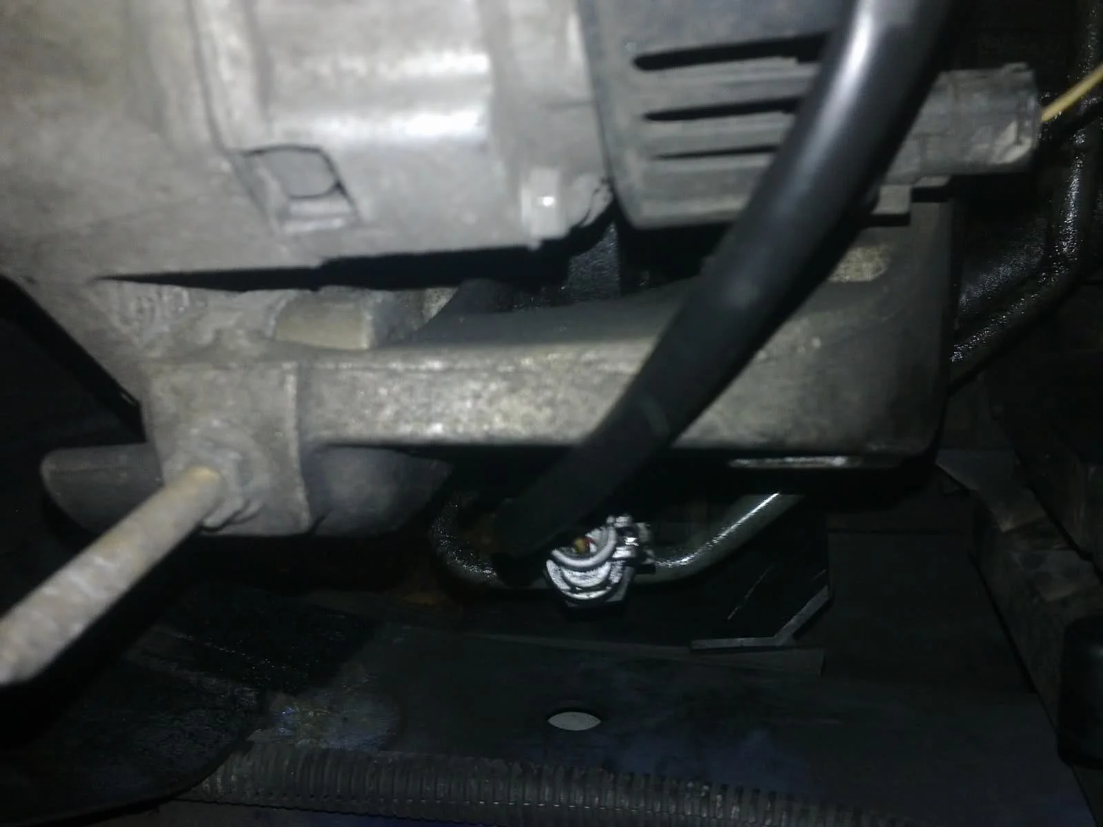

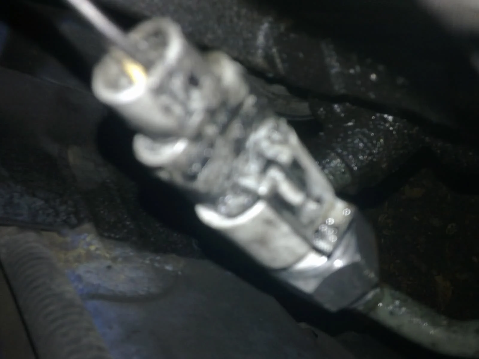

Sorry, for some reason i can't get the pics any bigger!!
that's it. it's difficult to get a spanner on it, but see if it'll nip up at all. go steady, though, as you don't want to be snapping any pipe
