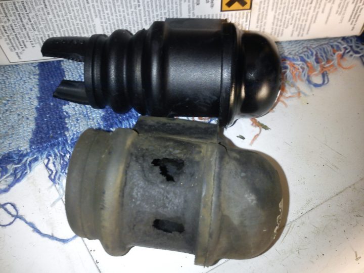

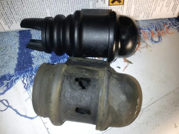

The photo you show is one derivative of the bushes ; these seem to be fitted to the smaller engined cars. The 1*2s came with this type:
The dealers order the wrong ones as well ; It's taken me almost a month to get the right bushes as a result of a staff f**k up. Initially when I wanted simply the inner and outer ARB bushes they ordered both types of outers. I made them aware of this after double checking, and then I ended up waiting 3 weeks for the correct outers to arrive. But they have arrived. Hopefully the car will quieten down with them fitted :).
