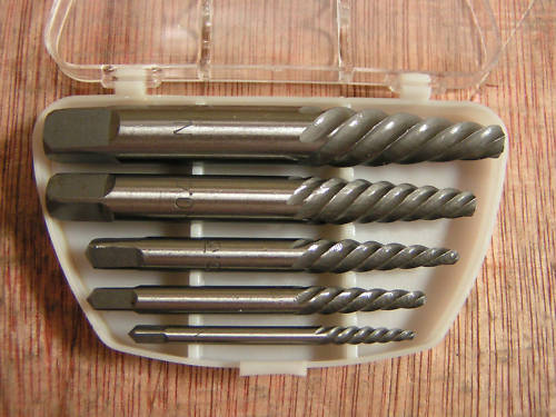

Screw extractors is the word your looking for :)

Personally i'd use a bolt extractor rather than those screw extractors . If the bolts in that tight it snapped the head off i doubt the smaller screw extractors would be up to the job . You run the risk of making what's left of the bolt worse .
Something like these would do it . Or take it to a local tyre place , they'll get it out for you .
http://www.screwfix.com/p/irwin-5-piece-bolt-grip-nut-remover-set/96028
I'm not saying this exact set , this is just an example . You'll need to measure the diameter of what's left of the wheel bolt then buy the correct size .
