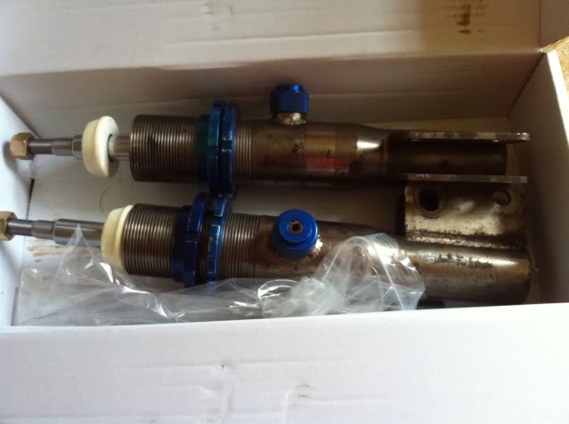

When I fitted front coilovers the two big bolts
do you have to move the hub inwards or outwards or makes no difference?
Thanks.

If you pull the hub out at the top you will lessen the camber, but you'll need the tracking setting up again. Did they not even advise you about the difference in camber per side?! Most normal garages won't adjust anything camber wise as these places generally employ idiots.
Standard camber is around .5 degree.

I presume this hole allows camber?
So I can use standard bolts?
Should I take it back and say why adjust camber?

1: I didn't think you could adjust caster on std top mounts?
2: What toe in/out did they do? Adjustment on the tie rods for that IIRC
3: If you've fitted the suspension in the pic above it looks like the top hole is elongated, you can use the OE hub bolt and still gain negative camber
  94' Valver F4R'd
I just slotted the top hole on my coilovers, did some funny calculations and machined them around 1mm towards the car on each side, put them back on, bingo. Perfect Camber.
