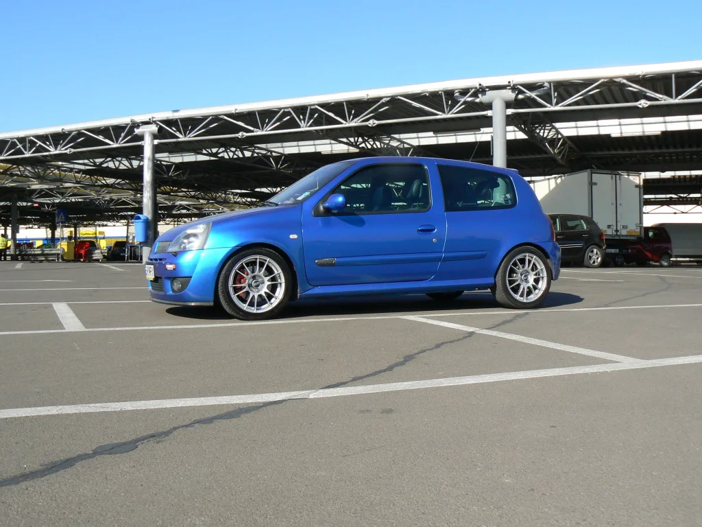

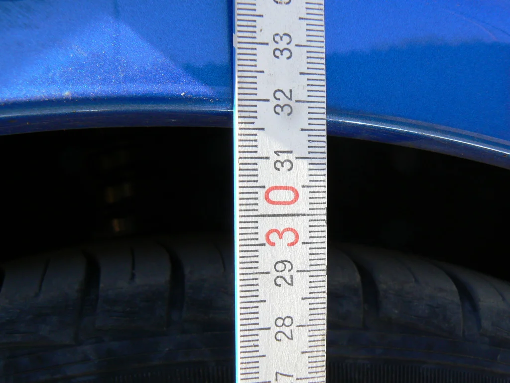

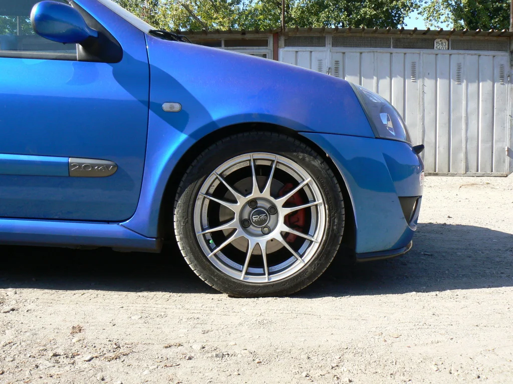

Just made some last (I hope!) adjustments to the car after fitting the gaz coils couple of days ago and I'm under the impression that I'm too low on the front, although I've seen here some silly low clio's
I'm having 32 cm from the center of the front wheel to the top of the wheel arch and about 11,7 cm from under the front splitter to the ground
I've taken some measurements and with the height as it is at the moment I may have about 2 cm left before the front shocks will hit the bump stop. Is this ok? I really don't know how those really low cars are going (probably with the bump stops removed?
some pics:
some other GAZ owner may take some measurements pls? would be helpful
thx!
