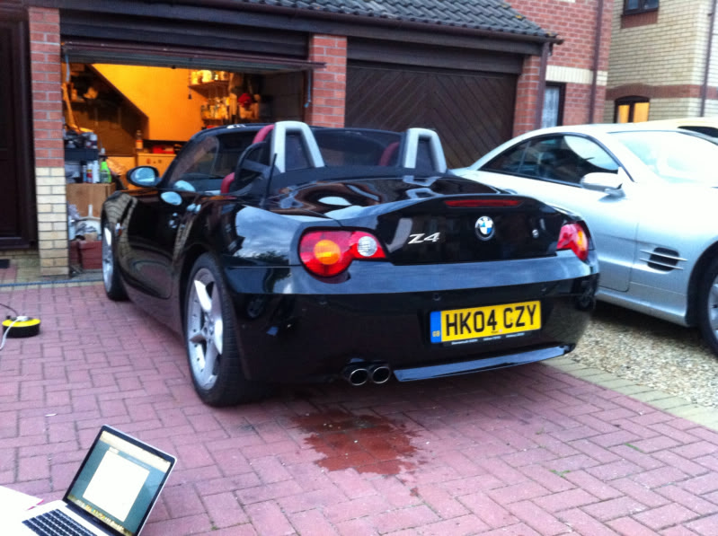

Cheers for that dude, gave it a go this weekend and I've had so much better results!
I think it could be that I'm getting used to machine polishing, but the BMW paint felt a lot softer than the RB Clio, strange.
Correction was still fairly slow, but manageable.
Here's a couple of low quality iPhone pics, not meaning to thread hijack!
The photos do NO justice! I've managed to eliminate pretty much all swirling and even tackled lots of deeper scratches with some wet and dry, argh! Brilliant results even if I say so myself, its like a black mirror with some mandatory BMW orange peel lol
