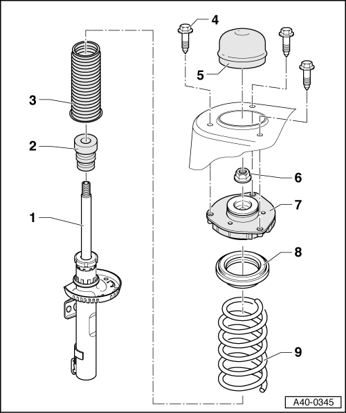

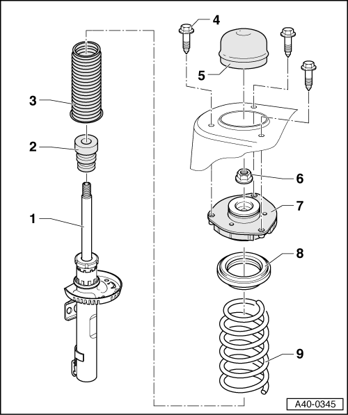

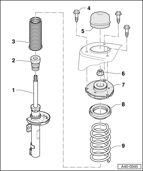

its the rubber mount at the top of the shock and the bearing goes under it. Its parts 7 and 8 in the diagram below. 7 is the "top Mount" and 8 is the "Bearing" (Note that is a picture of an Audi A2 shock, not a clio!)
They cause a knocking sound when they are badly worn out.
