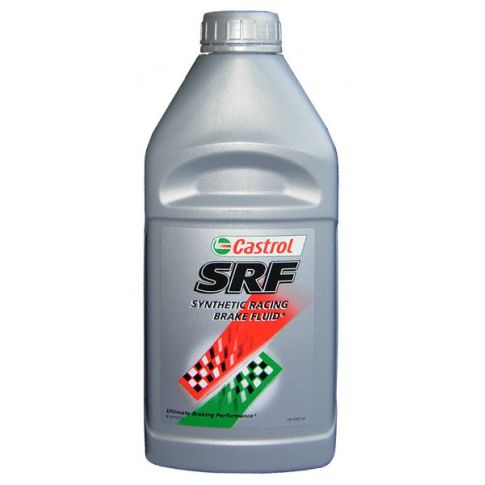

The price is big , but only this brake fluid can survive 25km special stage at OEM brake disc and caliper, with a lot of LFB

SRF is overkill for these in my op especially on the price. I used Motul 600. Ap 600 is also good and any others around that boiling temp.
