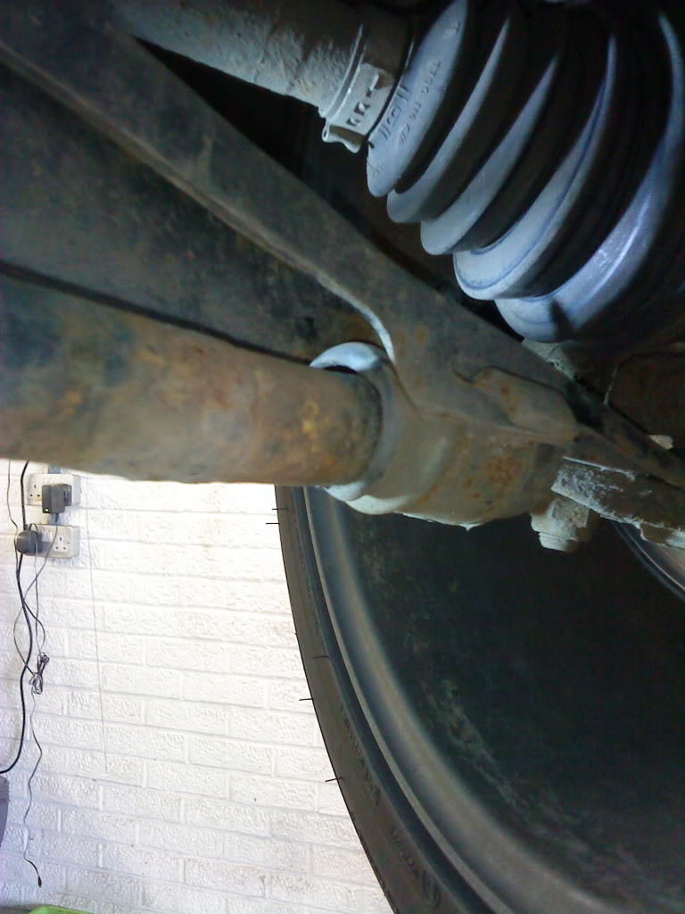

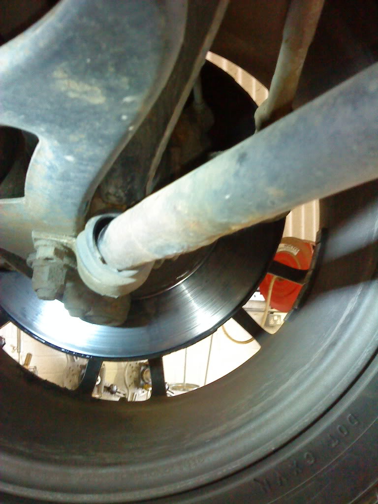

had a good look at the car on a lift today. ball joints seem fine, track rod ends seem fine, front shocks seem fine. the only thing slightly suspect we could find was this...
anti roll bar bush (car is on a lift)
does this look ok? should i get them replaced and if so would it be worth going for powerflex ones?
the car feels like the front end slips ever so slightly when cornering, like its just slipped for a split second during a corner. its not understeer. any ideas because as i have said, everything appears to be fine. the car is on 60k.
tracking is getting checked in the next 2 days but im 99% sure its fine.

Im no mechanic but it does look a bit worn/old. Standard bushes should be ok for replacement!

to be fair lke wouldnt have thought that the roll bar bushes would cause what u are saying.
