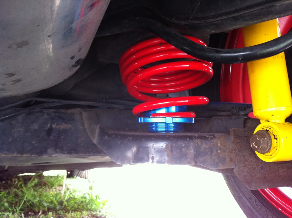

I've bought some v maxx coilovers and fitted them the other day! (fitted correctly)
I have had to adjust the o/s/r about 3/4 of an inch higher than the n/s/r (which is quite abit) and it still sits a few mm lower :S

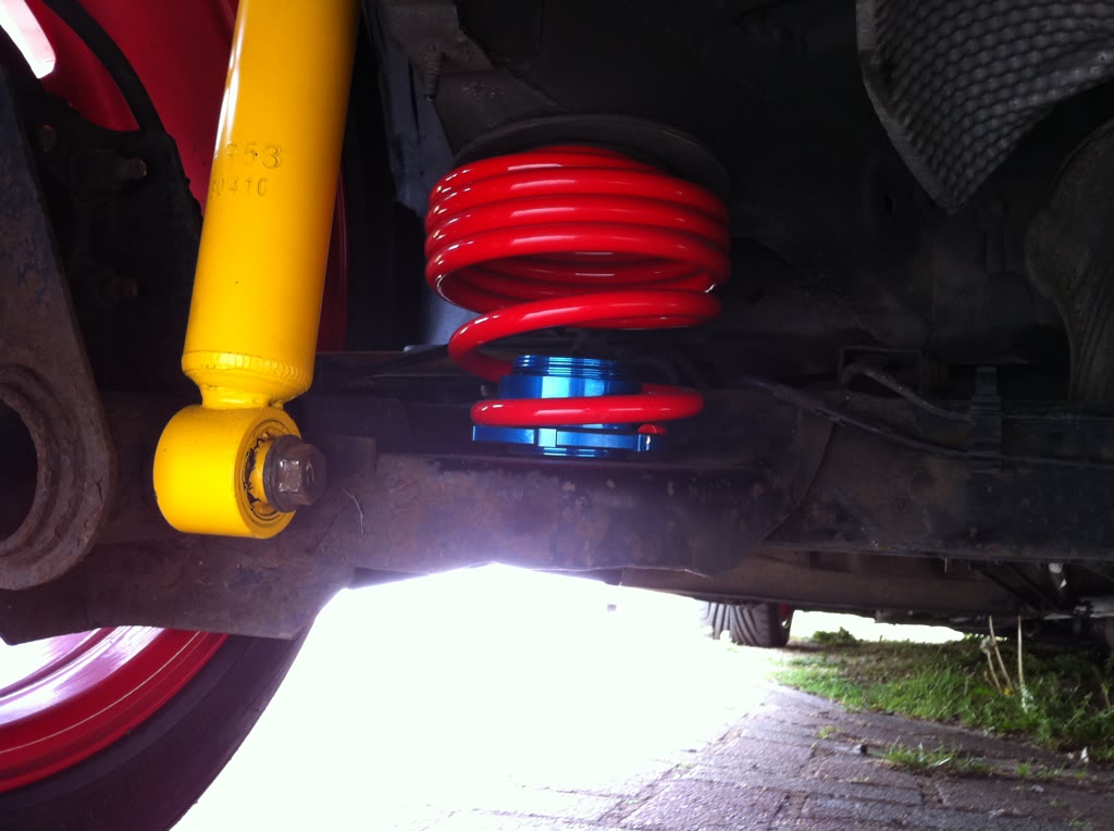

There's definitely LOTS more threads showing underneath the o/s/r springs seat than n/s spring seat but like I say I'll get underneath tomoro and measure how many I have either side and the distance between center of the wheel and arch

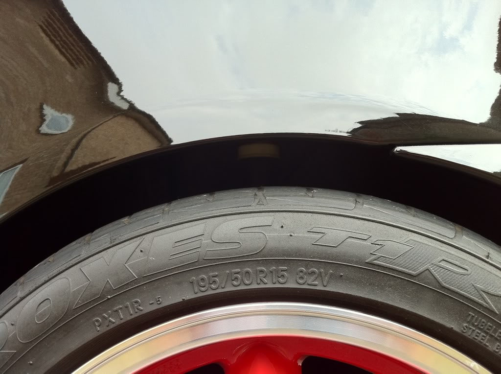

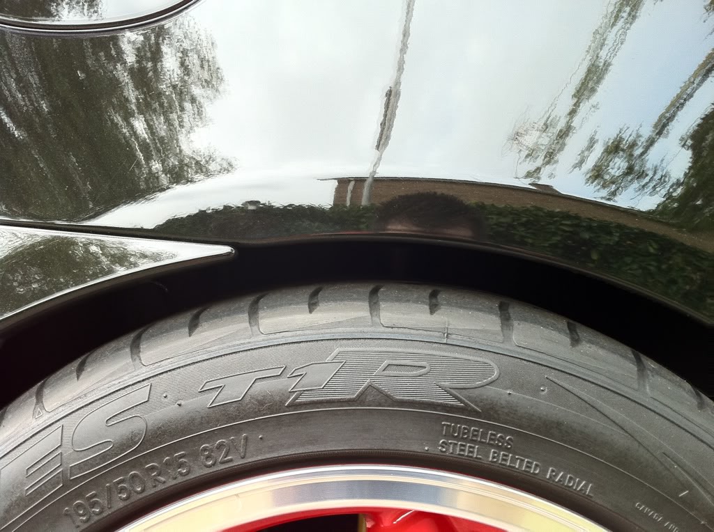

just been out and measured it all o/s/r is 306mm and n/s/r is 311mm
o/s/r adjuster
n/s/r adjuster
o/s/r arch gap
n/s/r arch gap

the annoying thing is the arch gaps could be down to unlevel ground. which is why its a ball ache to do.
