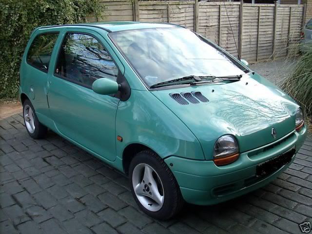

it started with an advert on Ebay

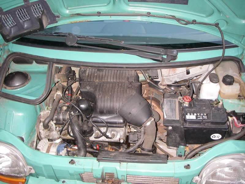

I bought it and drove it around for a couple of week with the 1.2L engine

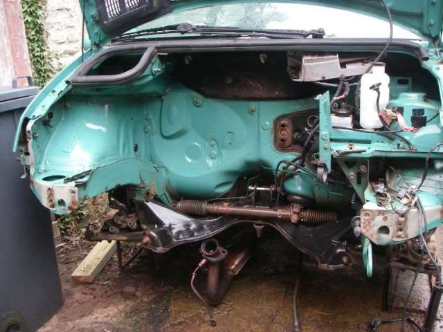

I'd bought it with the intention of fitting a clio sport engine, so unbolted the front panel and removed the engine

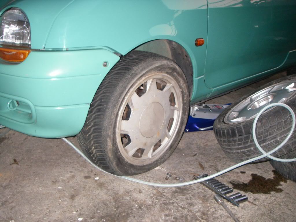

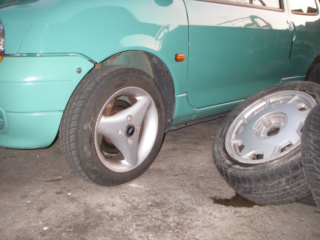

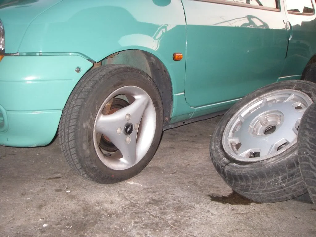

Before starting on the engine I had a bit of a play with wheels, although the 13" 3 spokes offered something that money can't buy...
I wanted to use 172 brakes, so they had to go. I bought some R19 turbines

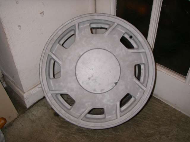

I like the look, but not the grey crinkle finish. Dropped into the grit blaster at work.

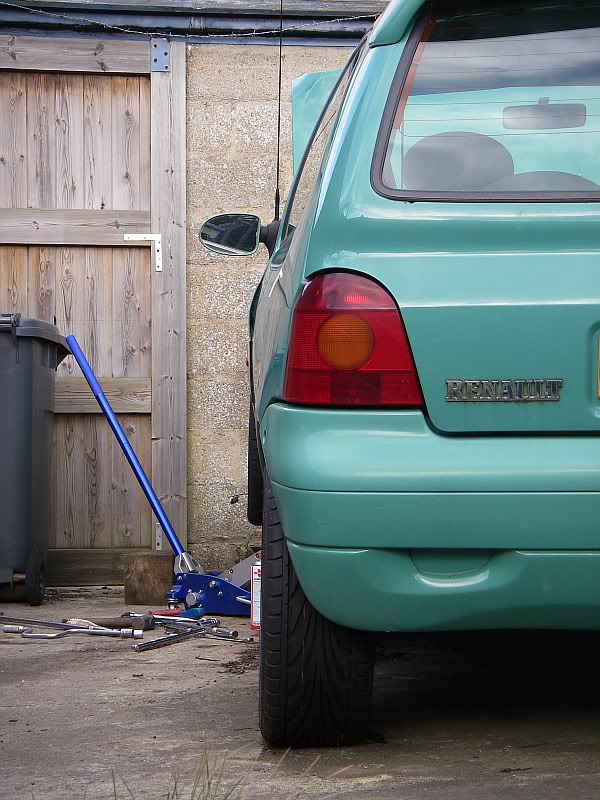

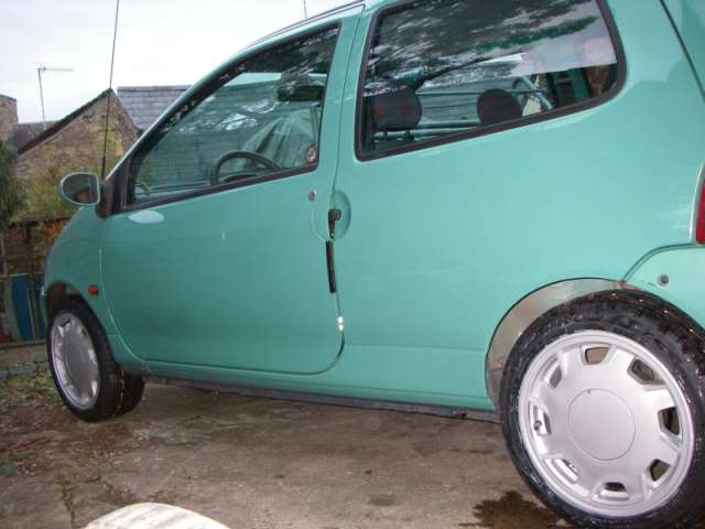

painted them up and refitted with 195/45/15s
nice and subtle to go in with the Q car theme :D

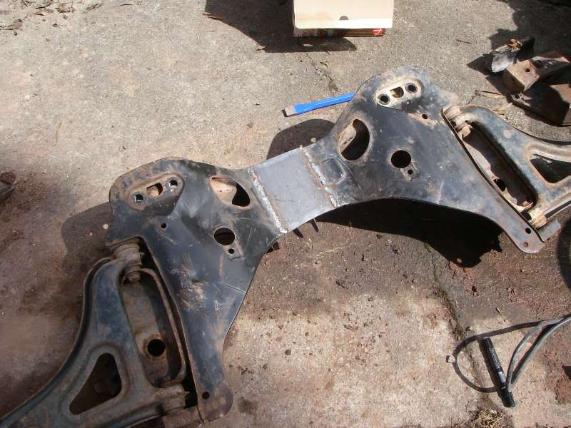

From the Twingo I'd use a modified front subframe and rear beam modified to use disks. Wishbones and steering rack.

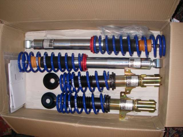

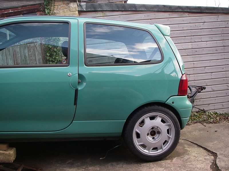

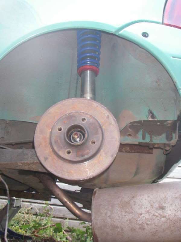

First major purchase was a set of H+R coilovers
Then did the relatively simple job of drilling and tapping the rear beam to fit the 172 disks. Taking the opportunity to slip in some shim for a bit of ghetto camber..

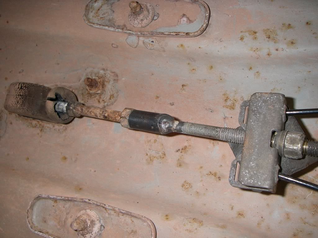

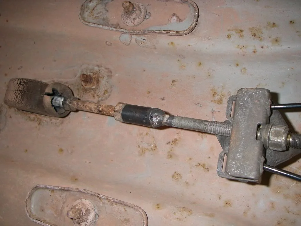

strangely, although the Twingo is a fair bit shorter than the Clio I had to make an extension for the handbrake linkage.

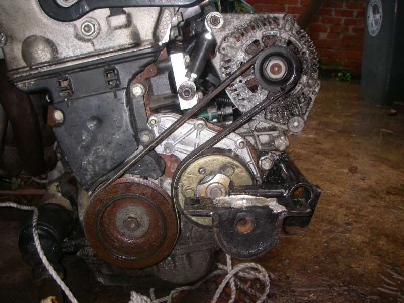

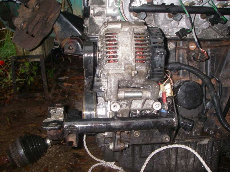

The standard alternator hung out the front of the bumper, so I lashed up an alternator mount, tensioner, and front engine mount that cleared the front panel.

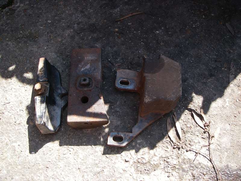

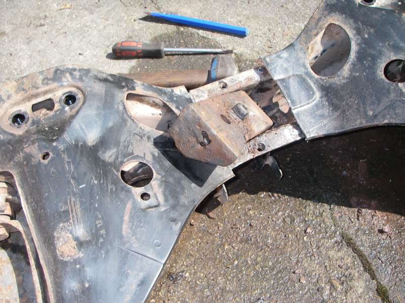

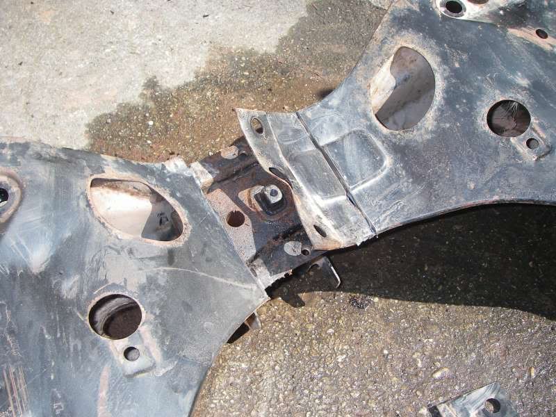

You may have noticed that the standard rear mount was above the subframe, I wanted the exhaust to go through that gap, so cut it off and welded one underneath, losing some 'ballast' along the way.

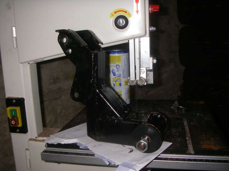

I seem to be missing a pic of the new mount welded on, but I do have one showing the part I made to bolt onto the gearbox.
and the 'ballast'

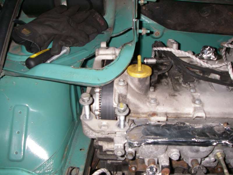

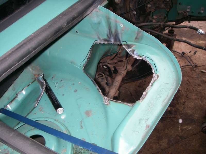

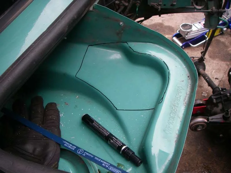

As you can imagine, it's all a bit snug up front in the Twingo, so having sorted out the mounts I needed to do cut and shut on the heater intake to miss the cam cover. I still want a heater as this will be a daily driver, so just cutting the box off wasn't a possibility. I don't have a specific pic of where it's at now, but it can be seen in later pics. Just some shots of space being made.

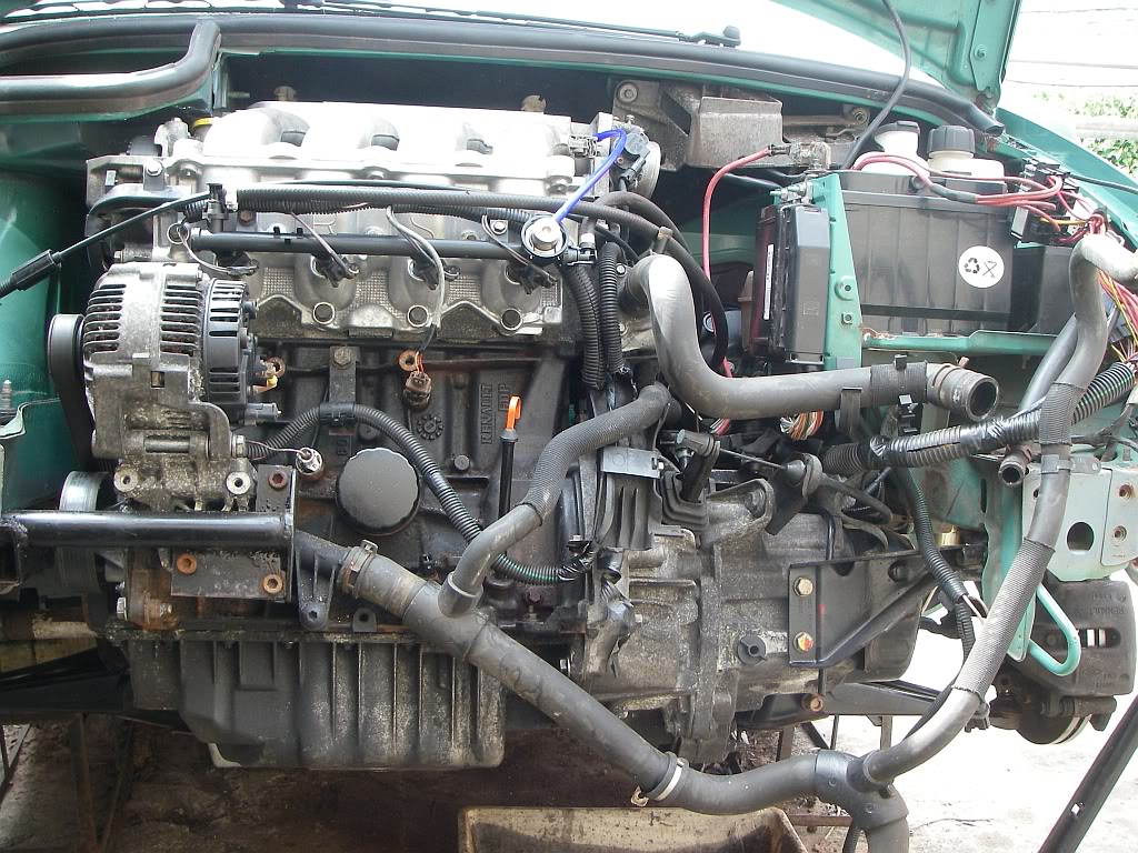

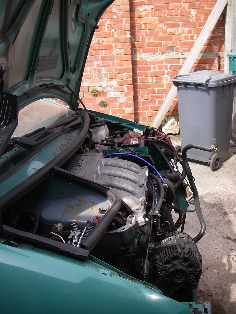

Anyway, it kinda fits..
and runs
