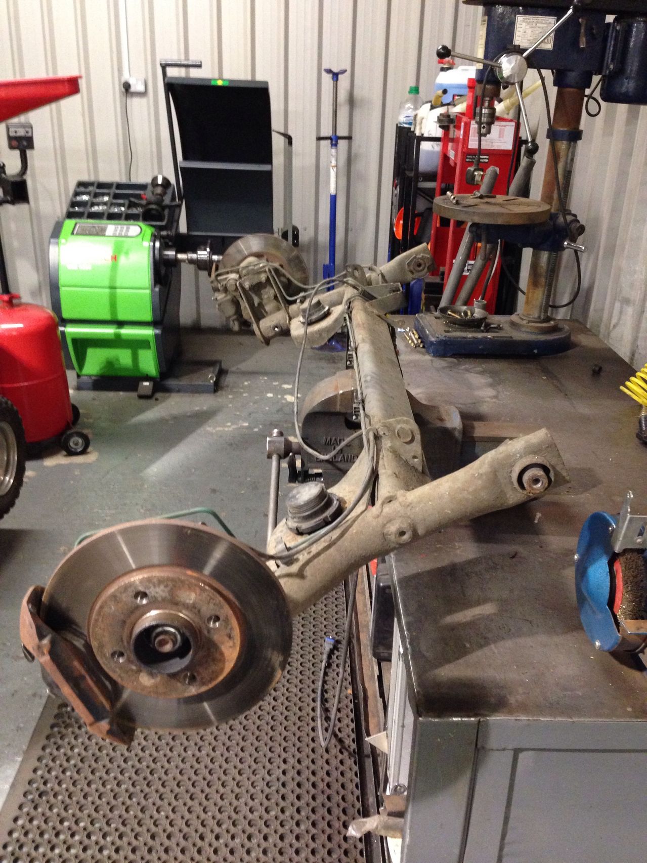

Rear axle bearings, not too taxing but does take a little time

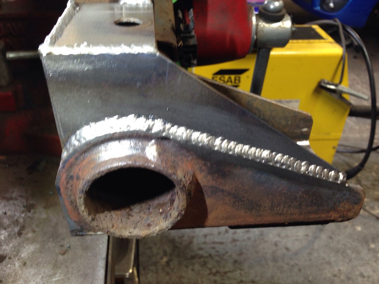

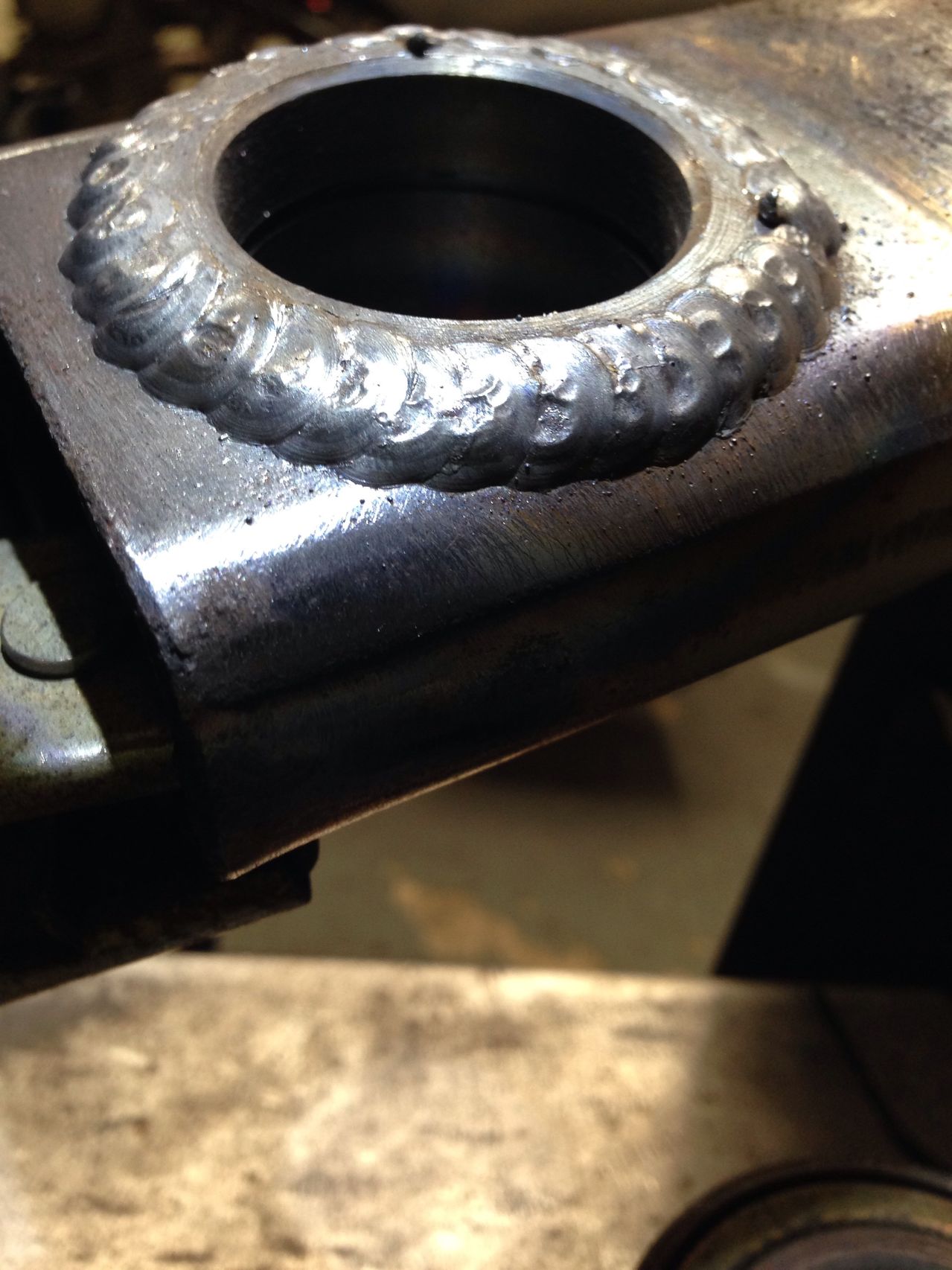

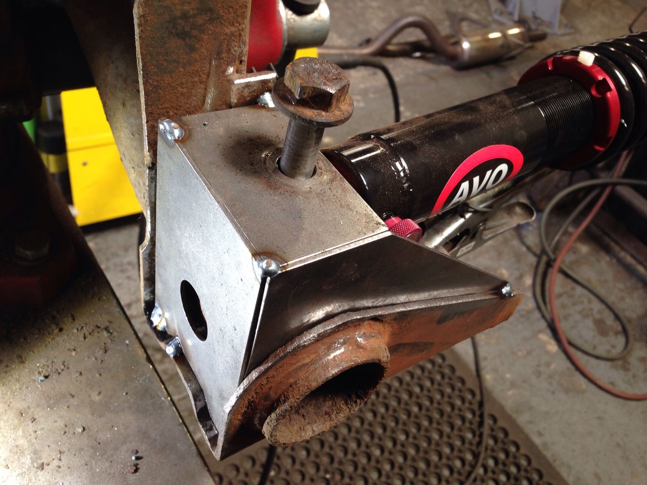

next was bracing the rear damper mount ready to accept the Rear coilovers
Gave them a quick spray of primer, whole beam is to be powder coated at a later date after I have fitted some stiffening plates.

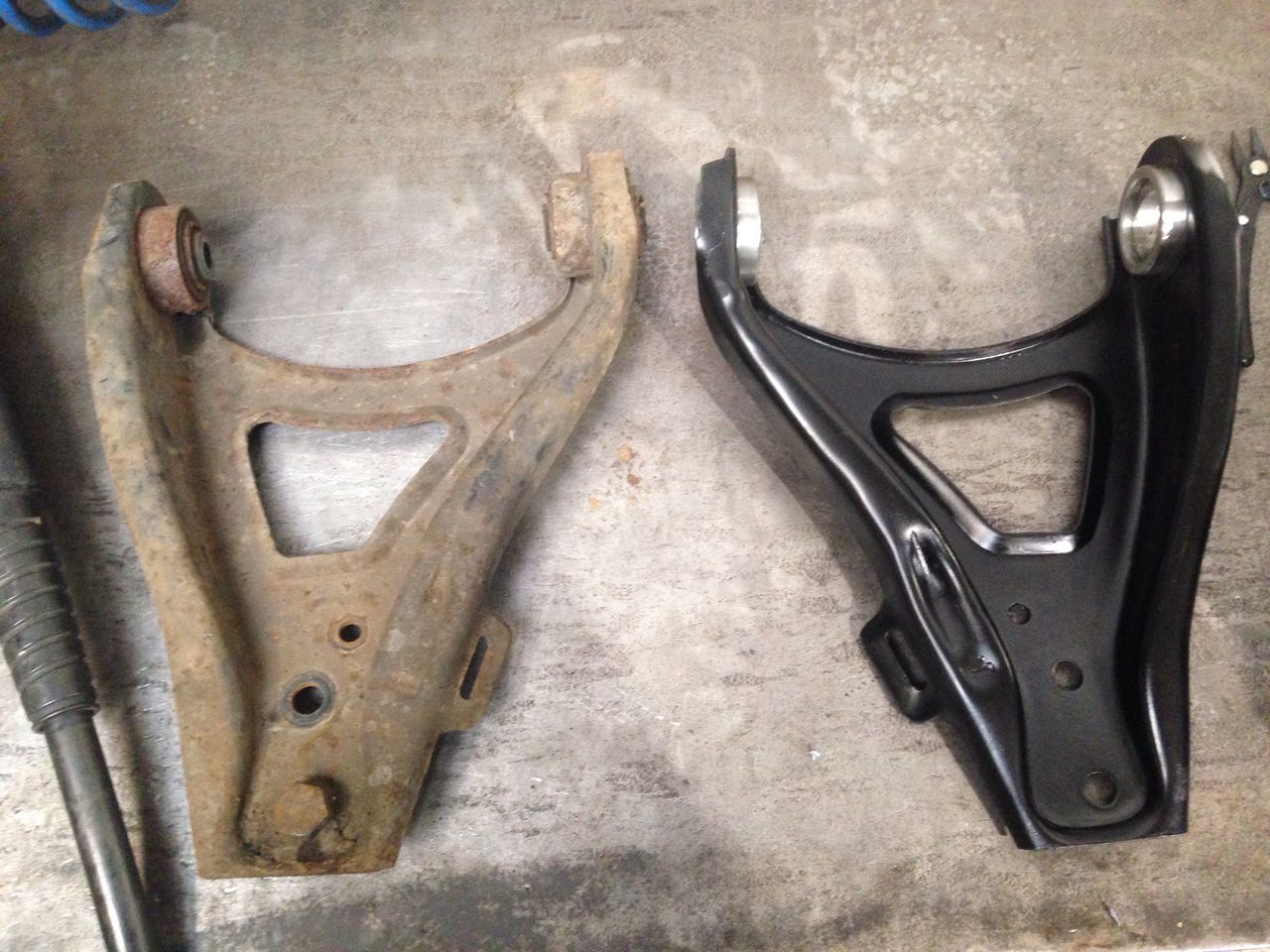

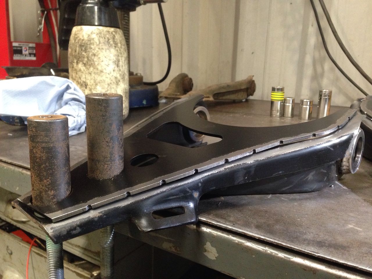

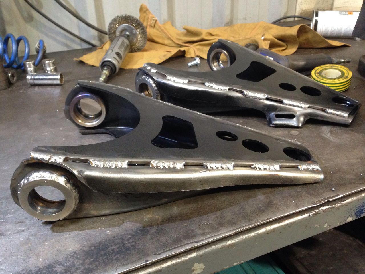

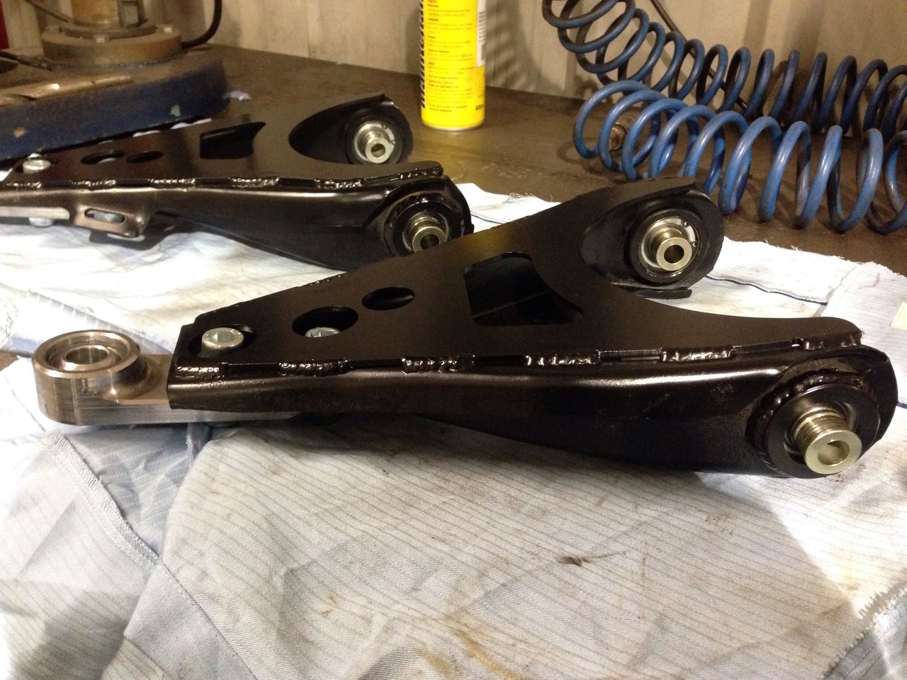

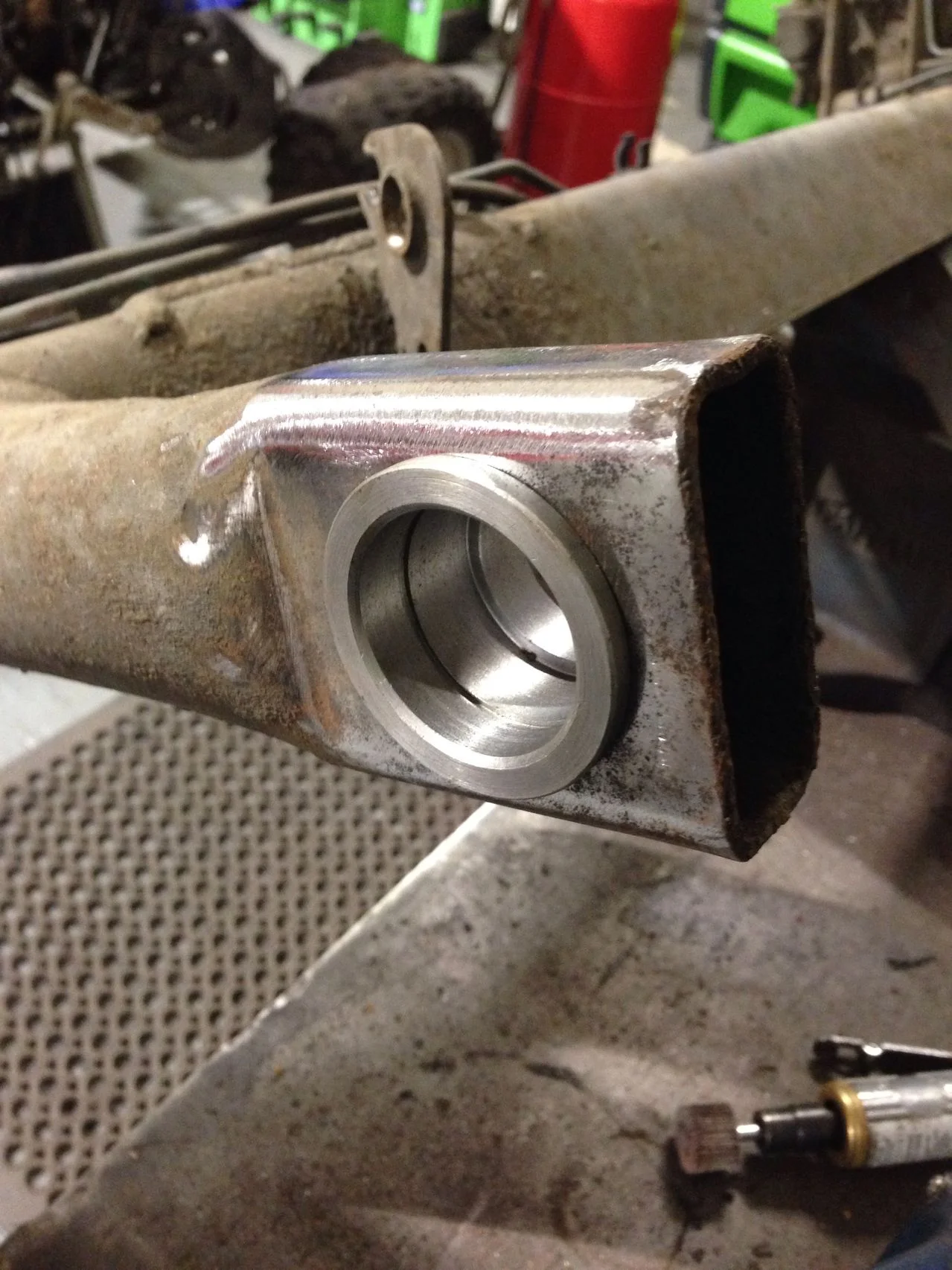

Lower arms was the next task,
Little before and after, took a while grinding all the crap off but came up pretty decent.

Then spent what seemed like an age cleaning and painting the hubs and few other bits, used some VHT engine enamel so should hold up pretty well

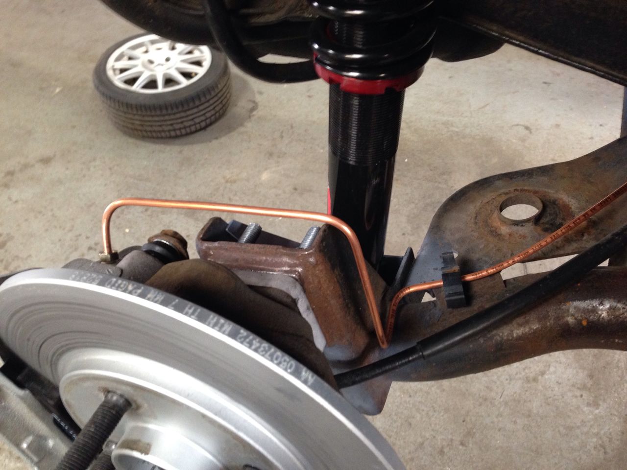

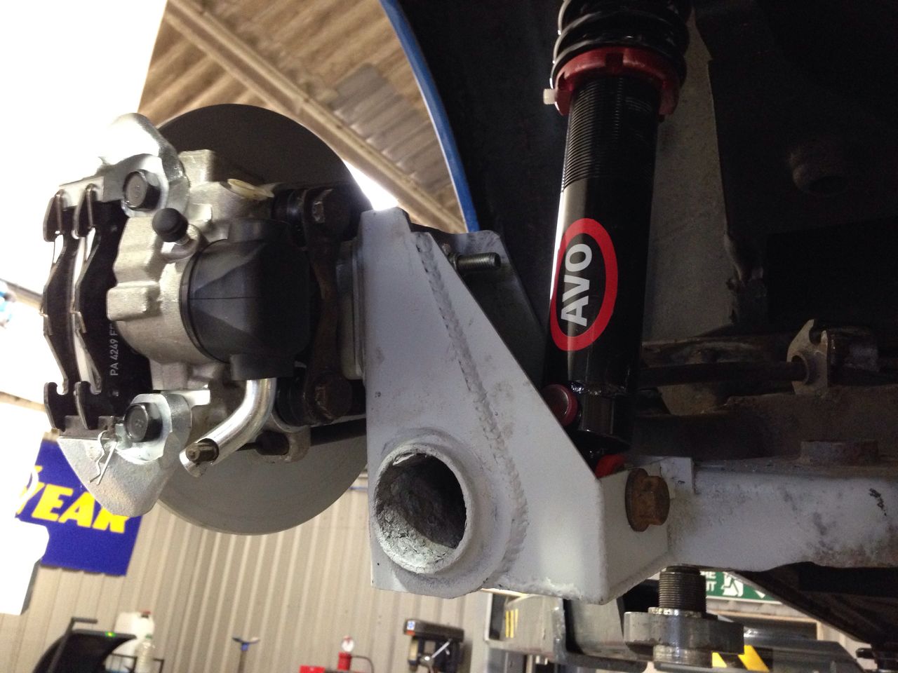

Have now fitted a set of AVO gtx, new calipers, some braided lines,had to make up some new rear pipes.
just trying to chuck it all back together at the mo track day is booked for next weekend, still have the exhaust to sort out, set the suspension up, and bleed the brakes, will keep this updated any suggestions or worthwhile mods please let me know. Rear anti roll bar?

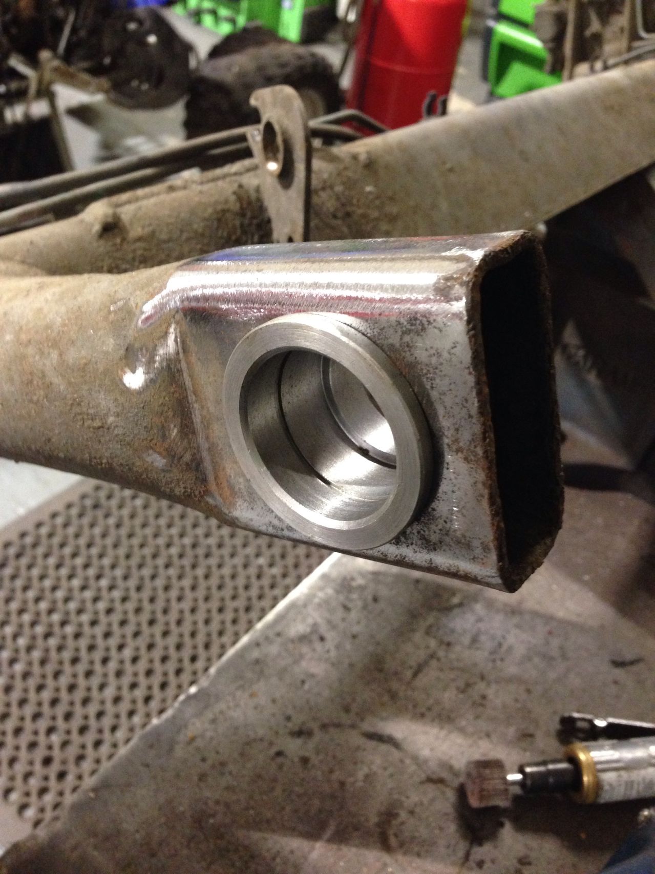

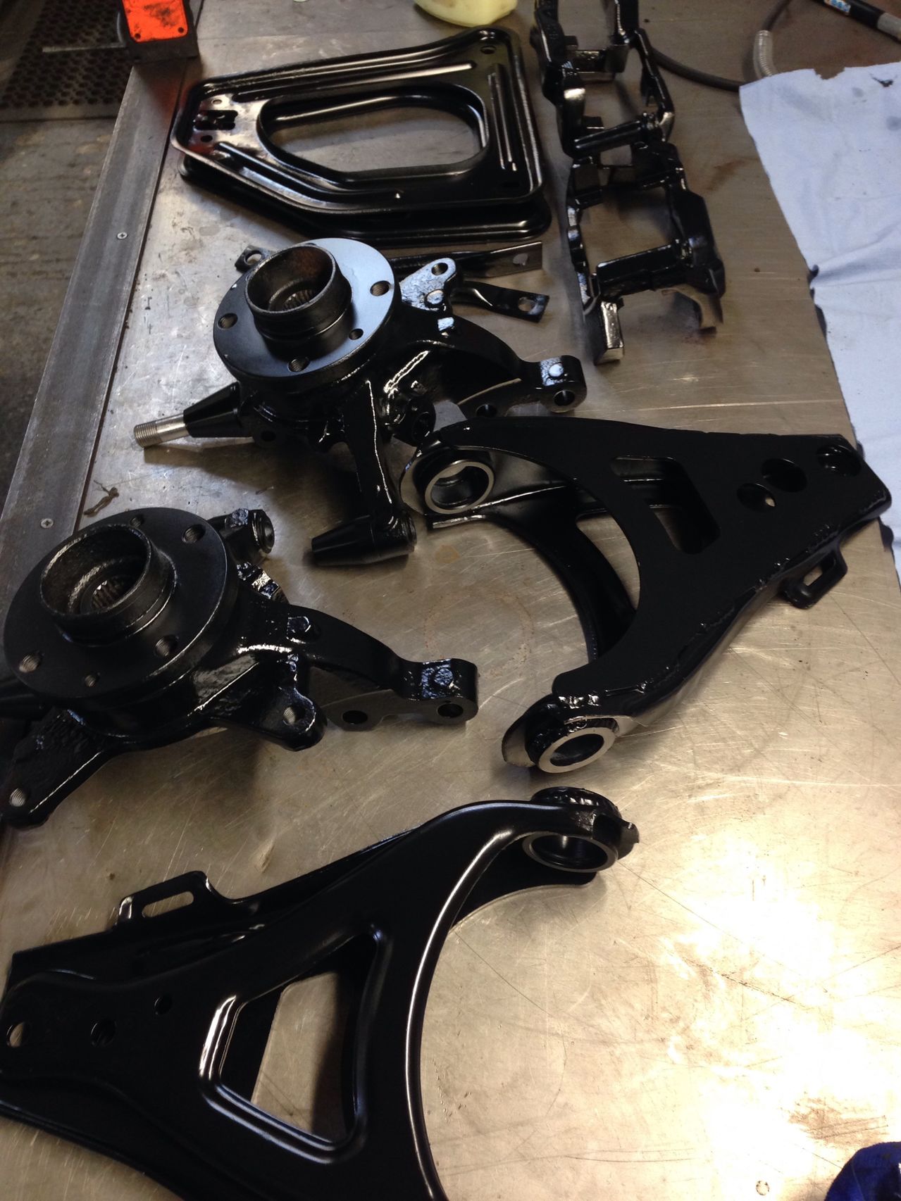

Got the RCA kit from a group buy good piece of kit,
