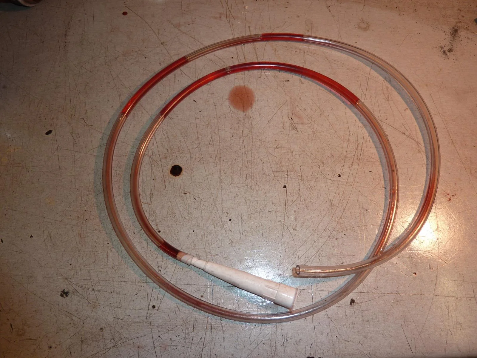

One of the jobs I have been meaning to do on my 182 was to change the power steering fluid. I looked at the pipes beneath the car but the unions were difficult to get at so I looked for an alternative method.
What I did was to use the nozzle off a tube of silicon and a length of plastic tubing. (see the picture below) Make sure its a new nozzle and everything is clean. First I removed the cap and then the filter from the Power Steering reservoir, this just pulls out. (insert your fingers (ooo er!) and lift it out)
Put the end of the tubing (the one without the nozzle) into a container to catch the oil. With the car running on tick over I then inserted the tube with the nozzle attached into the reservoir to the bottom and held it there so it covers the return oil supply hole, which is in the bottom of the reservoir. The return supply hole is slightly raised so its easy to locate the nozzle as its a lot bigger than the return hole. As soon as you do this, the oil will be forced quite quickly into the pipe and start to fill the container.
As its starts to fill the container, top up the reservior with the new Power Steering oil to ensure the pump does not run dry. It takes 1.1 liter to change it completely but as i had 2 liter, I continue until 1.5 litr had been used to ensure it had a good flushing.
I know its not a serviceable Item, but it cant hurt changing oil that been in use for 0000's of miles... with fresh oil.

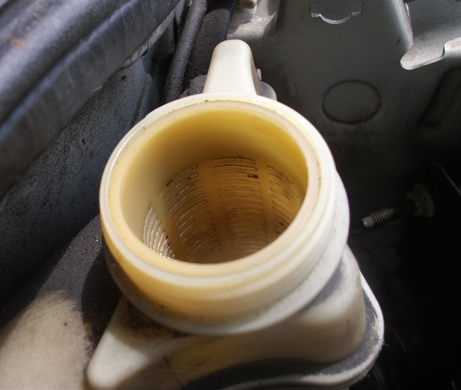

SOrry to resurrect an old thread but in my 2001 clio I take off the cap and inside is an inner bit of plastic with little slit holes around it and 2 bits of plastic sticking up from the bottom (not very deep) Is this the filter? I cannot remove it at all, with fingers or clean pliers :( Or am I wrong?
  2001 Clio Sport 16v
It's like its molded in there, wont budge. Screwdriver just bends the plastic about if inserting through the little slots :/ Heres a pic:
A bit dirty...
Ignore, I've done it. just needed to pull abit harder with pliers lol

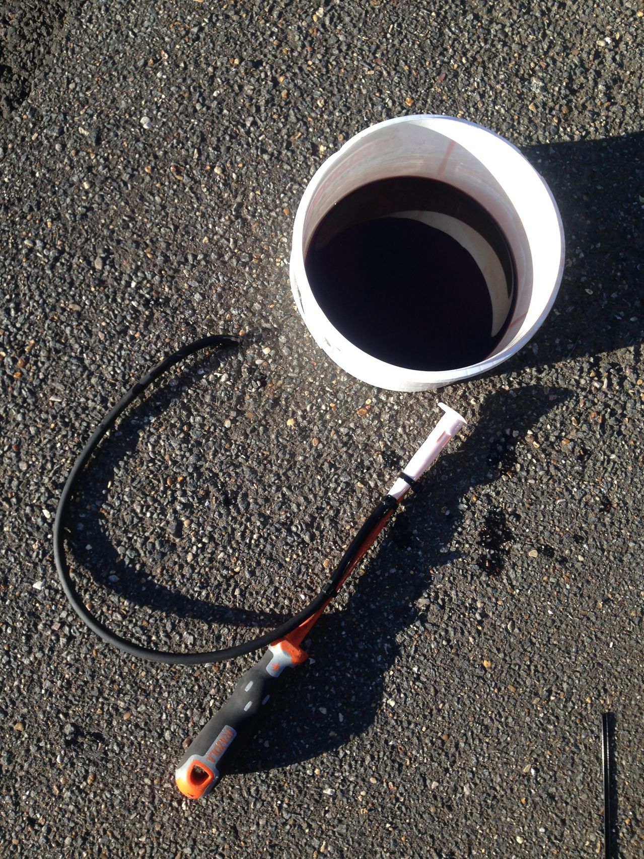

As he said, I made the same mistake trying to do it on my own. This is an excellent method though. I used the rubber hose for the windscreen washers (off a spare bonnet)
Also tape or cable ties the hose attachment to a screwdriver to make sure you can grip it easily, see my picture
