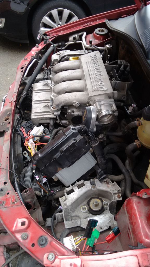

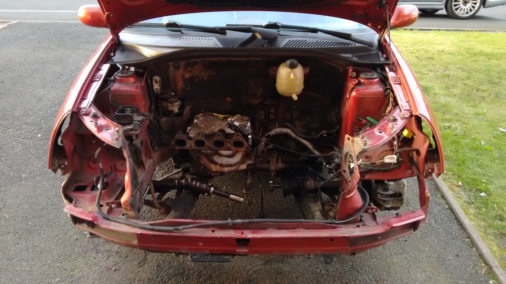

Not looking forward to ripping all this out

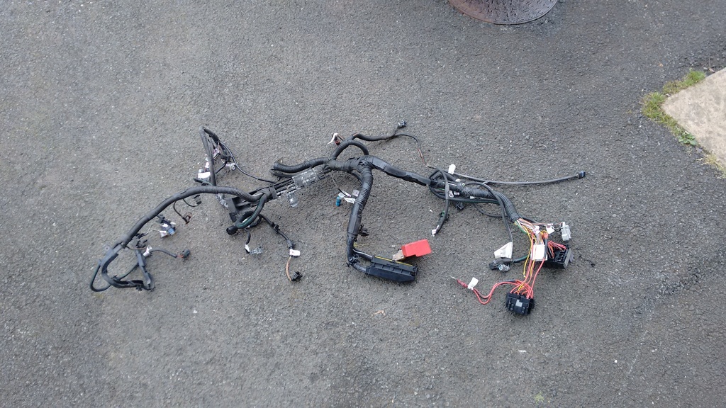

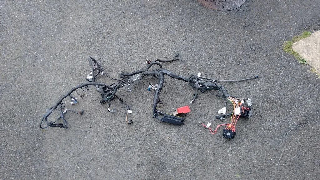

Too many wire's
Only got an hour on it and the heavens opened so had to call it a day, managed to remove the front end, disconnected the loom, all the little vacuum's ect. Soon as the rain stops drain water remove rads and pipe work, I'll call it a day then, tomorrow disconnect gear linkage, clutch cable and manifold. Jack it up pull shafts out the box but leave in hubs so I can still move it if I need to.should then be ready to pull out, I'll leave it til one of my friends can help me as I've had a few engines swing in the past and scratch paint ect. End of the week I'll hopefully have a fair bit done

Ok, I managed to get an hour on it today and think it ready to lift. Just going to give it a final check and get it out tomorrow morning weather permitting. I can't wait to get the box off and see if I can identify the problem, then it'll be time to get my ocd working and tidy the engine and bay up, lots of oil spray everywhere.

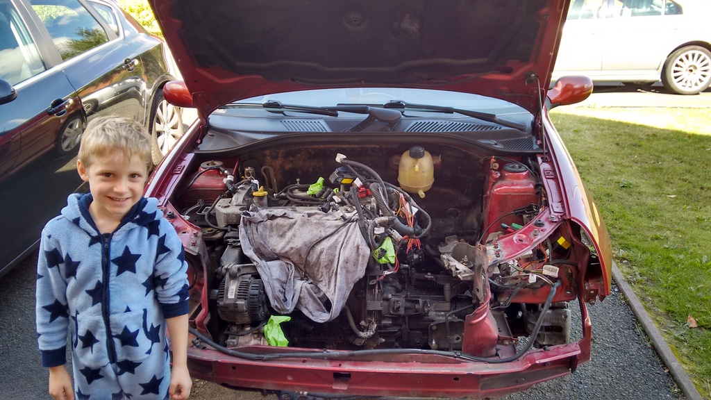

Fingers crossed that's everything and I can lift it out tomorrow, pic of my little pest........ I mean helper.

Thanks guys, its all going really well and the cars a pleasure to work on. I have had no rounded off bolts, no stubborn bolts and everything has been pretty straight forward. Only spent about 3 hours on it and its ready to come out, I think that's pretty good going for my first attempt. Let's hope the weathers nice in the morning.

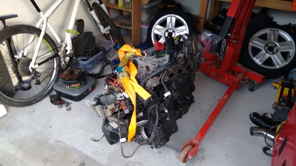

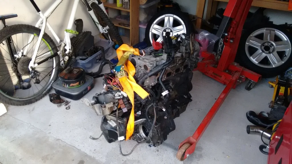

Ok so I managed to get the engine out. I had left it so it was ready to lift, so with a spare Saturday afternoon thought I'd take it out............. ERM, it wasn't ready to lift. After attempt after attempt, it wasn't coming out. Body kept lifting, I was checking everywhere and it was clear. Then it clicked, I had left the dog bone attached, what a dick! Then had trouble with the diff clearing the manifold. But its out now, just caused myself a little bit more work and money. Well at least it's out :)

Cheers guys, hopefully get the box off today And get to the bottom of my problem.
In two minds whether to just fix the problem and bang it all back in or, fix problem, put new belt and dephaser and get my ocd side out and clean engine up, lick of paint ect.

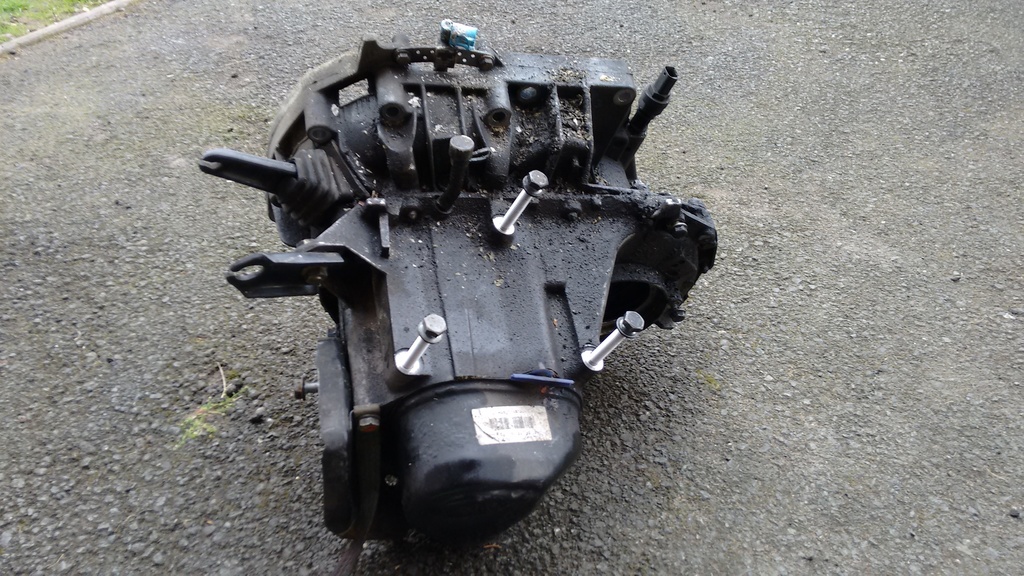

Normally like to spend Sundays chilling, well yeah I still did but i did go in the garage for half hour and remove loom, gearbox and clutch.
Then I found this

I've been busy and with a trip to lego land this weekend, means funds and time are tied up. All I've managed to do is get the car back on its wheels, tidy my garage and get the engine on an stand.

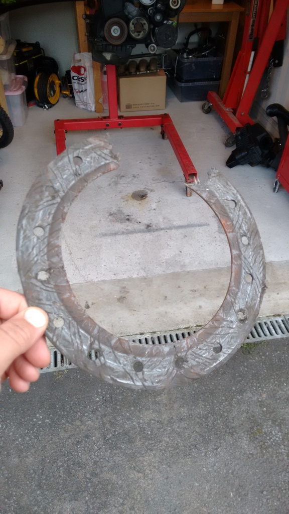

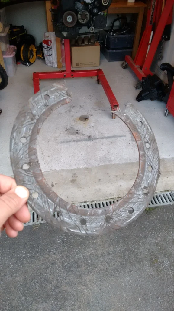

Since having the engine out, found it needs a clutch, cam cover gasket and sump gasket (I have some loctite seal for the sump).Also while its out I'm going to do the cam belt and paint the engine up so its nice and pretty haha.
Being as my video doesn't seem to work, here is a picture of my clutch.
Think I've found my problem.

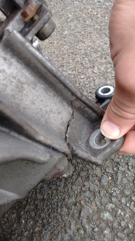

Also, this was broken which I found strange

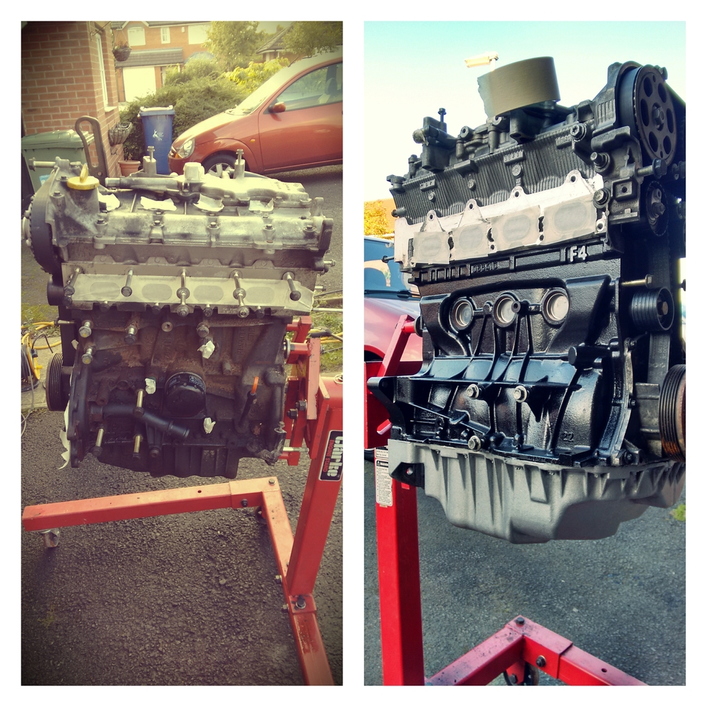

Tiny update, not had much spare cash so just been tidying up and making the engine look fresh again.
Got my lads birthday this weekend, but hopefully weekend after I should have cam belt kit and aux belt kit along with a load of other bits.

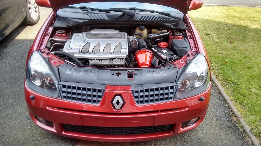

Pic of before and after

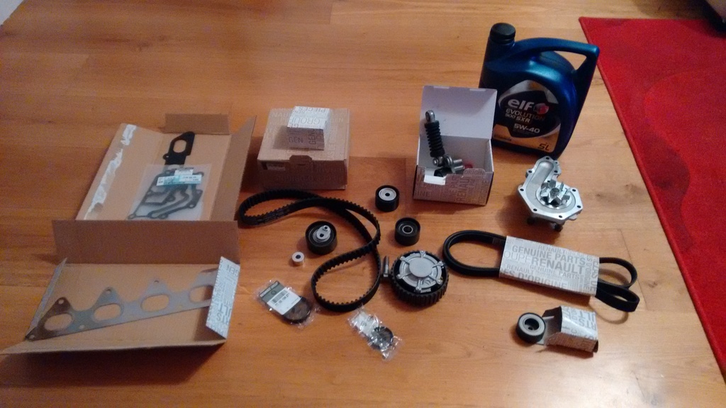

OK so now I can crack on, thanks to Renault parts direct.
@not normal dan is coming round this week to fit the cam belt, really looking forward to getting all this done. Been waiting along time due to circumstances. Be a good feeling once it's finished, one knowing its all done and should be good for a few thousand miles, and that I've done it all by myself..... Bar the cam belt, thanks Dan. Saying that if I had the tooling I would give it a go.

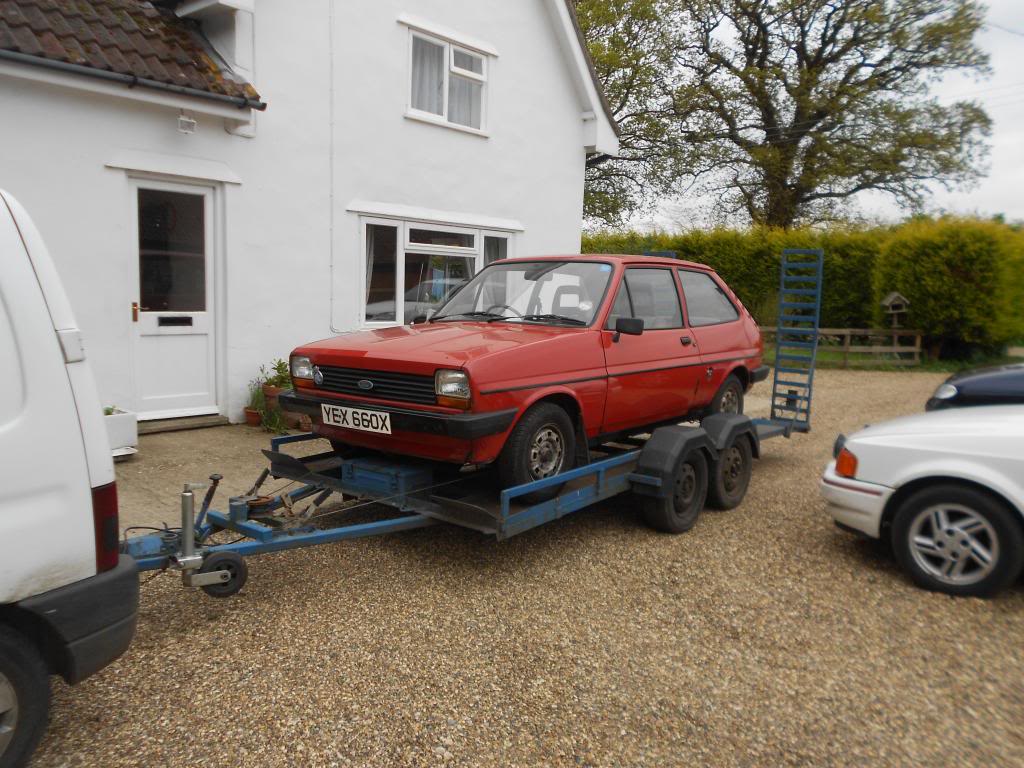

Yeah it did look fairly solid when I first got it but I've done outter wings, repaired the inner wings and kick panels, new front panel, repaired boot floor and inner and outter rear arches as well at the rear of the sills so far 😂
No mate xr wasn't mine it was my dad's, he's had a a fair few old fords over the years, now only owning a mk2 rs2000.
But I've got to agree every things on the ford scene is soo expensive.
