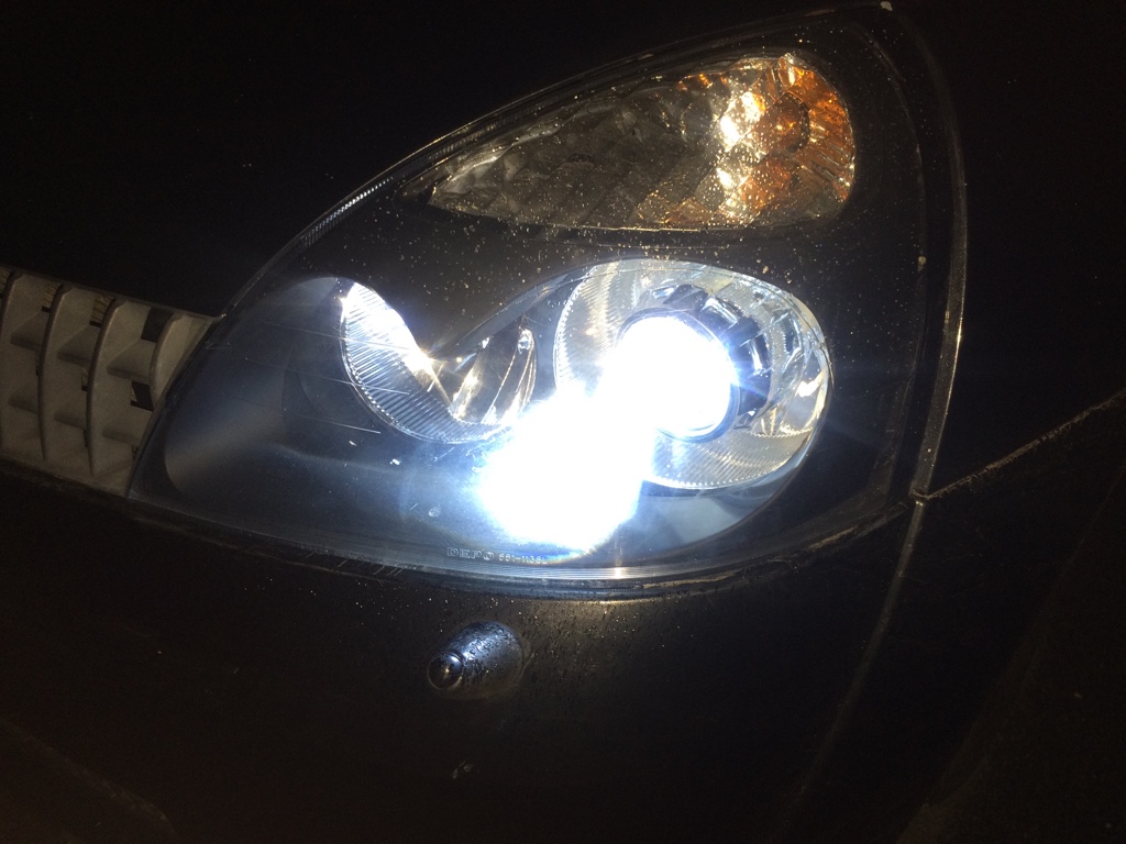

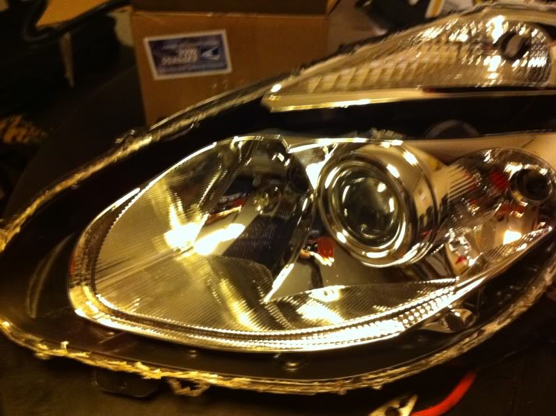

projector bi-xenon clio. I'd quite like to get into it as I've always wanted bi-xenons and thought I could get this http://www.theretrofitsource.com/co...morimoto-sealed7-headlights.html#.VDe9dYCwIki fully sealed with the right wire harnesses for the 5 but I'm not sure if it would all be too complicated for me.
  Mx5
some people are really good at it though but yeah it can involve ovening and splitting headlights open then a lot of cutting and epoxy

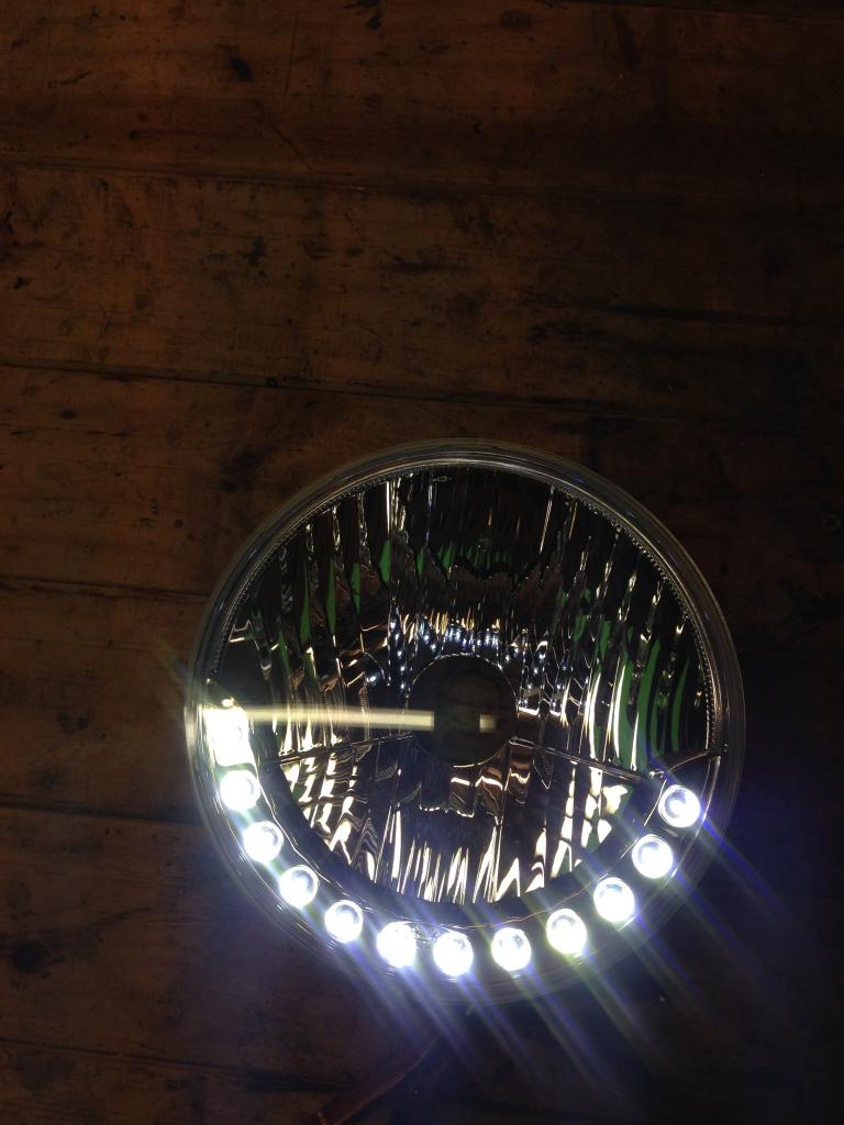

Had to use a dremel to cut the lens as the lens started to melt before the glue. lol

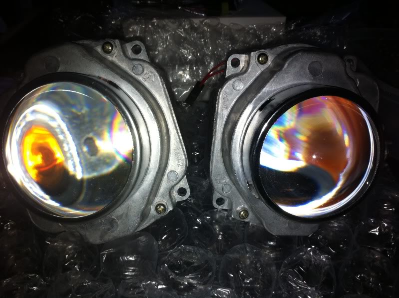

Was going to be fitted with these but they are too big so got some smaller projectors coming.
Going to be fitted with Osram CBI bulbs. I'll make sure there are some before and after pics of the output.

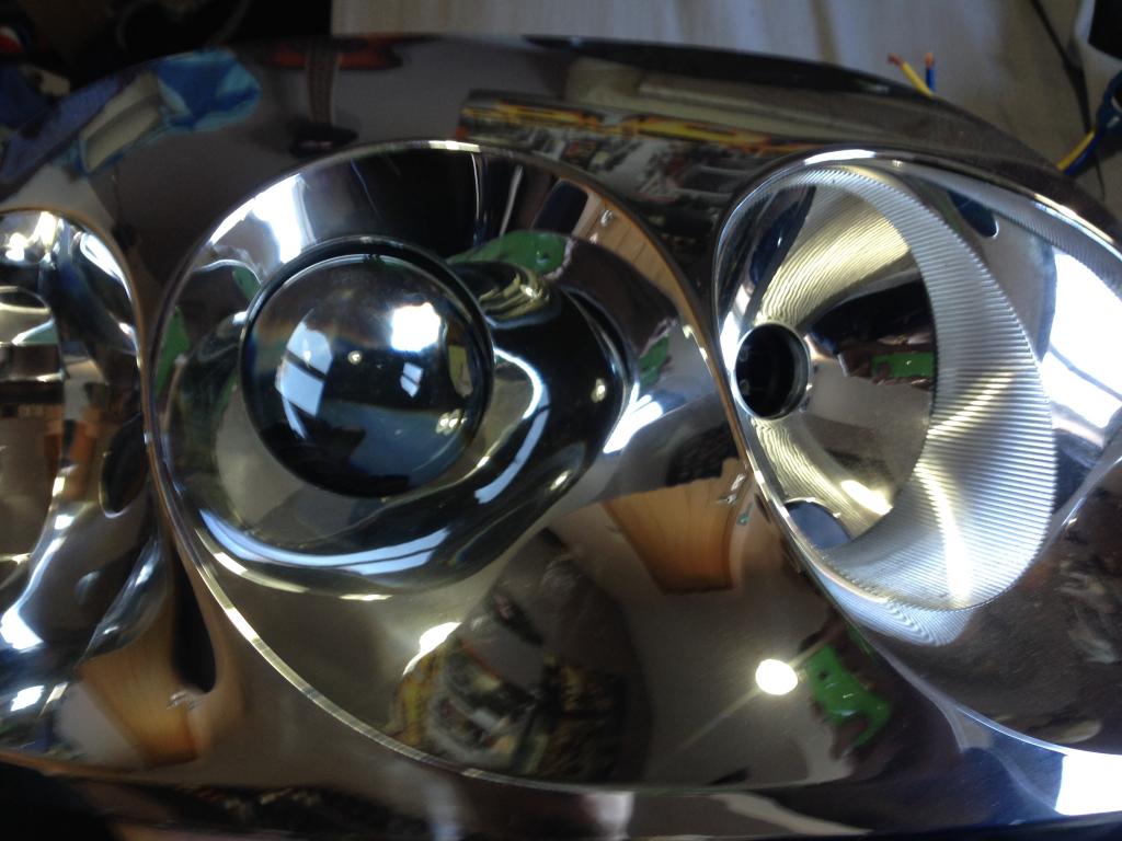

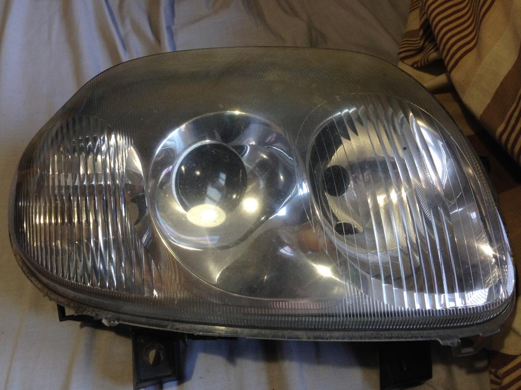

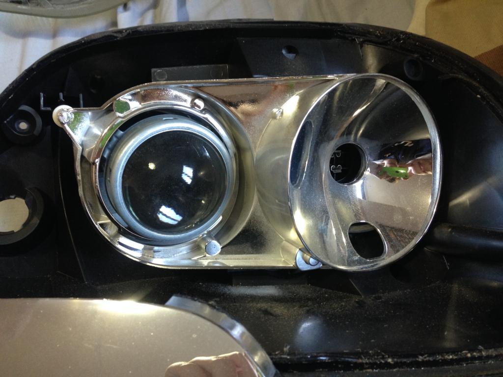

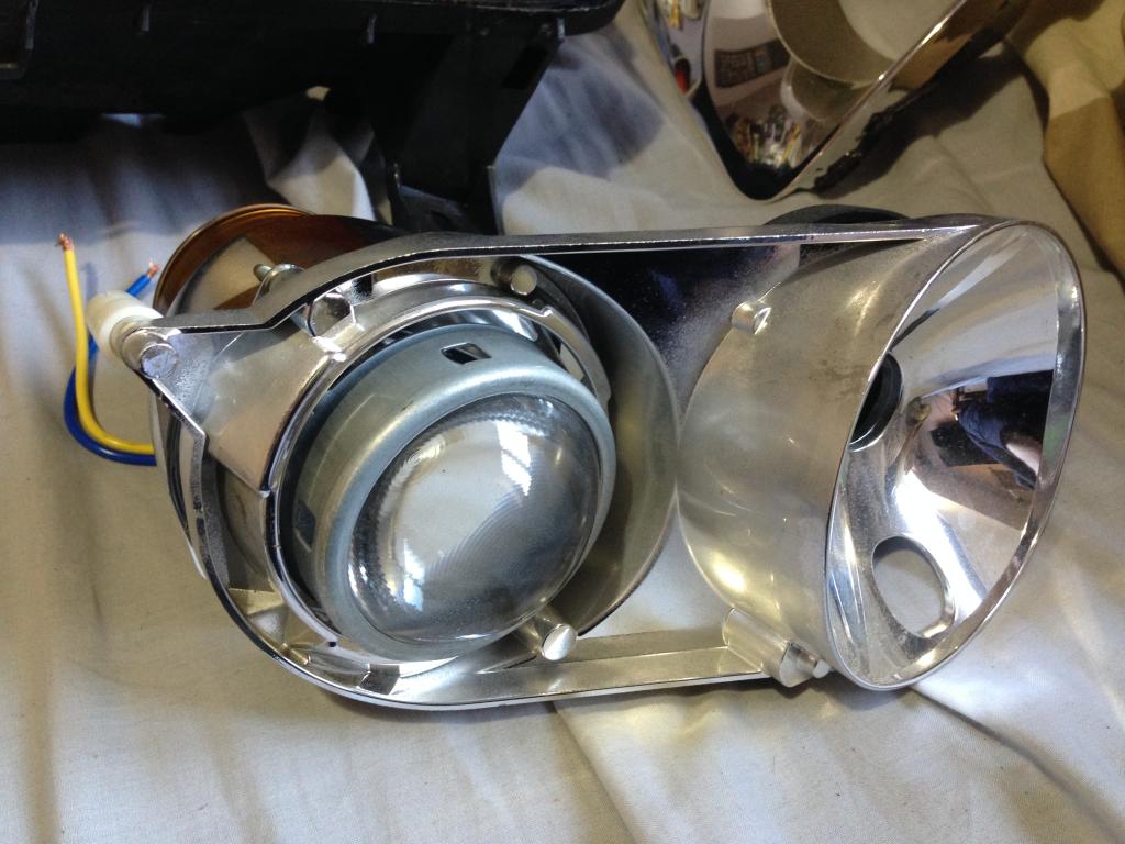

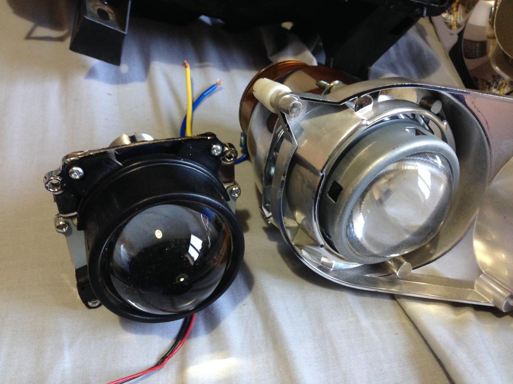

So for whoever it might interest I'm thinking @McGherkin I bought a set of bi-xenon projectors for my mx5 but before I put them in there I decided to strip down some old phase 1 dual optics I had
Actually came apart really easily and nicely.
Here's the low beams and the high beam without the lens and the shroud
It turned out that these headlights where f*cked, whoever owned them before had broken the adjusters then wedged it all back together with a piece of hose and decided that would be able to align them properly. Making these headlights useful no more :(
theres the halogen projector on its own
And next to the bixenon one
And the bixenon one behind the phase one shroud (with it's clear lens i think it looks even nicer)
so in conclusion I think a phase one would be extremely easy to put a bixenon projector in there and you can still use the halogen high beam making for some awesome headlights (if anyone trusts me to do it for them I would do it ;) )

It uses a proper oem d2s bulb but it is one of the cheapest and smallest projectors available without going into ebay projectors
I reckon the phase one headlights could quite easily accommodate the nicest largest bi xenons
Yeah it's a 12v circuit and just flips the shitter down. Although the relay harness that I got with it runs the hid bulb and switches the hi/lo without any splicing into your own cars wiring.

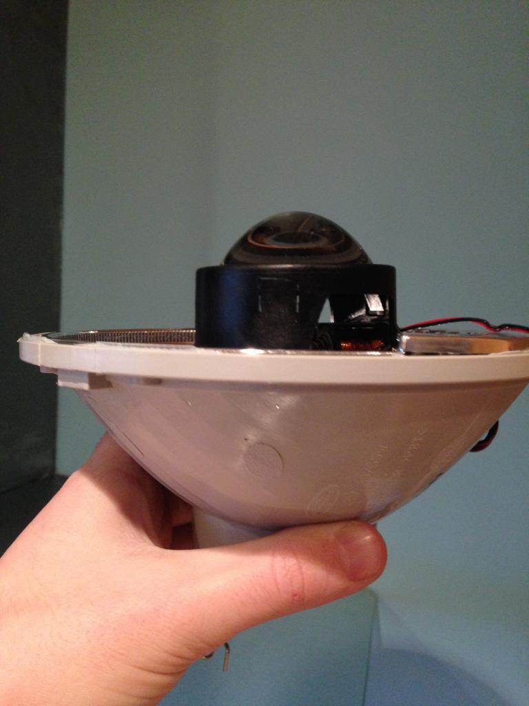

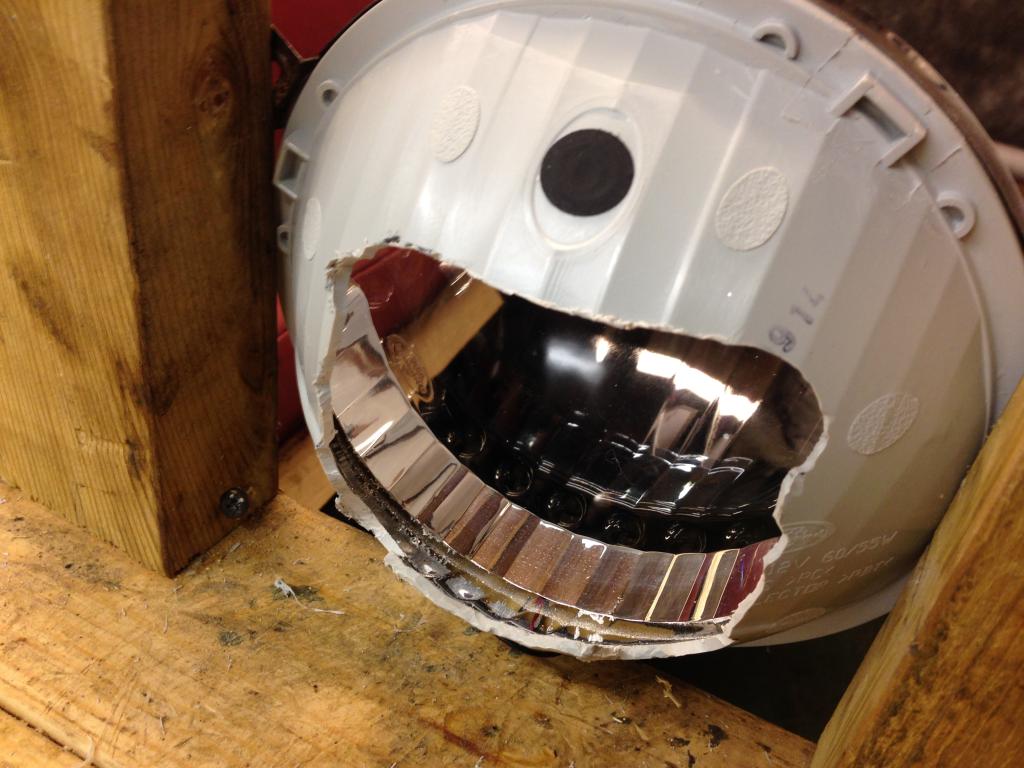

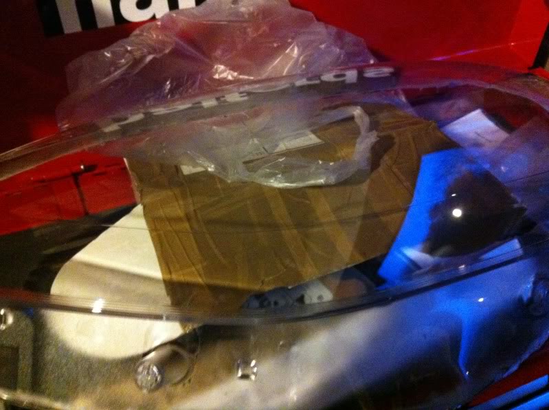

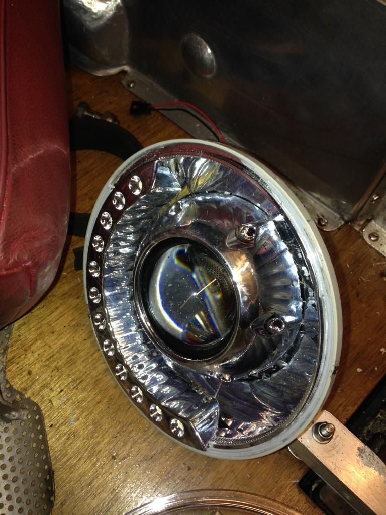

That's not going to seal back together :confused: so as I knew I had some cutting to do I decided to find some fully plastic headlights as my metal ones where blowing up a Dremel disc per mm
But this was actually harder than I thought it was either glass lens and metal body or glass lens and plastic body and a glass lens would likely break when taking apart.
Eventually I managed to find some on a landrover defender site which had the added benefit of having leds in

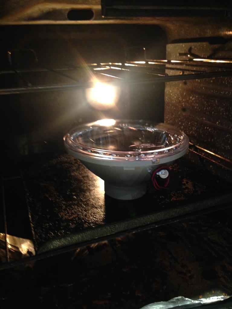

Then I ovened them apart luckily they came apart quite nicely
Then I marked the halogen cutoff on the wall and slowly and painfully (with bits of burning plastic and dust being flicked at me) started cutting untill I ended up with a hole big enough

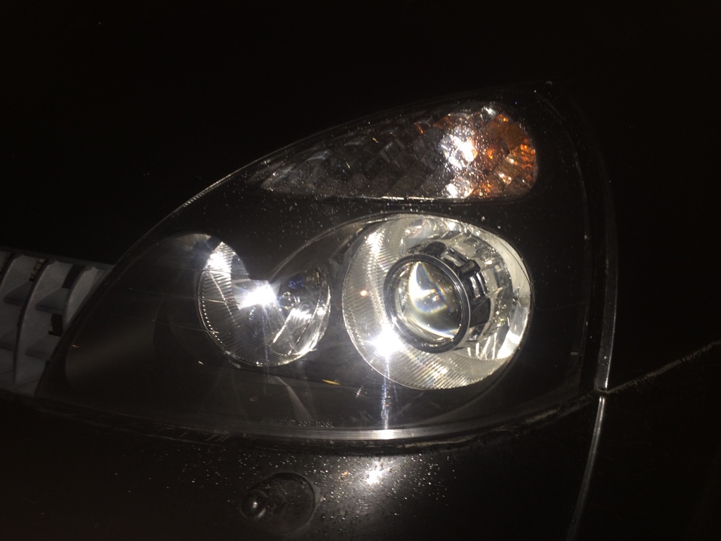

Then it was time to mount the projector, align and epoxy it in.

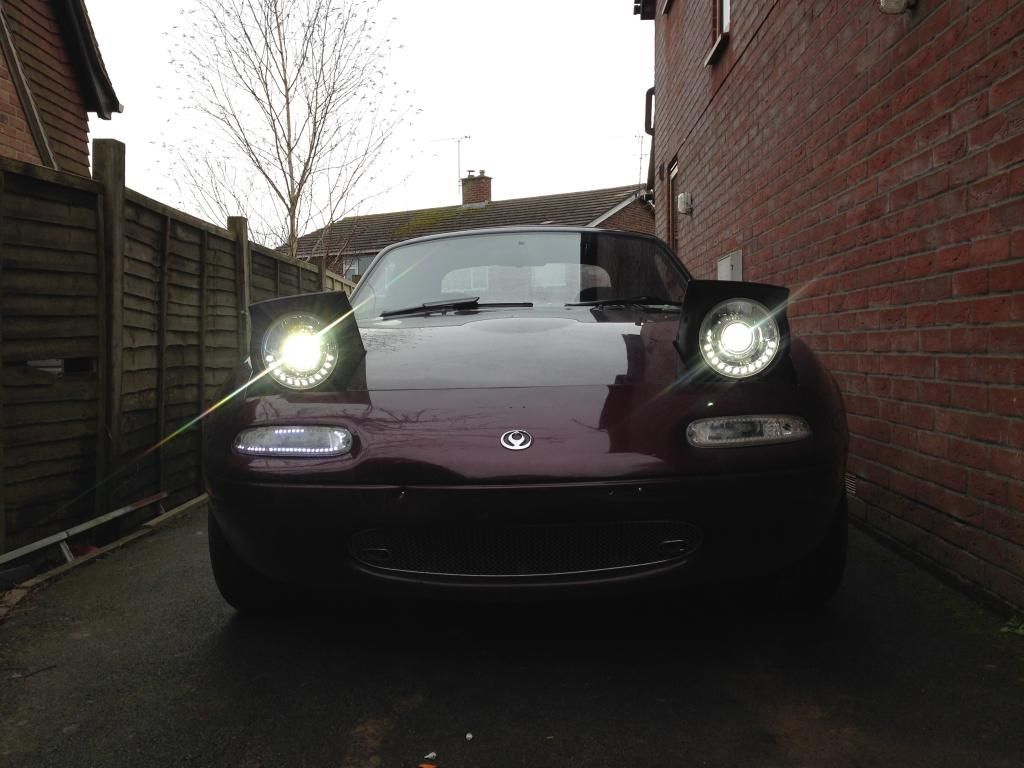

All mounted with the shroud
Then repeat for the other side wire it all in and voila

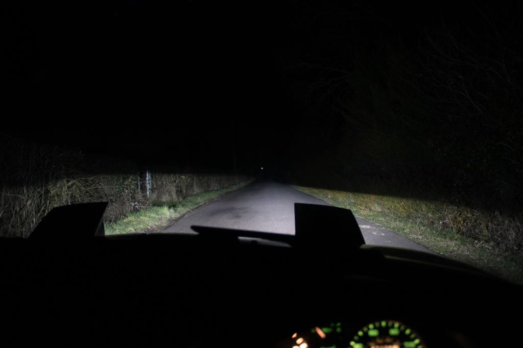

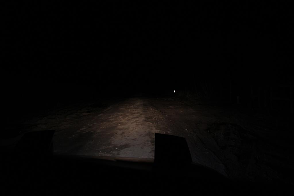

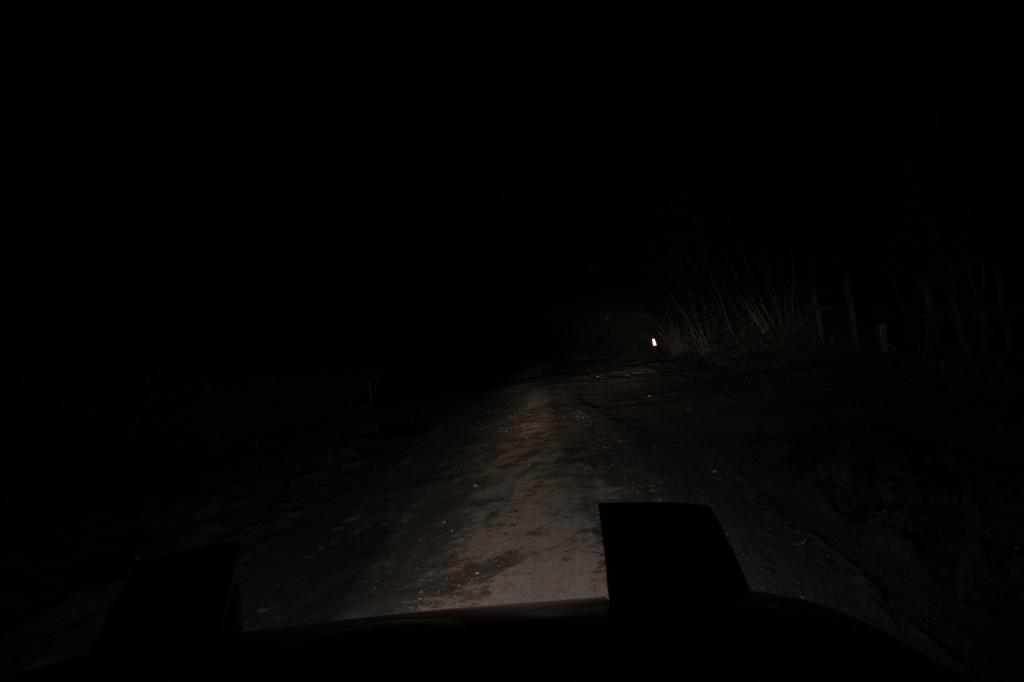

Now time for some output shots, I got my firends mk1 who has the standard Koito halogen lamps with osram night breaker unlimited and used my dslr with the same exposure setting for each picture.
His low beam

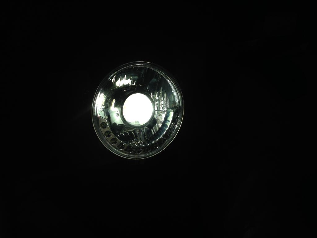

My low beam
His high beam (don't know why I went all slanted)
My high beam
From behind Halogen (low beam)
From behind hid (low beam)
Then I took some more down a different road from the driver seat
Low
High
