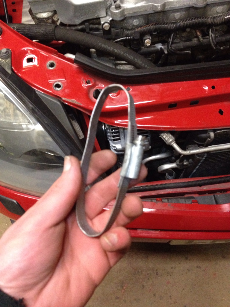

Anybody got any advise on taking the tension off the belt to change the alternator?
All alternator bolts slackened off no issues but now struggling. Got a 3/8th square drive tool on flat bar but cant get into tensioner.
Any advise or photos be greatly apprechiated

Big jubilee clip on the tensioner spring. Job done.
Keith185
Thanks @NorthloopCup , all sorted now
