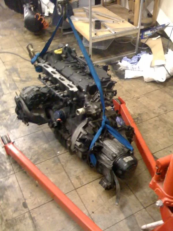

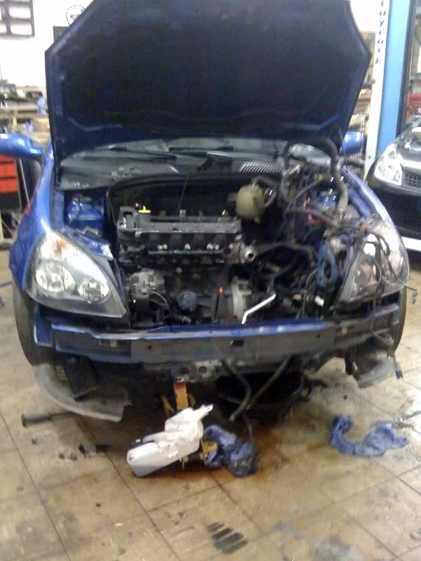

By 6 - gearbox off, engine ancils stipped, new engine back on stand to recieve cams etc. etc,
Will be cleaning up the engine bay tomorrow and getting a few bits ready for the new engine going in on Monday.

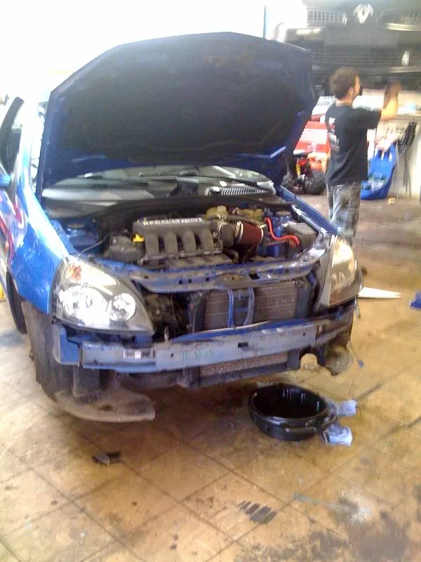

Erm... it's an air filter? ;-) Finished spec 1 Super Cup over Xmas and it was the only filter I could find (in the bin) so it went on for the trip to Leeds for Paul to Calibrate the Siemens.
It made about 0.5bhp difference in the end so it stayed on there during the cold weather. New engine will have a new inlet manifold setup so (a better) filter will be relocated to behind the head light.

You can get them out quicker - but whats the point in rushing ;-) Takes us just under an hour to engine out an X85 but then they're race cars designed to be taken apart quickly i.e. bulkhead loom connectors etc. etc.
That was with a good hour for a maccy d's lunch, plenty of coffee and my standard per hour cig break. On a car with a few miles on it, checking everything as you go to identify potential problem areas and areas which need attention before refit then its about 4.5 hours from start to having the engine on the floor with the box off etc.

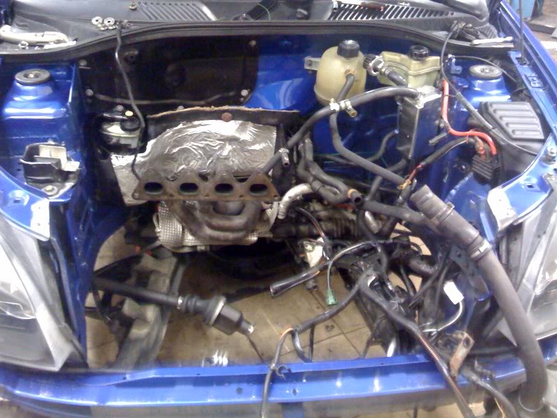

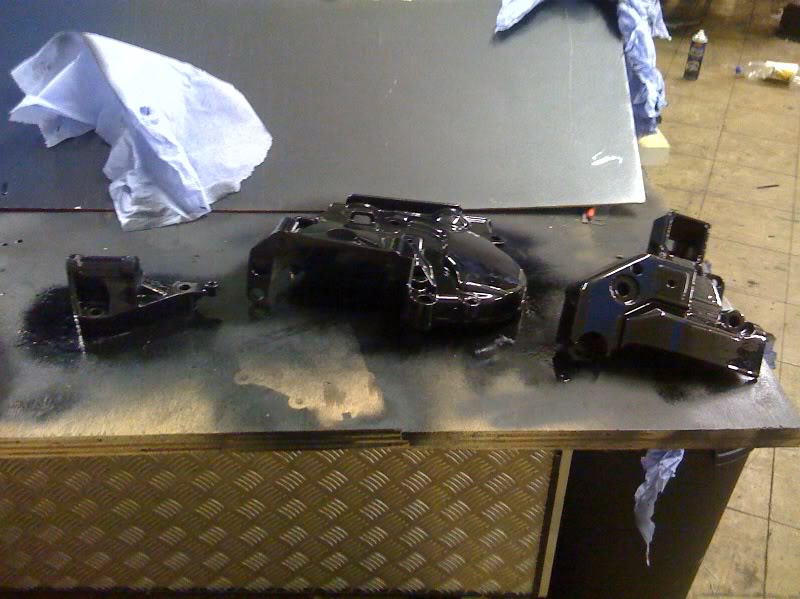

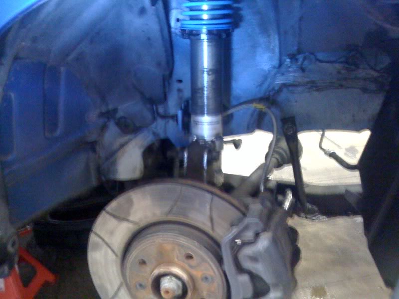

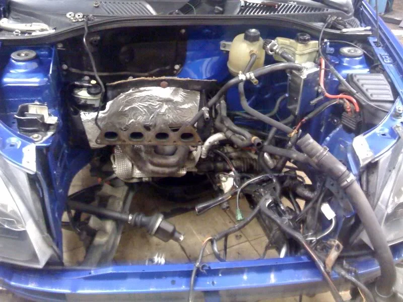

Engine bay cleaned and prepped with some no longer required sound deadening removed , wheel arches cleaned and all suspension joints checked, various bits of engine cleaned and painted, gearbox cleaned up and checked + misc bits.
What's impressive is that at 100K there is no corrosion on anything, all break lines are still in good nick, all the chassis rails are mint etc. Once this lot is done it really will be better than new LOL
New engine should be ready to go in the car tomorrow evening :)

Are you fitting a new/different heatshield? Mine is looking rather tired now, trying to think of what to replace with
Nope the heat shield is the silver bit, the rest is just sound deadening/insulation. No need for anything in addition to that, also with how I've cut it the remaining insulation/shield is retained firmly on the standard fasteners.

My silver heat shield has dropped off... thinking of taking all the insulation/heat shield off and attaching a sheet metal type shield to the original fastener..
Yep that'll work fine. Some Nimbus heat shield material will work well and its very easy to shape....... or some Mylar if you're feeling mega flush! ;-)

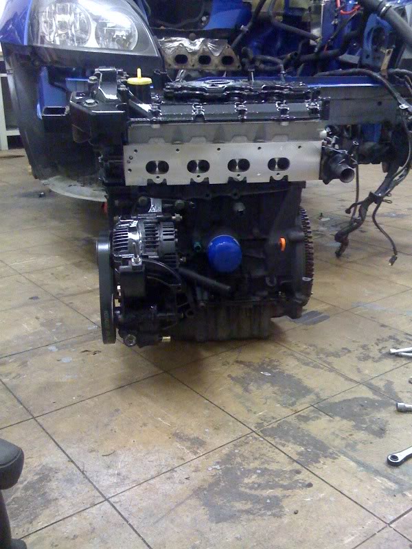

Lump done and ready to go back in.

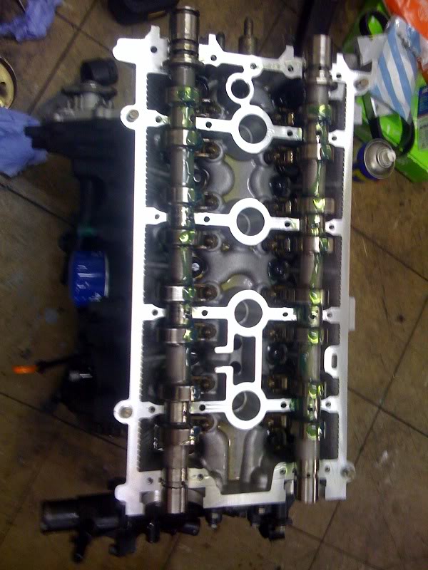

Cams in (standard 428's):

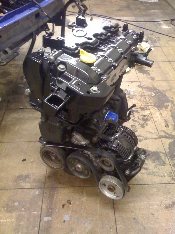

Lump done with ancils on etc.
It's looking pretty good. All belts and seals have been replaced with new so it should have a good few years of life in it with no messing about required.
Cheers
M

Am I just confused or does your inlet-side (on the head) look worked on? flatned / grinded / skimmed or how you call it in English?
Looks super smooth...
BTW will this be the lump you will fit your development inlet to?
As far as i know its a standard brand fire new head from renault. With the inlet work done to it.
It's a brand new cylinder head so it's never had anything bolted to it hence the shiny appearance.
Yep this is the dev engine.

That aux belt is pretty slack ;)
Brand new engines look mint, I'm such a sad cnut.
