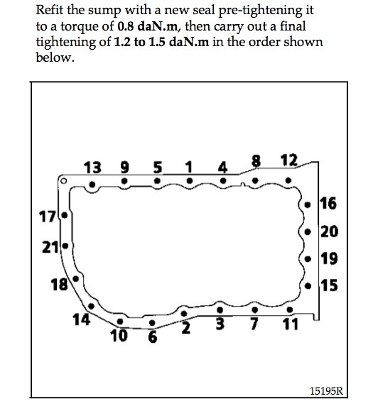

there's a set procedure in torquing up the bolts
