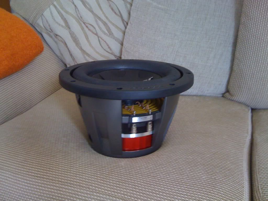

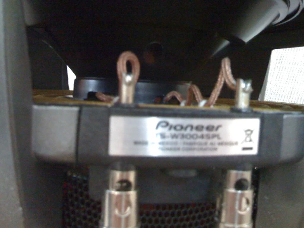

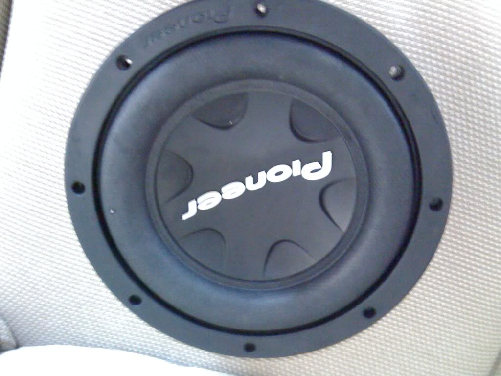

FYI, I have taken some blurry iphone photos of the 3k sub.

Just looked at the sub properly, It's a TS-W3004SPL and needs a lot of power to run it well, and a well designed box! Your amp needs to be at least 3-4times more powerful!
I have heard stories about these being a bit of a pain to make sound decent. I would flog it and stick with your old sub.
