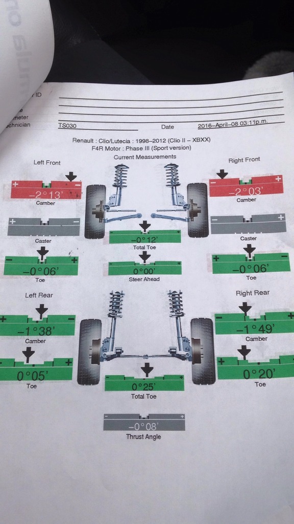

this is the one from my cup track car.

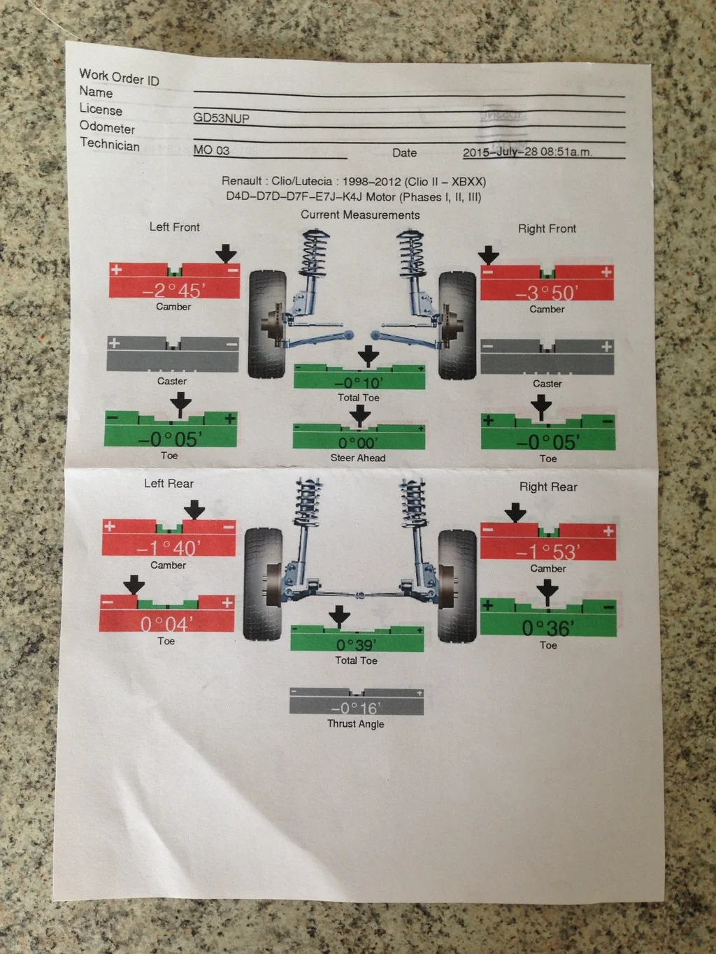

This is the one from my old DCi with 172 running gear.

Rear toe should be centralised...It'll make the car feel as though it's pulling to oneside..in your case...the back ends trying to run around to the left hand side as you've got a slight amount of toe out on the left rear and a high amount of toe in on the right rear. So in theory your back wheels are doing this "|-\" when they should be like "|-|"
This should see you right as it's out on the rear right by 20' (20mins)
http://pure-motorsport.co.uk/details.php?itemid=126&model=5
You may be able to source a 5' (5mins) shim elsewhere for the rear left. :up:
