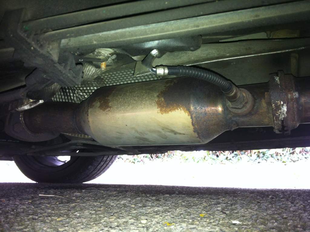

I was told my car had a sports cat, turned out to be a decat.
Looked like this...
