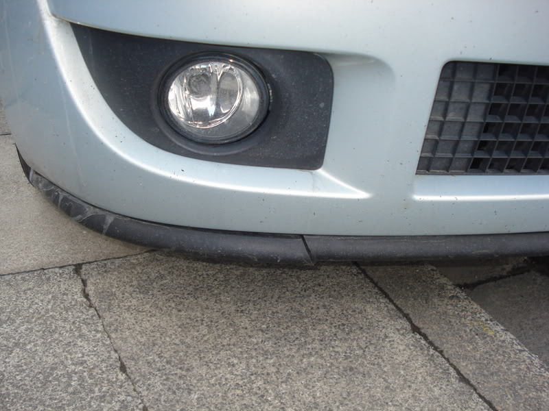

Well I went to get my tracking done yesterday morning.
Come home, went to get in my car this morning and noticed this, I can only think I did it reversing out of the garage yesterday cause my splitter caught the floor coming off the kerb :(
What are my options? :(
options are:
1. CF splitter from k-tec
2. New one from Renault = £££££'s
3. Second hand splitter of here - rare and snapped up in seconds!
4. Brace and plastic weld
5. Splitter from seat, peugeot etc search on here for more options.

put fibre glass on the back of it to join the two pieces together, the splitter is [ shaped in profile so apply tape on all sides other than the back to hold it in place, rough up the surface and apply some p40 fibre glass compound mix (it already has the fibre glass in it all you do is add a pea size of hardener to a golf ball size of compound, no messing about with fibre glass sheets and resin) to the back of the splitter, spreading an even layer a few inches eitherside of the crack.

Think I'm gonna have a blast at what JungleJim said. See how that goes, all else fails I'll keep a look out.

Fibre glass resin and fibre tissue then re-paint with vinyl and rubber paint,cost you around a tenna to fix and will look good as new, i bought mine the same way yours is now ;)
