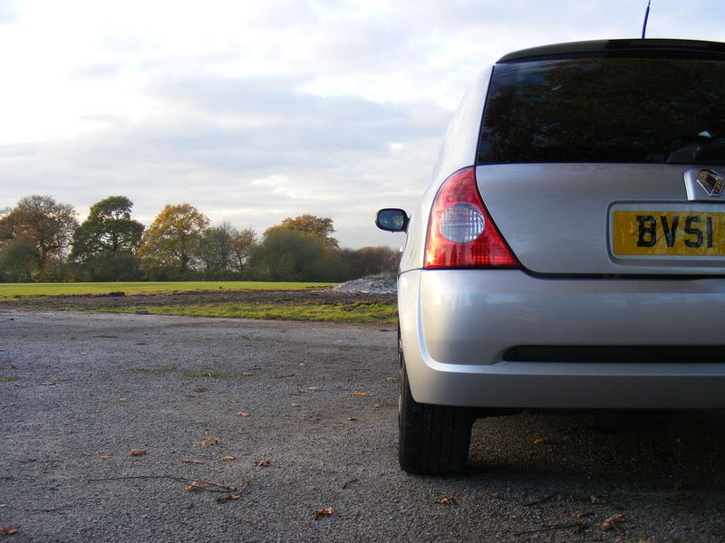

as above ive got standard 172 wheels on 48.5 et and im running 10mm spacers all round and now have the cup off set of 38.5 et feels noticably better imo
plus the wheels sit in the arches better too
  AMV8, Mk1 Golf
from this
to this
but mine doesnt actually have spacers on lol
