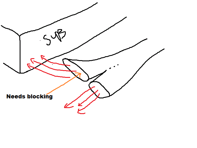

Something I noticed last weekend when my seats were out was that the clio has back seat feet heaters. They blow onto the corner of the SWE1200 sub and was a little worried about it overheating. Here is a little paint diagram:
There is 2 air outlets under the seat and one of them needs blocking off . I used black gaffa tape and that has sorted it.
