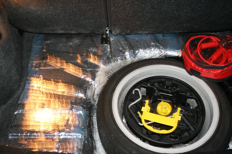

Bump of an old thread but I've ordered 10 sheets of Silent Coat from eBay to hopefully quieten the drone of my non resonated milltek with CAT mod :up: I'll post some feedback when I've fitted it
GavC
  Black Gold 182FF
10 sheets of 2mm silent coat applied to the boot floor made no significant noise reduction. Reckon I should have ordered their thicker 5mm sheets
