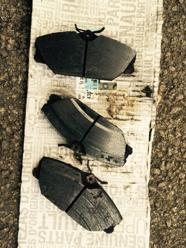

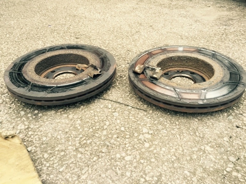

  Clio 200 FF
So had the service done and new brakes fitted yesterday and early impressions are that the difference is pretty damn big with a much firmer initial pedal feel with no squishy feel at all and with really strong retardation even after only doing 30 odd miles so far. I feel much more confident on the brakes now and going to Snetterton next week for an evening track day so be interesting to see if and when they fade significantly.
Car feels better than ever with new plugs,oil and air filter plus full of Shell's finest.
Happy days.:smile:
