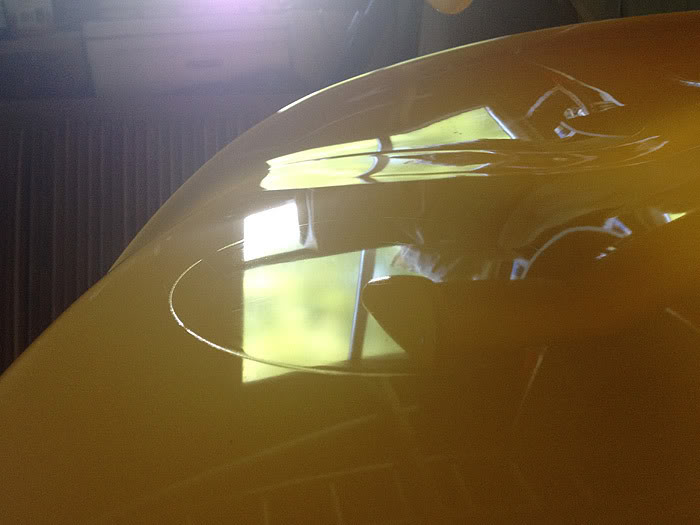

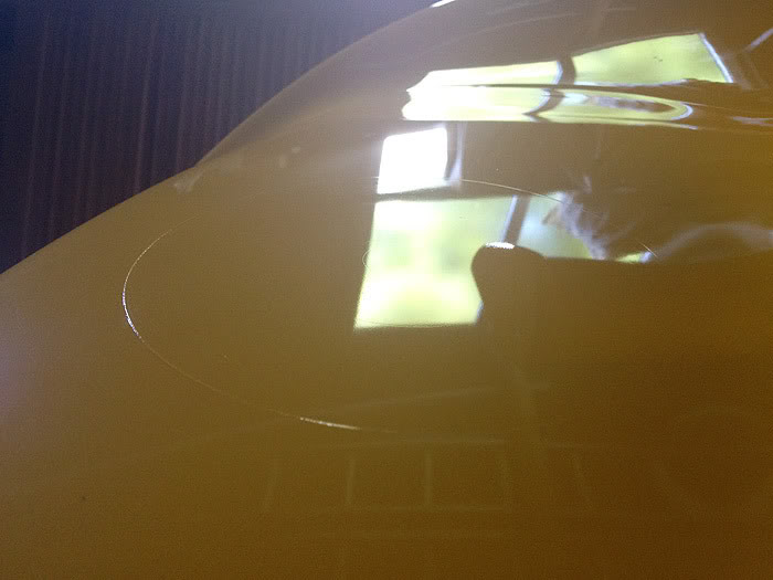

Had a slight issue today when I was rigging my Exige. I think as it was so hot, the paint must have softened up a bit, and with the weight of the rig pushing down.....it created an impression in the surface.
These are about as good as I can capture for now to show it:
So what's the best way of fixing that? Wet sanding?
I do have a G220, put if I just did that area, I can't imagine it would fix the deeper parts (which you can feel with your finger nail)
So lesson very much learnt, don't rig a car in the blazing sun.....especially when it probably doesnt have great paint to start with!

i suspect the paint isnt going to be very hard or thick to start with.
you can slightly improve them with wetsanding and then light compound to a shine.
worst case senario is a bonnet respray
It's a bit hard to tell from pics, but I'd be wet sanding that to try and sort it, or at least minimise how much it shows. I'm a spray painter though so I don't even flinch about taking sandpaper to paintwork, if you're not all that confident take it to a bodyshop/decent detailer.
Pictures make it hard to tell, Dan. I'm worried that the paint has actually sunk rather than scratched. There is only so much you can do with wet sanding and paint correction, as (as you well know) these take layers off the surface to level out the paint, getting rid of the V shaped scratches.
If it is worst case scenario and the paint has sunk, a respray is likely to be your only option. I know about paint correction, I don't know about painting. Kev/Gally is your man, so I'll let him come back with his thoughts.
Well I'd probably give it a blast with my G220 and intensive polish, but I have no idea how thick the paint is.
It would be great I'd there's anyone near who could quickly measure the car so I know if it's safe to try it.

Hmm toughy that one mate. Really not the best place to have any damage as you know painting clams run into mega £££'s.
It's definitely "imprinted" itself in the lacquer. I know you're not really wanting to wetsand it and I certainly wouldn't recommend it to you, last thing you want is damaging your own car.
You can't be far from Russ in the Midlands. http://midlandscarcare.co.uk/ He's on here also. I'd certainly get it over to him and let him cast his eye over it.
If you were closer, I'd more than be willing to offer. Unless you're going to CSS and Kev can bring his Depth Gauge?

I wouldn't polish it at all mate, you'll end up chasing it and in doing so removing too much clearcoat, at this stage it's best to leave it until it's looked at. If it's easy enough to remove i'm sure Russ would tell you (hard to tell from the picture of course) The more clearcoat that is left the easier wet sanding becomes. :)

Looks like the cups sank into the clear coat, depends entirely on how thick it is tbh mate. You might get away with wet sanding

If you can feel it with your fingernail, the only way to fix it 100% to get it painted.
You could tidy it up/make it less noticeable by doing a bit of sanding/polishing but you will never get rid of it unless you get it painted.

You'd be surprised how mailable fibre glass gets when its hot. Soft paint and hot fibre glass will lead to these when used with suction mounts, my friends hill climb Tuscan is covered with them from his little rig.
The pain will be soft to cope with the amount of flex in the fibre. You get an odd interaction with fibre carrying the wait around the rim of the mount an you get a depression like that.
That is a respray job.

Lotus paint on elises and exiges is very very soft ,and the clearcoat layers are reasonably thick as well , having had a few that does look like fibreglass stressing , the panels really do become flexible when warm and you have to be really carful with them , about the toughest place is the roof usually .
