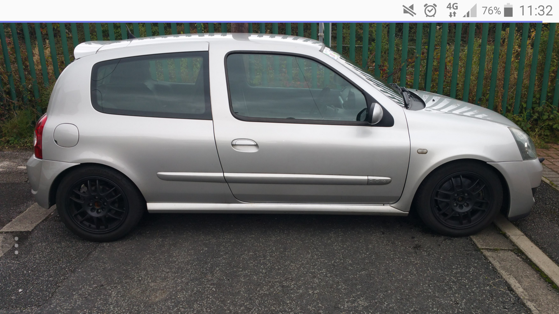

If you set the ride height the same all the way around with your weight in the front seat that should be fine due to the cars natural forward rake. Get the car on level ground and measure from the centre of the wheel to the wheel arch. I was 33cm all-round on AST's and 15" wheels and it looked like this below.
