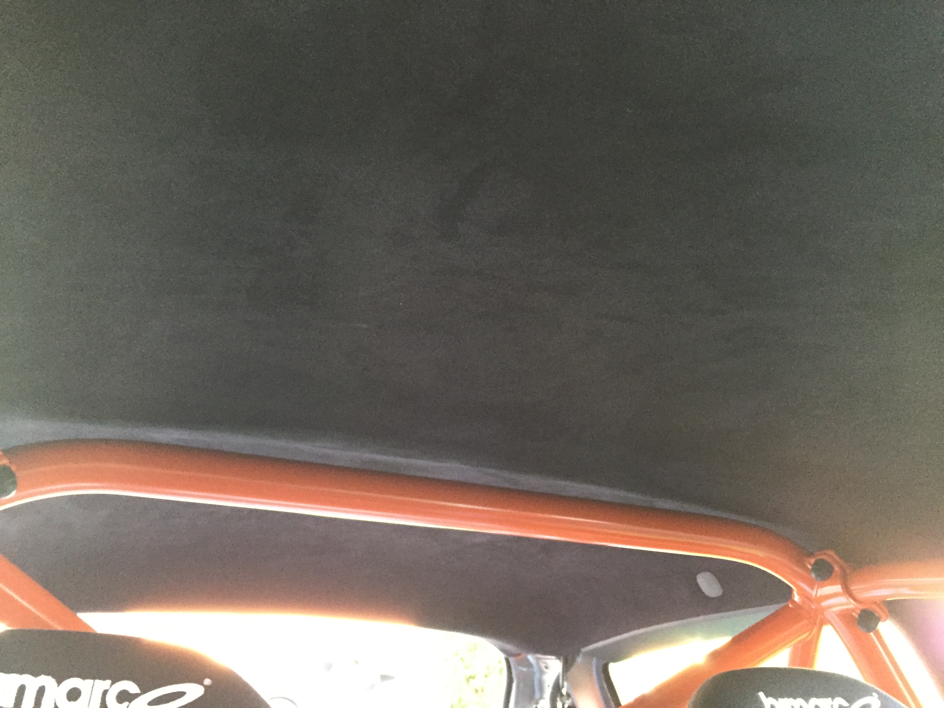

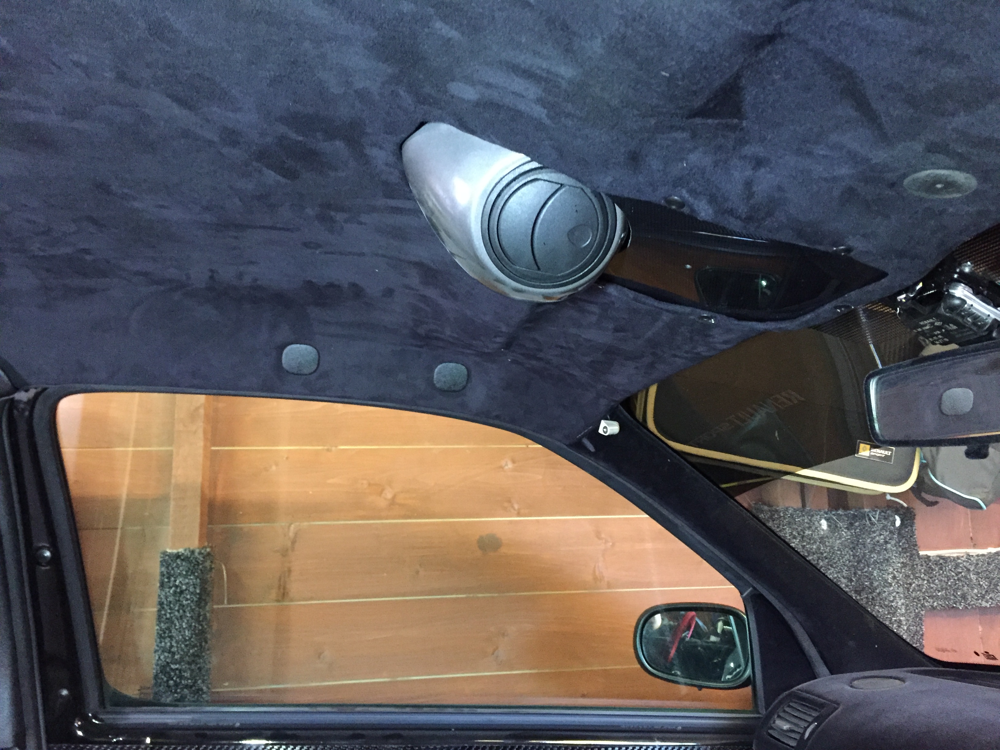

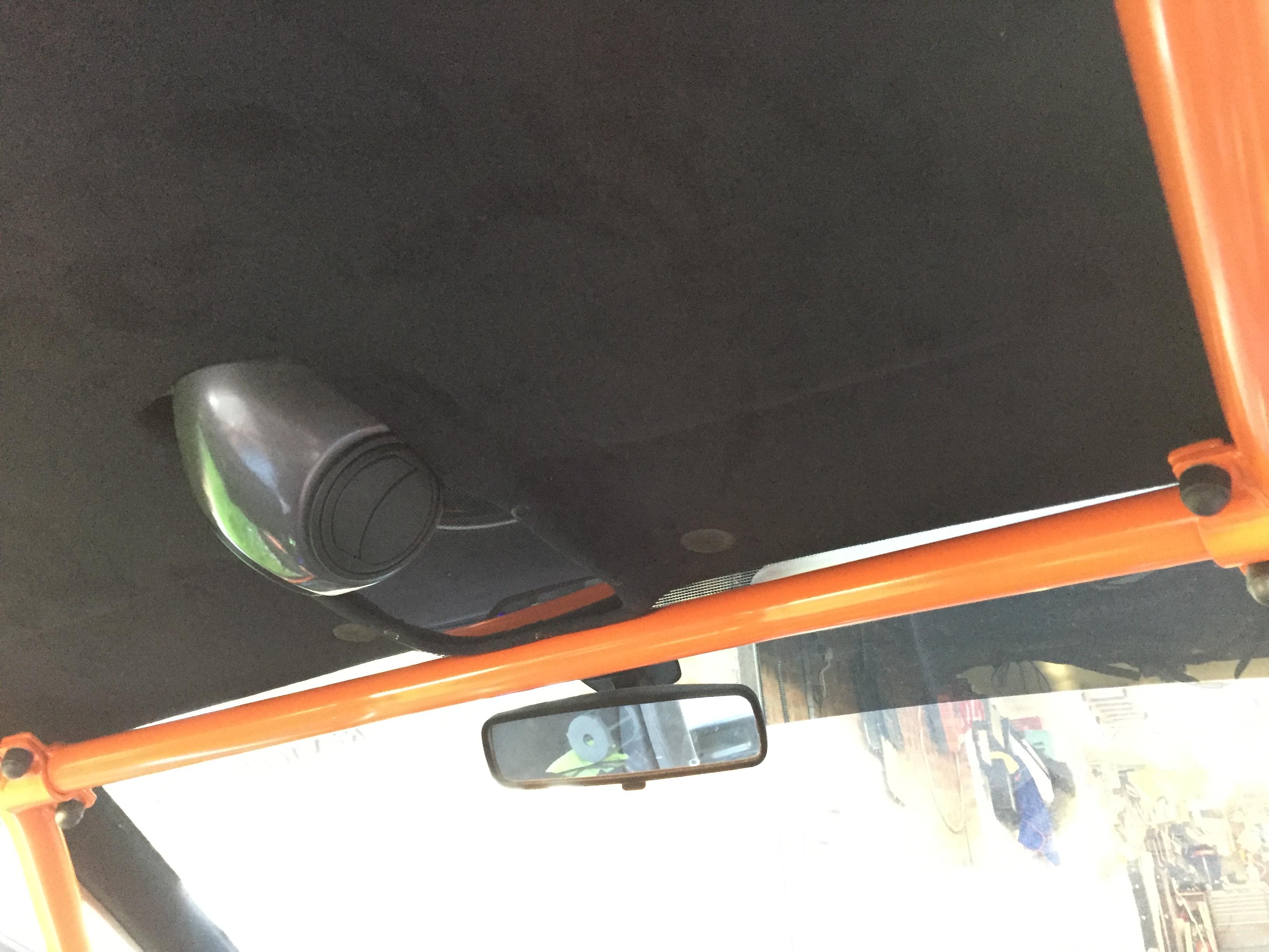

Do it yourself it's not that difficult, and if it is sagging noting to lose by trying anyway.
I retrimmed mine in faux alcantara cost about £25 - £30 a couple of cans of spray adhesive and the material.

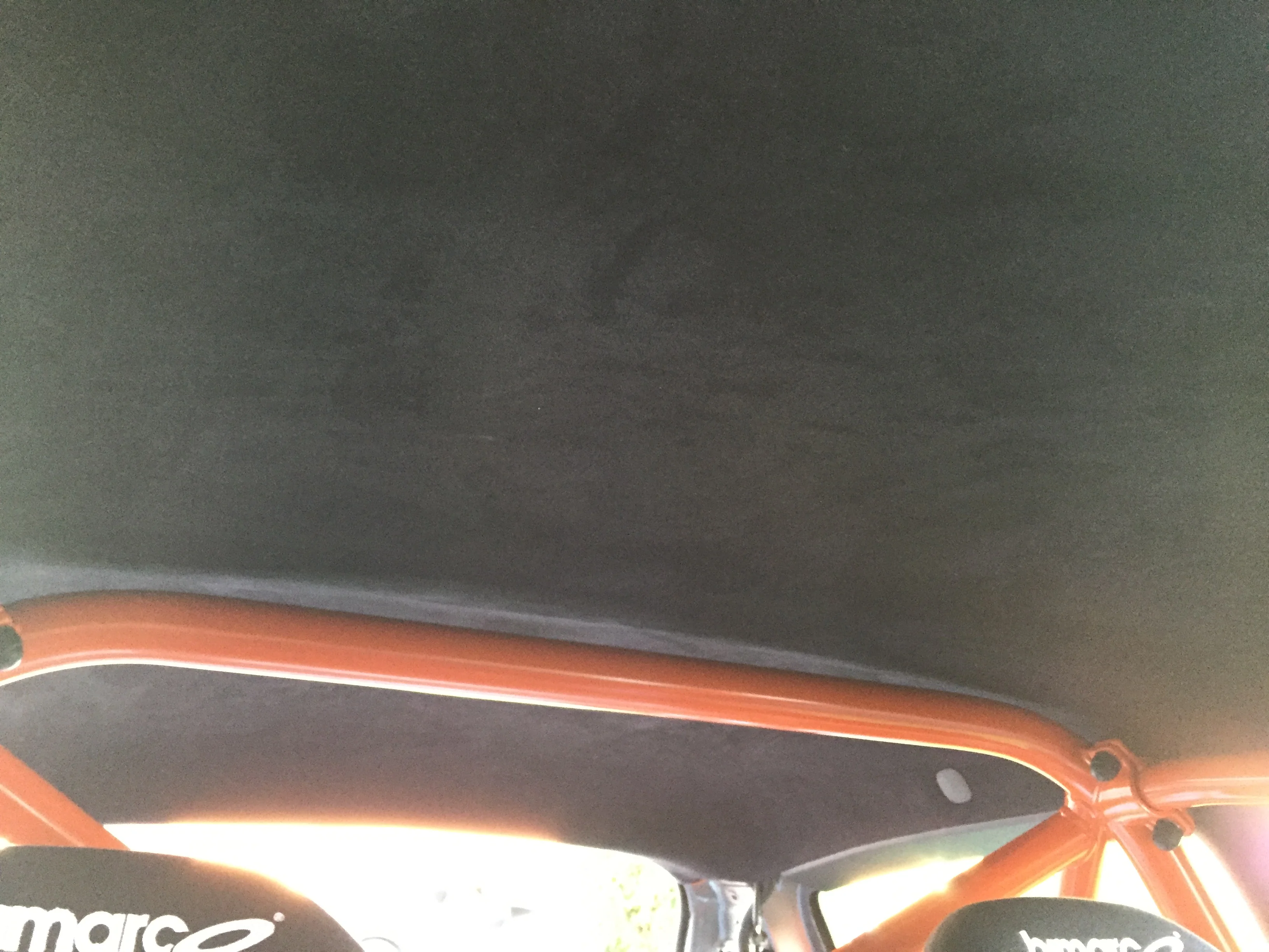

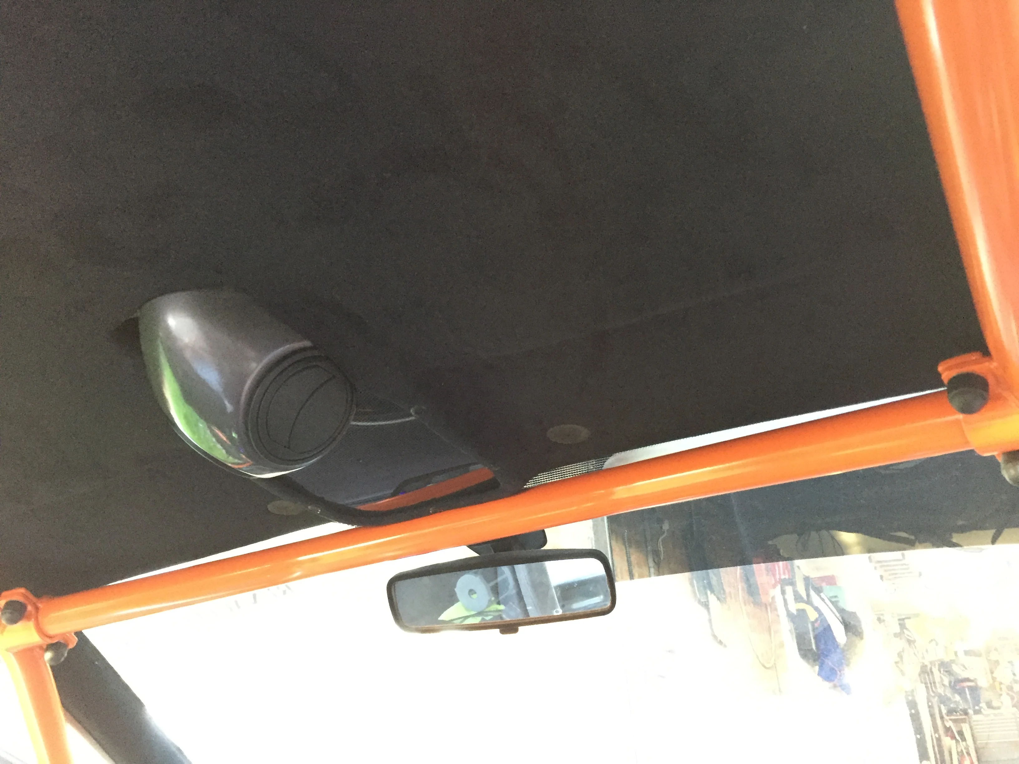

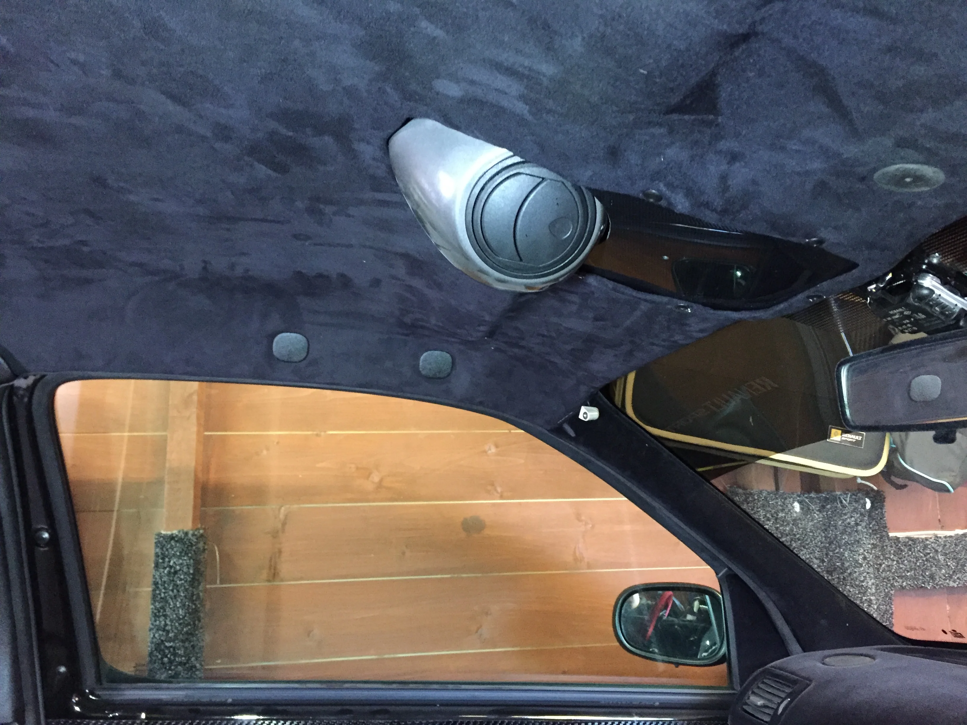

Did you have any trouble stretching it to the curvature of the liner?
npt
  BMW 320d- 172 cup
Not at all, once you have removed it and it’s on the floor the alcantara just just formed to the shape no stretching needed.
Did you remove the old stuff or just stick on top, I need to do mine, thinking mid grey
DomP182
  ph1 172, Arctic182
You have to remove the old stuff, it's the thin layer of foam between the material and the liner that breaks down causing it to delaminate
