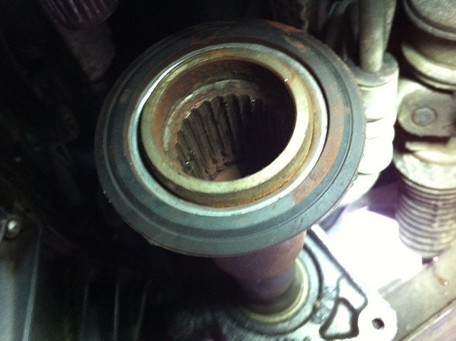

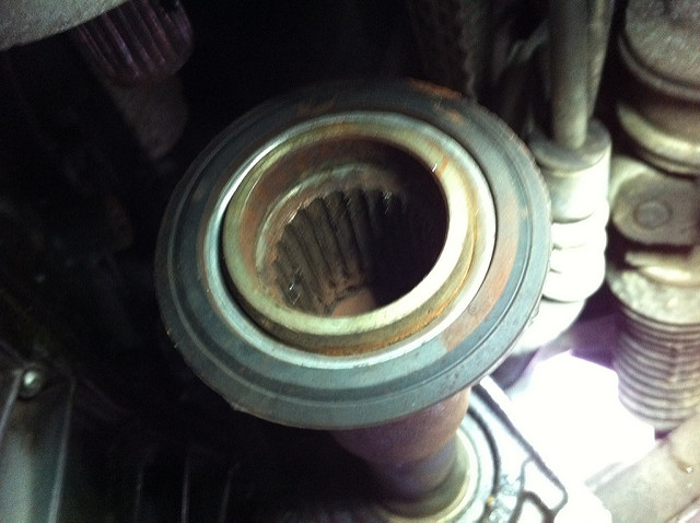

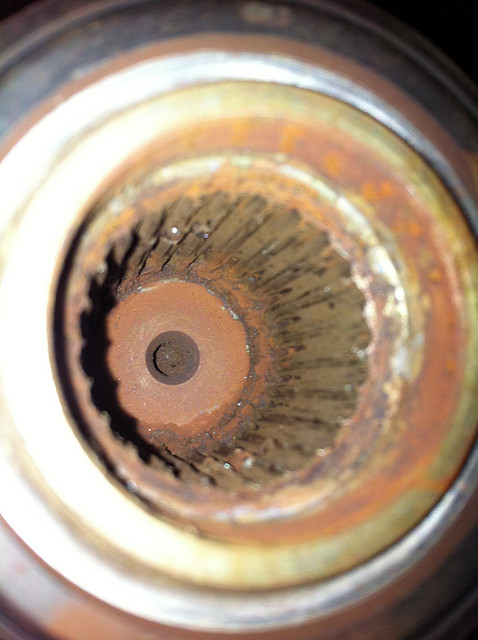

I managed to get it off the gearbox end but I'm not sure its worn enough to cause problems. I'll get some pics up and see if it looks any worse/better than yours does.
  LY R26 #288
IMG_0148 by JoeRS182, on Flickr
IMG_0149 by JoeRS182, on Flickr
IMG_0152 by JoeRS182, on Flickr
How does mine compare to yours?.

But from your pics it doesn't look great, so it looks like that could be your problem too, take it off like I said above and it should then be obvious how bad it is. It won't come off the driveshaft very easily though.
  LY R26 #288
Glad to hear its sorted. I think I'll order one aswell. Mine does look shot in the pics. I'm guessing the teeth should be sharp and triangular they seem to be more oval.

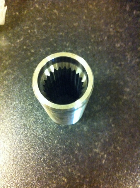

I've got the new part today. Looks much much better than my one. As you can see on my previous pics the teeth are practically non existant. Not nice and sharp like on the new part. I'm confident this will fix it but I wont know untill the weekend. What was your method of getting the part off the end of the driveshaft?.
  Clio 182
