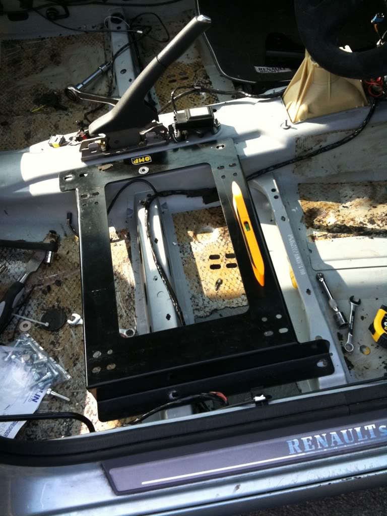

No not that stupid bit of foam underneath the bonnet, but the stuck on crap that is plastered all over the inside shell, as seen in the pic...
I'm guessing a heat gun and some sort of scraper, but if using a heat gun on the stuff on the roof, is there any danger in damaging the paint on the other side?

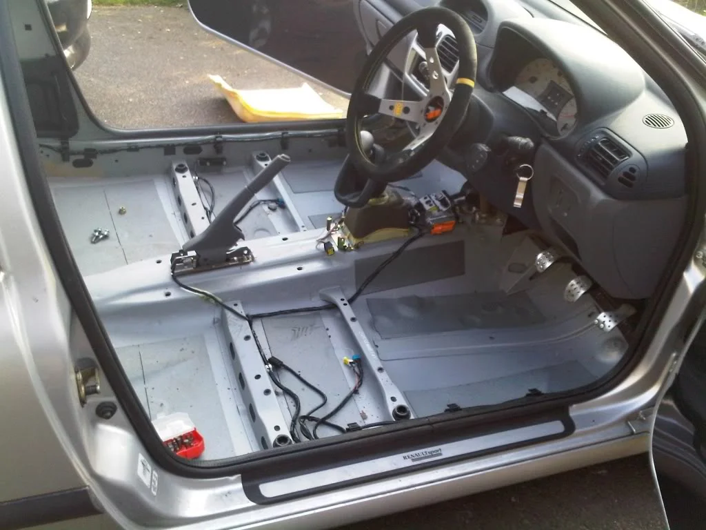

I removed all the tar patches from my 172 last week.
I bought a heat gun from Machine Mart £20 that and a chisel/ paint scrapper makes light work at removing the tar, even on setting one!
Well worth doing. I now have a very heavy carrier bag full of tar.

I disagree. Everyone who has picked the bag of tar up is surprised at how much the discarded tar actually weighs.
It does leave a mess, but I am going to spray the interior matt black anyway.
