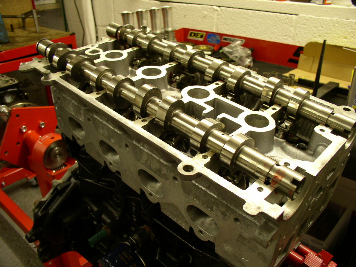

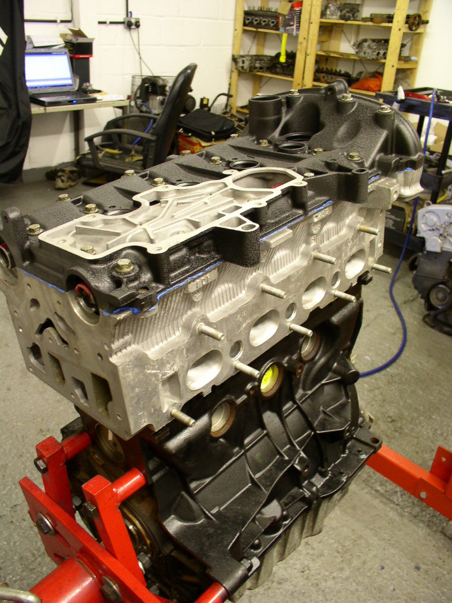

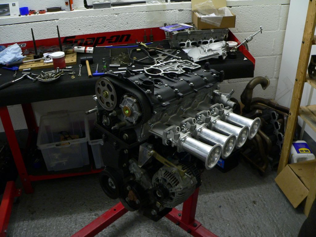

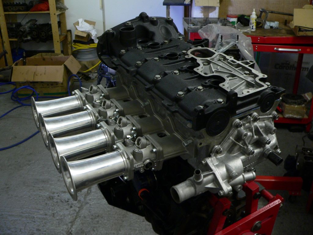

I need pictures of F4R engine, from any angle possible, so if anyone has it...
I would also like to see that engine without the plastic cover on top...
Many thanks...:)

so how does the vvt work on these? is it like an automatic vernier pulley? lookin at those pics, its not like the vtec sysem where it has a hi-lift lobes on the cam.
Your on the right tracks.
The cam is a normal cam, with a single lobe per valve. In OE trim the timing of each valve per cylinder is a few degrees different to aid swirl and efficiency, but i junk that offset on my cams.
The VVT pulley has vanes on the inside, once you reach a certain rpm/load trigger point (1450rpm @+800mb) then a VVT plunger is activated, which opens an oil galley into the centre of the camshaft, which then supplies oil pressure to the pulley. The oil pressure is directed to one side of the vanes which changes the relative position of the pulley to the cam, advancing the cam 16 degrees. Its not too fancy and basically is an on/off setup. But the same pulley is basically used on the constantly variable system on newer renualts, but the plunger recives a pulsed signal which will affect the amount of pressure on either side of the vanes so you can advance/r****d the cams by however much the ecu decides is correct.
