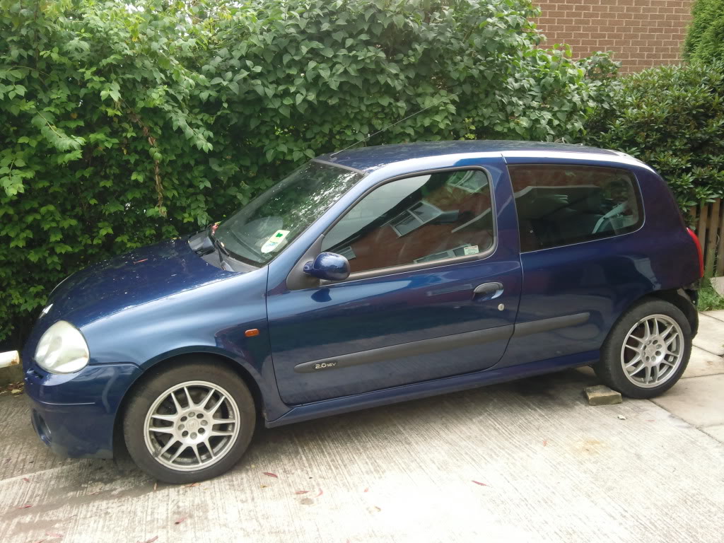

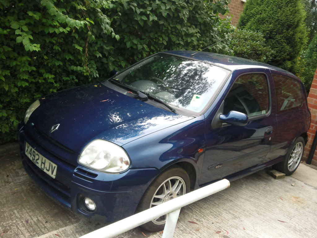

i bought the car back in september as a non runner and a rear end bump :(
the car got delivered to me at 10.30 in the evening so just put it on the drive until the next day. the person on ebay said it had run out of petrol but would not start once they put some fuel in.
next day i went to investigate the issue, no ecu in the car what so ever, so contacted the seller and amazingly he knew nothing about it it had been at his brothers so he said he would contact him and get back to me.
needles to say no call and not answering the phone.. c**k
so the first job was to source an ecu which mr paul murray(rs tuning) gave me and unlocked it for me.
the car would still not start so once again mr murray came round with his testers only to find a corroded live wire to the ecu hence no power.
10 minutes later she came to life and sounded great :)

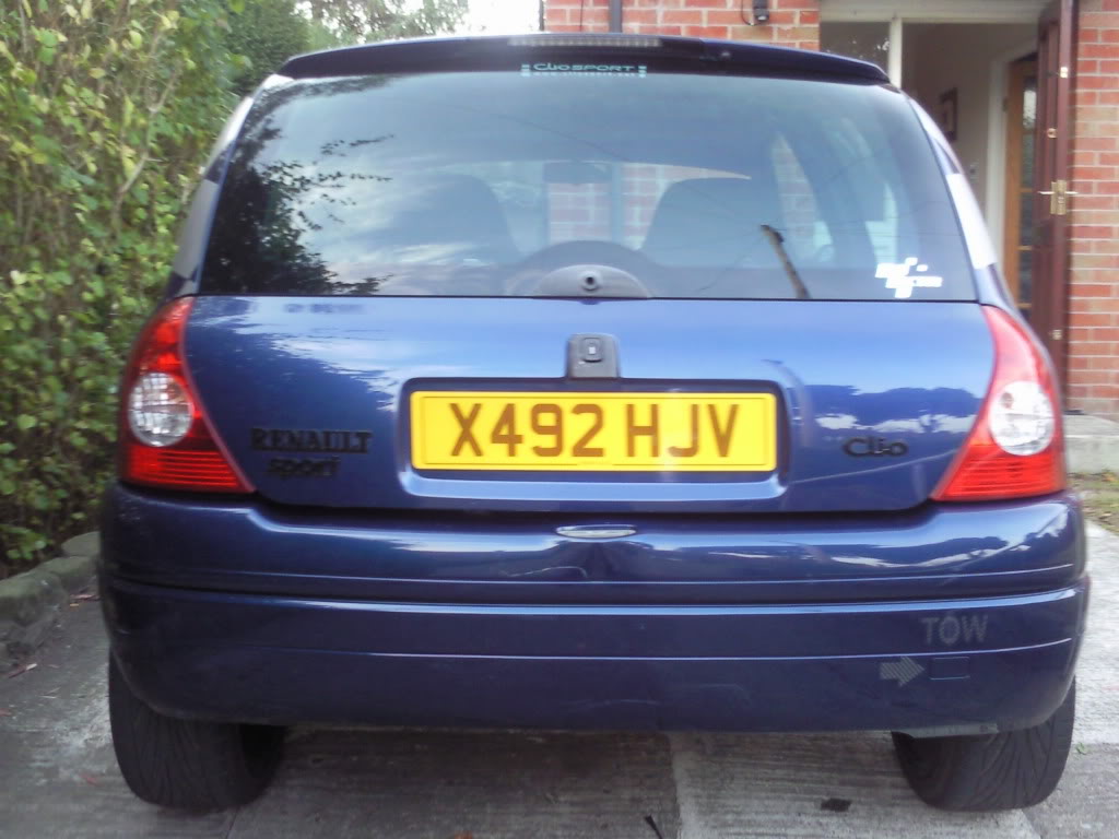

how she arrived.
i hen set about fixing the back end bump which needed a new tailgate and a bumper which i sourced in the same colour to save time on painting :)

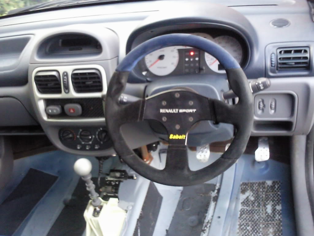

next on my list was to strip it out and fit my steering wheel and find some bucke seats as we had a rackday at elvinton booked (nice and close o home just in case as you never know with a new car)

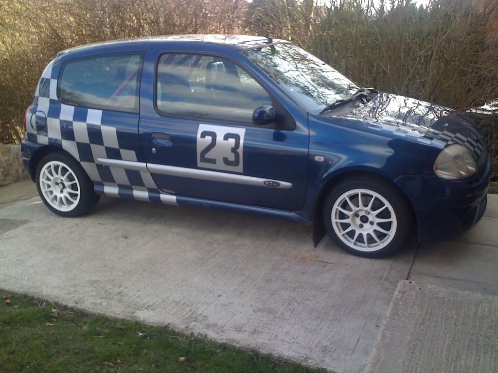

i then purchased some eibach sportlines to lower the car a bit but acually seemed to make no difference whatso ever, however the car did drive and handle much better :)

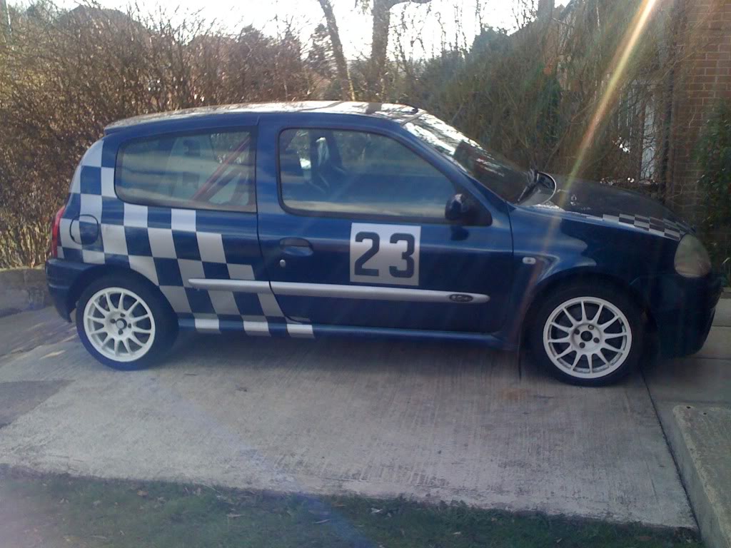

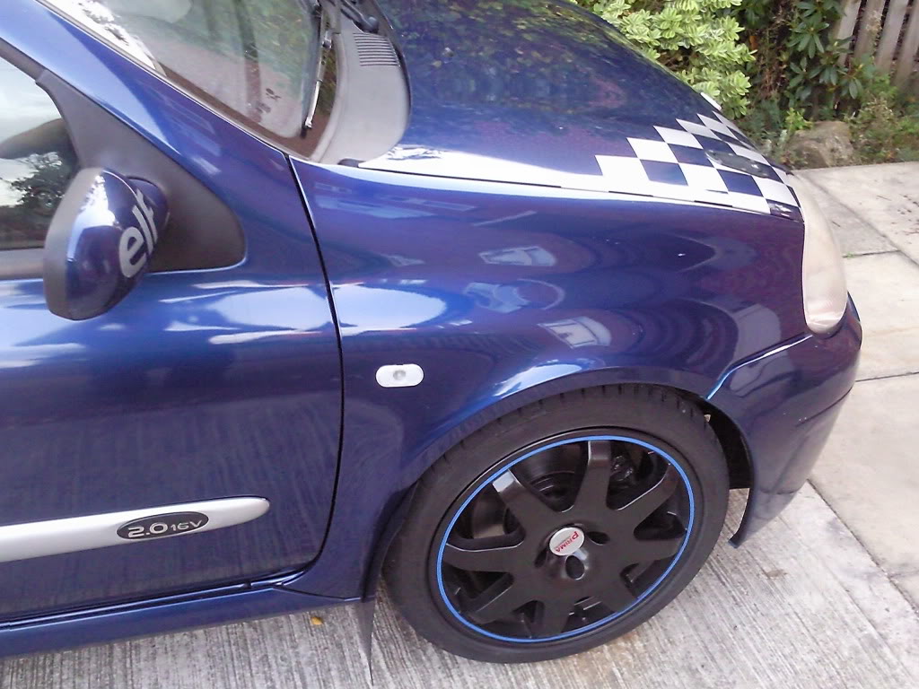

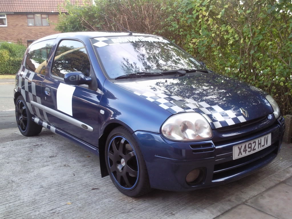

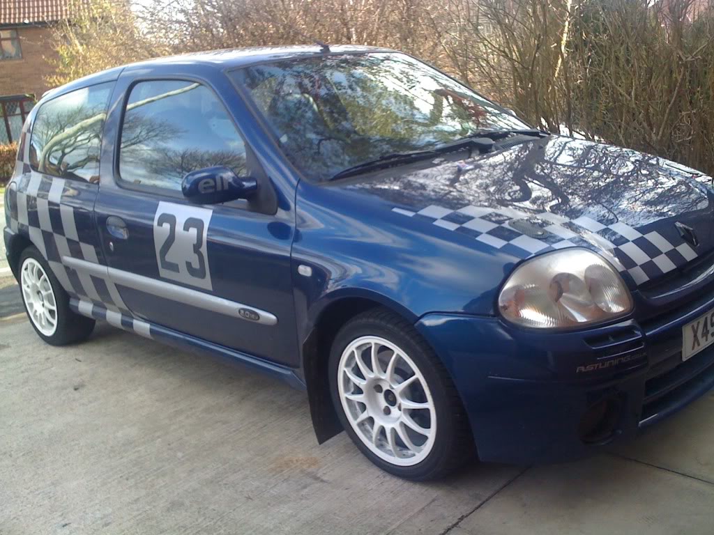

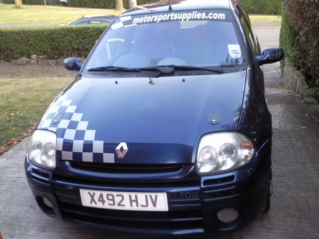

after that i hen bought a nice new set of r888s o fit to the oz f1s so i now needed another set of rims to run on the rd with so bought a set of 17" prima racing alloys and had them powder coated in black.
as you can see i also put some decals on to make it look a bit more like a track car (not to everyones taste i know)

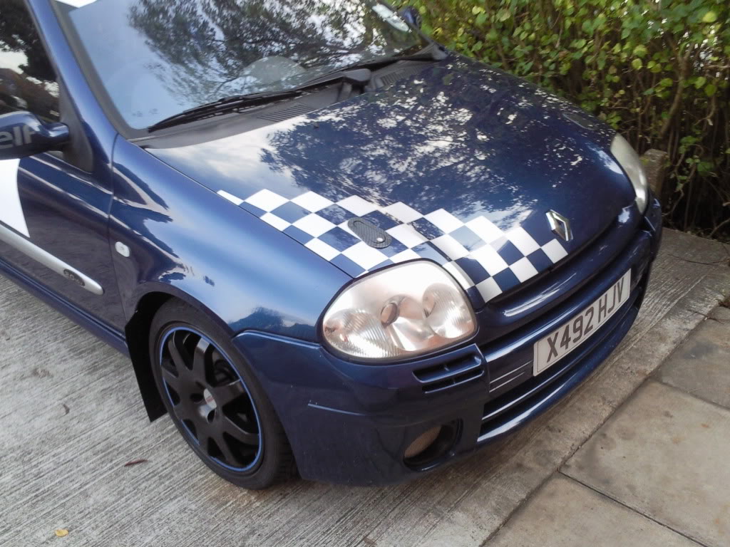

whilst keeping myself busy i fiited the aerocatch bonnet pins,
i know im bad for cutting up an original alloy bonney but nevr mind needs must :)

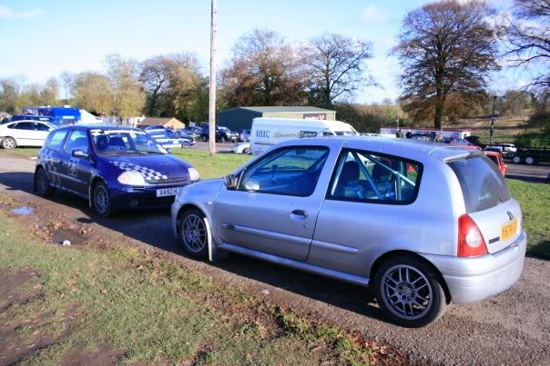

my friends 172 with mine (his bought off of here might i add :))

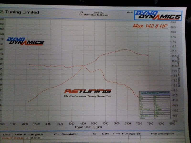

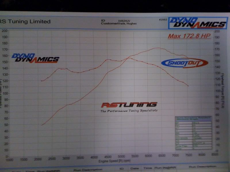

i also forgot to mention that whilst he engine was out i had a deca fitted and a blue flame full system fited, i then whipped off the inlets and did a bit of DIY maching which turned out to be better than expected as i then got the car dynod at rs tuning with the 3 month old fuel in and it made a healthy
172.8 bhp
i was really pleased with the figure and it definately fel livelier mid range:)

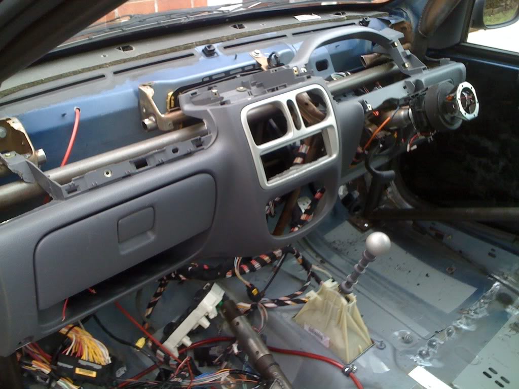

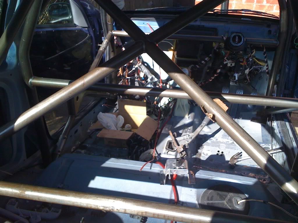

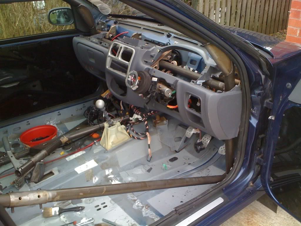

after a week of driving it round i thought enough putting off he inevitable and set about the cage :(

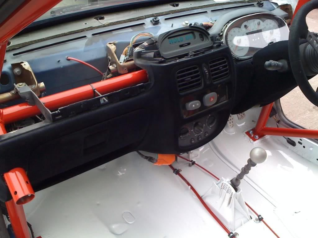

first off was to remove the dashboard and some of he un needed wires.
that was a job in its self, he wires for he boot were all removed and the wires for he back lights were tucked into the sill hrough grommets then run in the rear quarters to the back leaving no wires on show at all :)

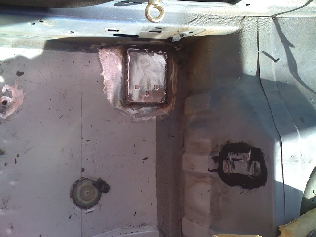

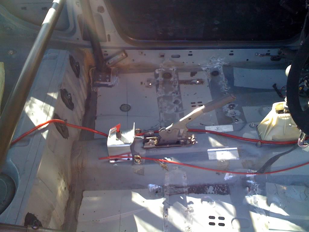

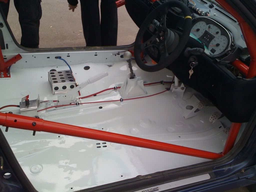

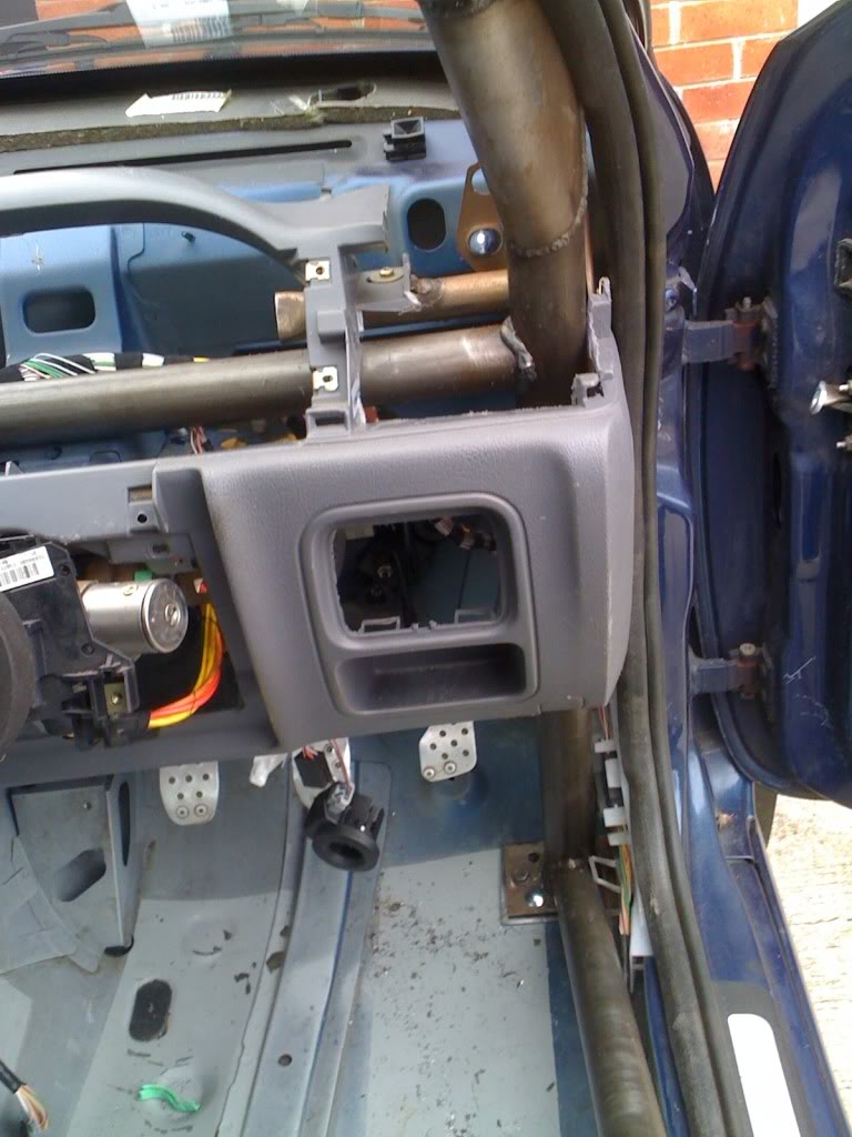

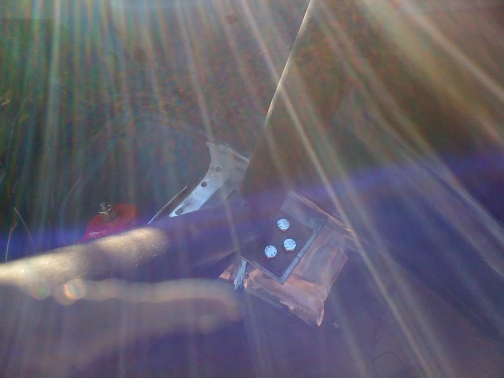

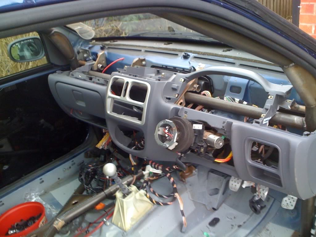

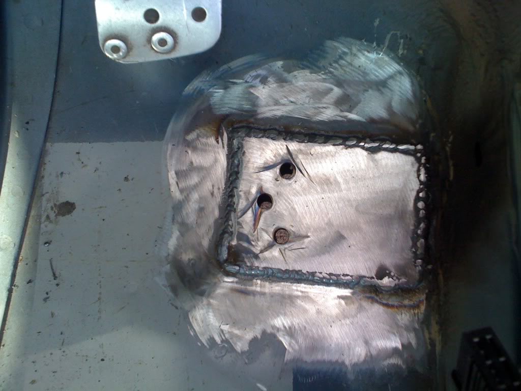

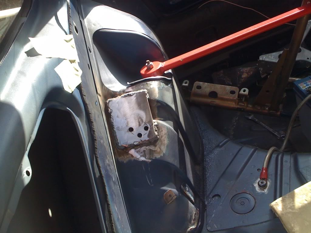

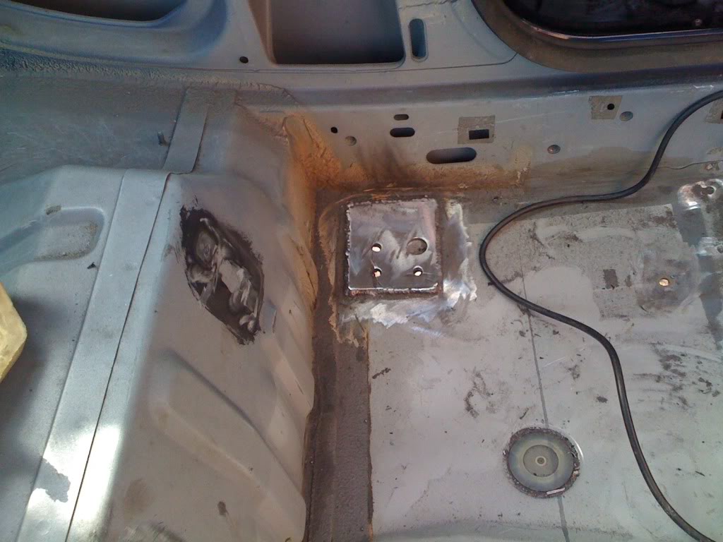

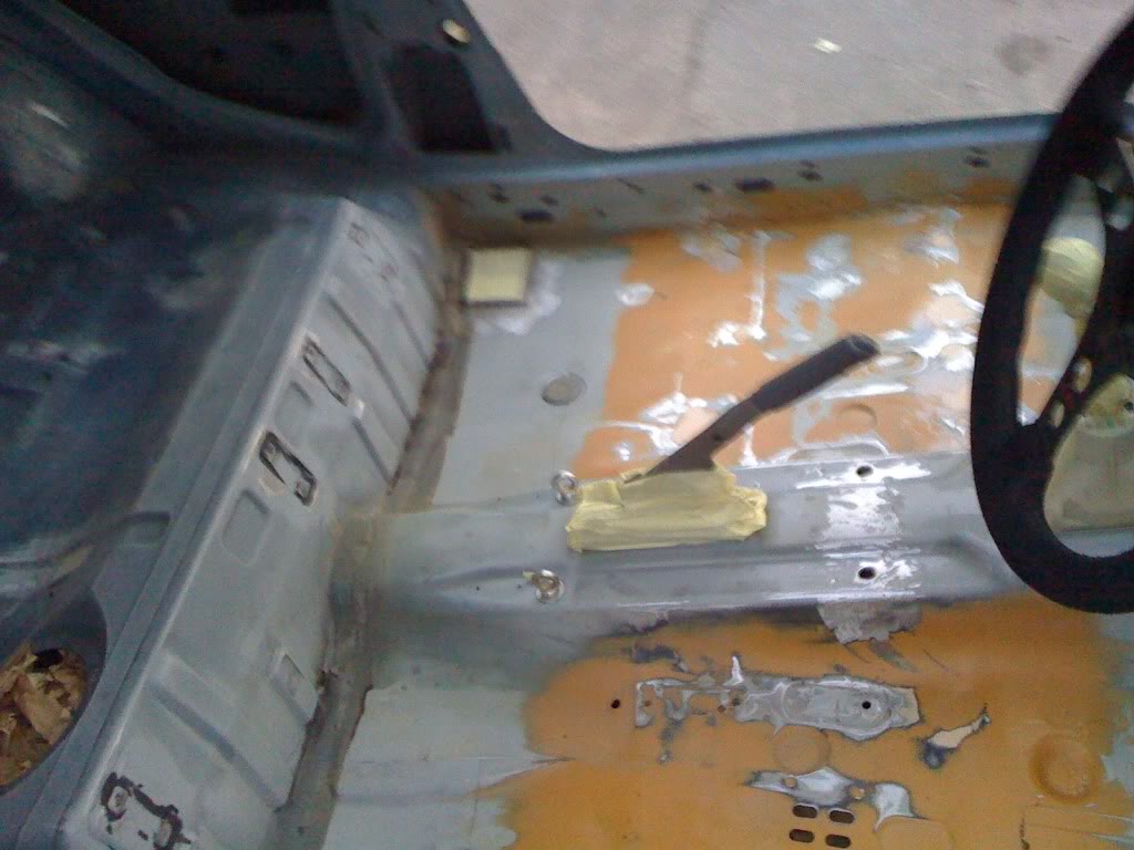

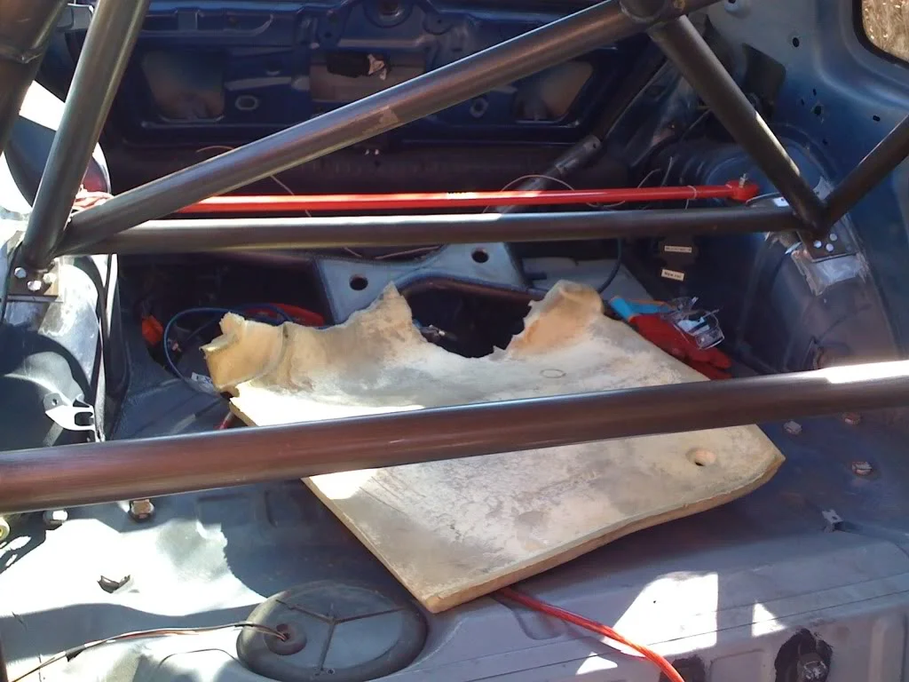

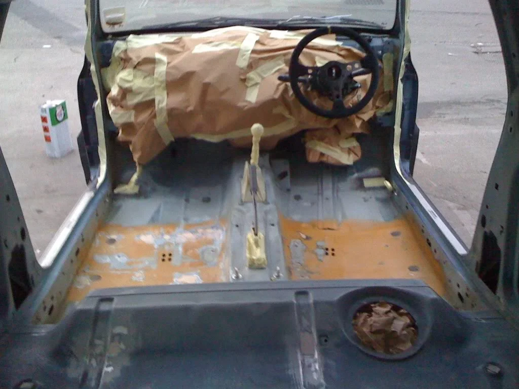

next on the list was to remove all the ar and clean off all of the remainder of he glue, at the same time i removeved the seat crossbars that are spot welded to the floor and various unused brackets throughout the car

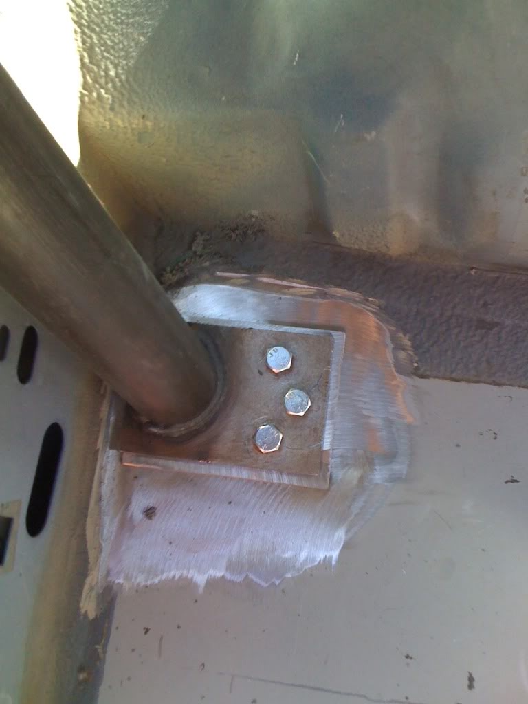

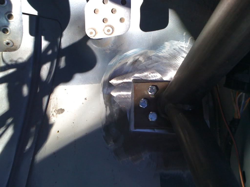

we then set about trial fitting the cage and cutting the spreader plates to size then drilling the floorand bolting down.

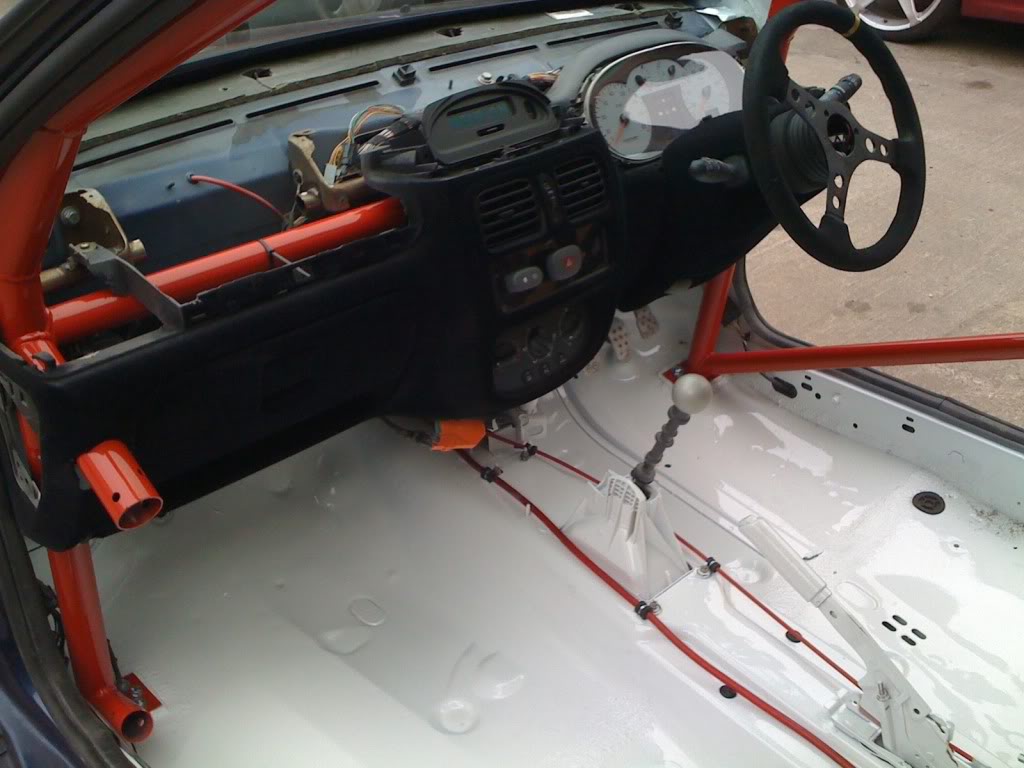

at the same time i had to rial fit the dash as it had to go around the front crossbar of the cage,i ended up having to cut the dash mounting bracket into 3 pieces and grinding bits off here and there o make it fit.
no dash :(
then the messing around
once that was all done the car was shipped to SPRAYFIX in leeds for them to weld he plates.
he tacked the plates then we removed the cage so he could get all the way round the plates properly :)
try removing a cup cage its like a fookin jigsaw the windscreen got broke and the roof got dented in a couple of places.

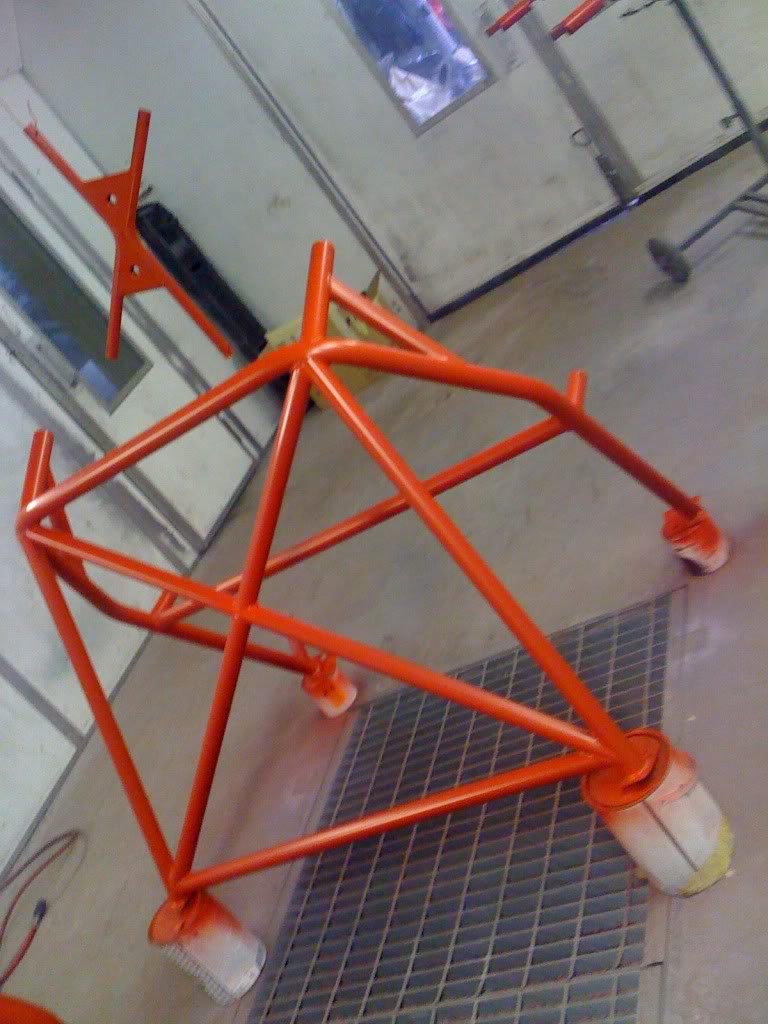

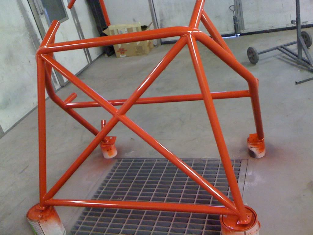

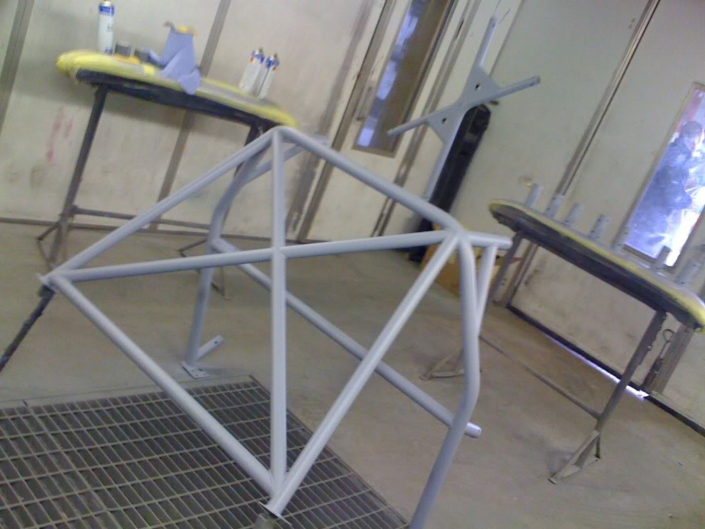

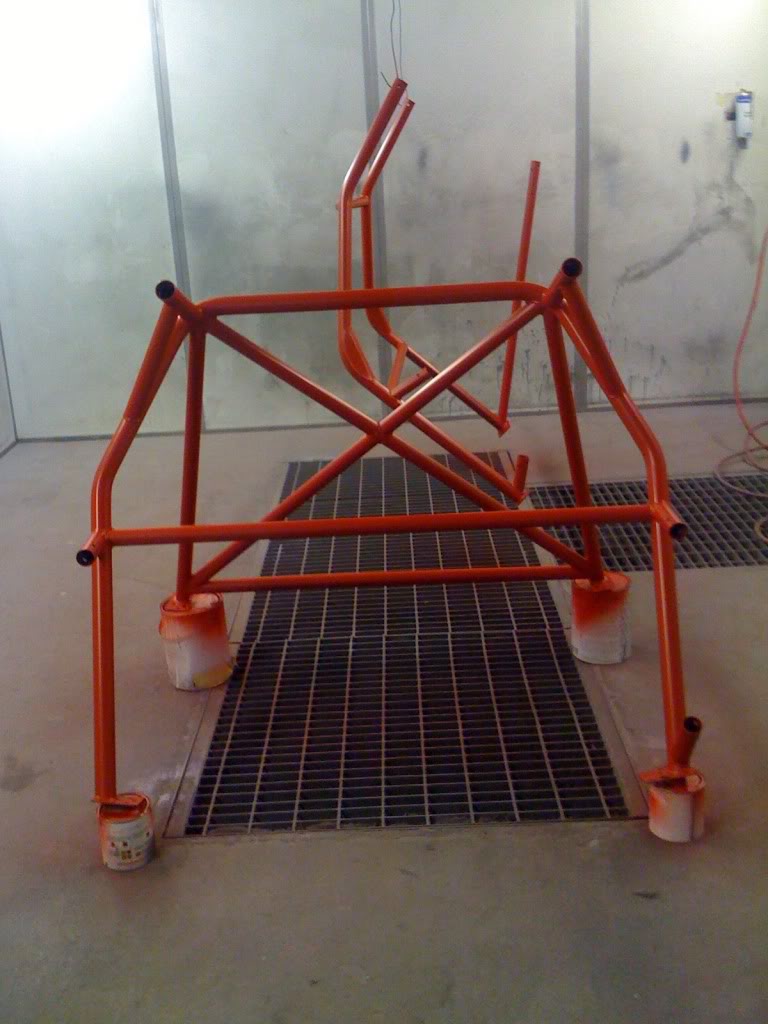

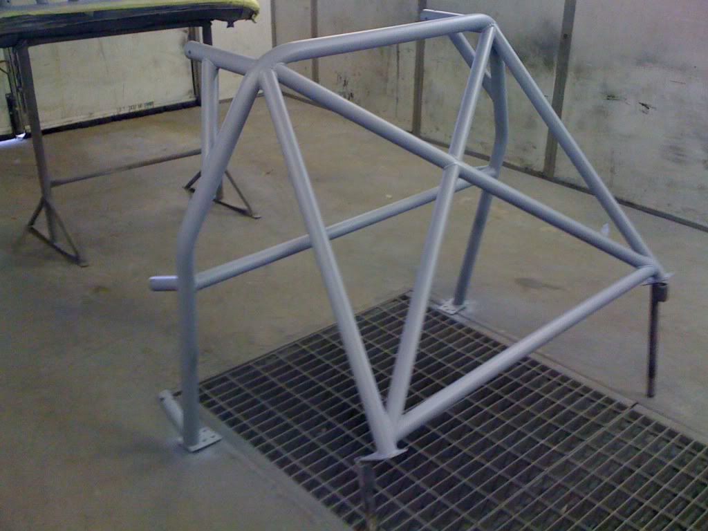

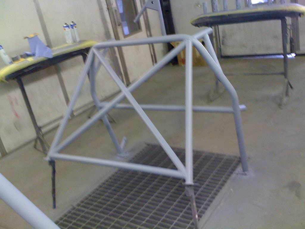

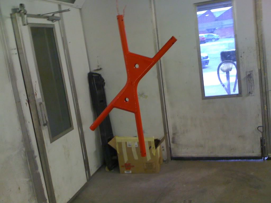

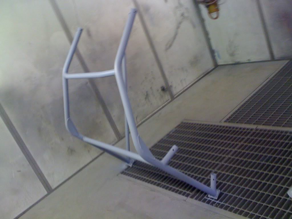

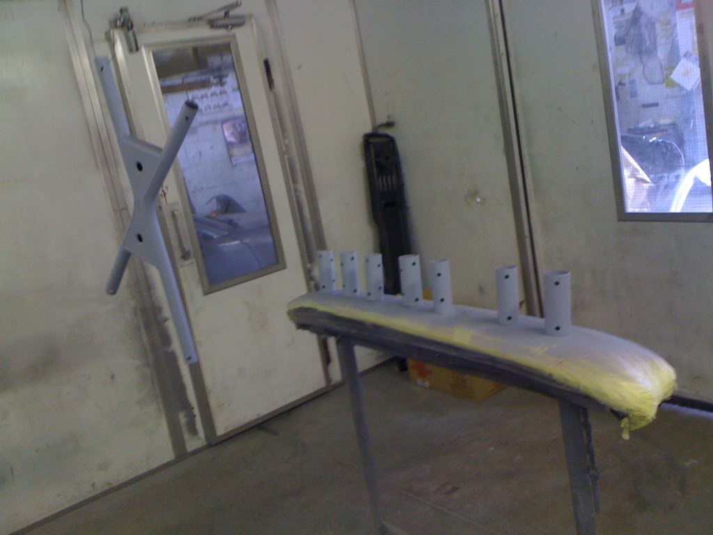

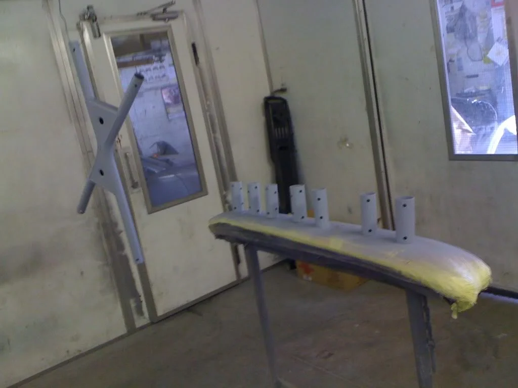

next was to prep the cage as it was brand new and had been coated in oik to stop it going rusty (just what you dont need when you want to have it sprayed :( )
so i set about it all with degreaser and scotchbrite and got it gleaming :)
so then i primed here up and it actually felt like i was getting somewhere eventually :)
in the meantime id dropped my bottom half of the dash off at yukspeed for them to flock for me along with the steering cowling.

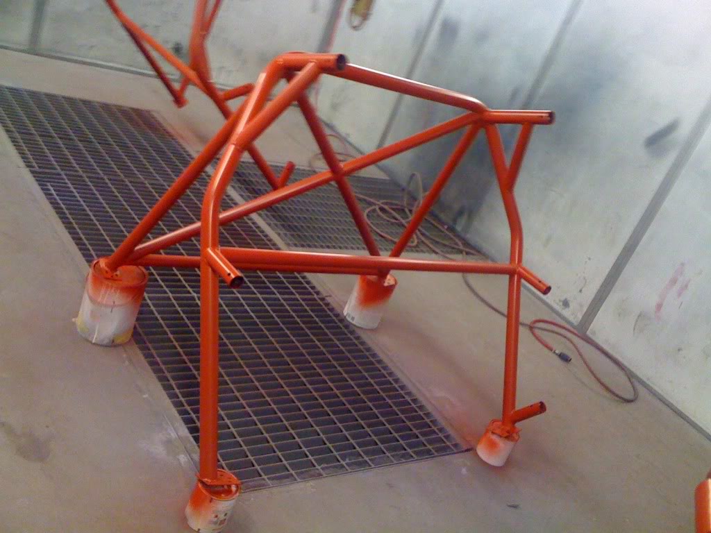

then the best bit is having it in painted :)
mmmmmmmmmmmmm shiney paint :D:D:D

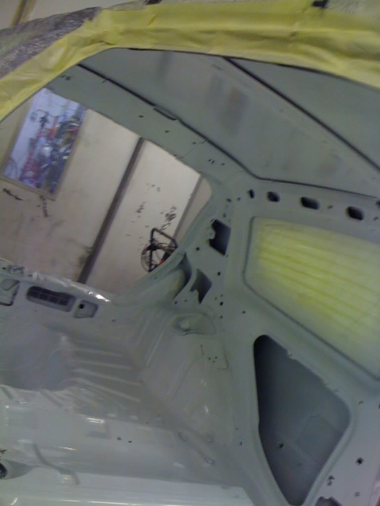

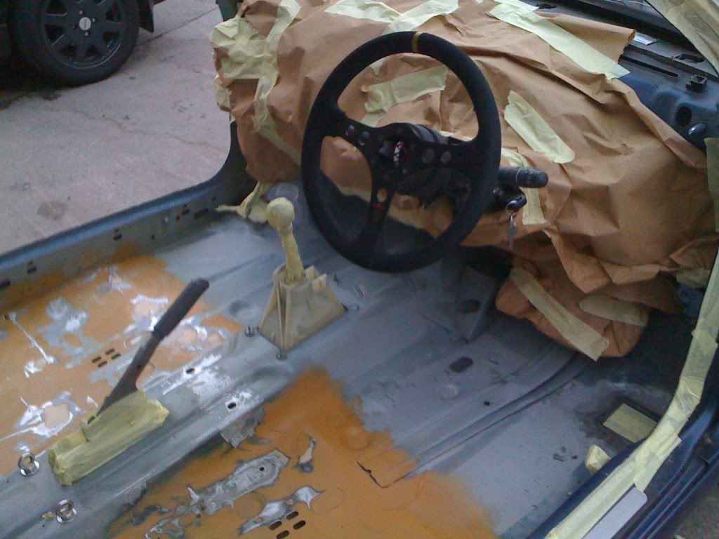

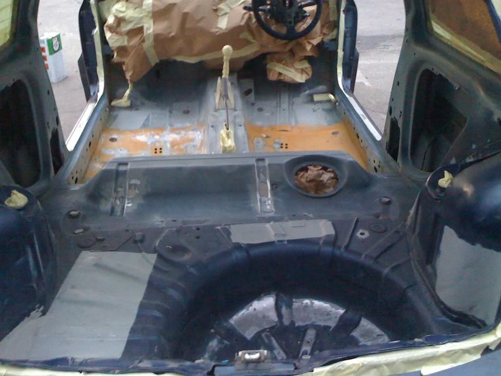

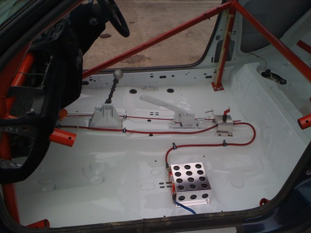

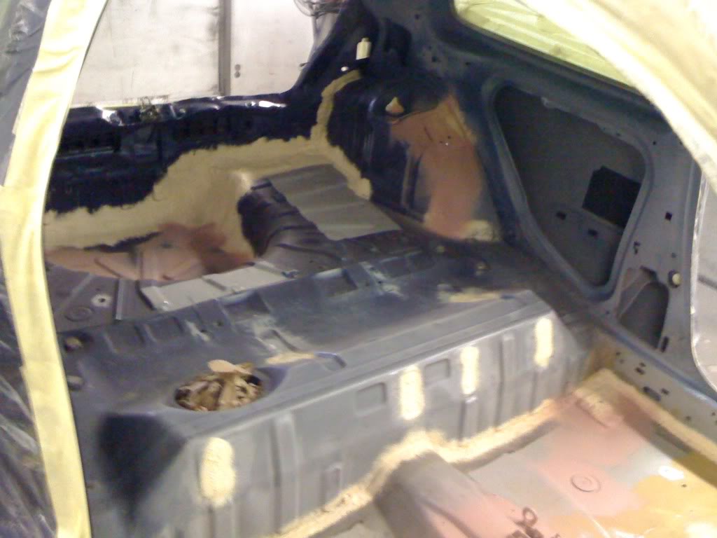

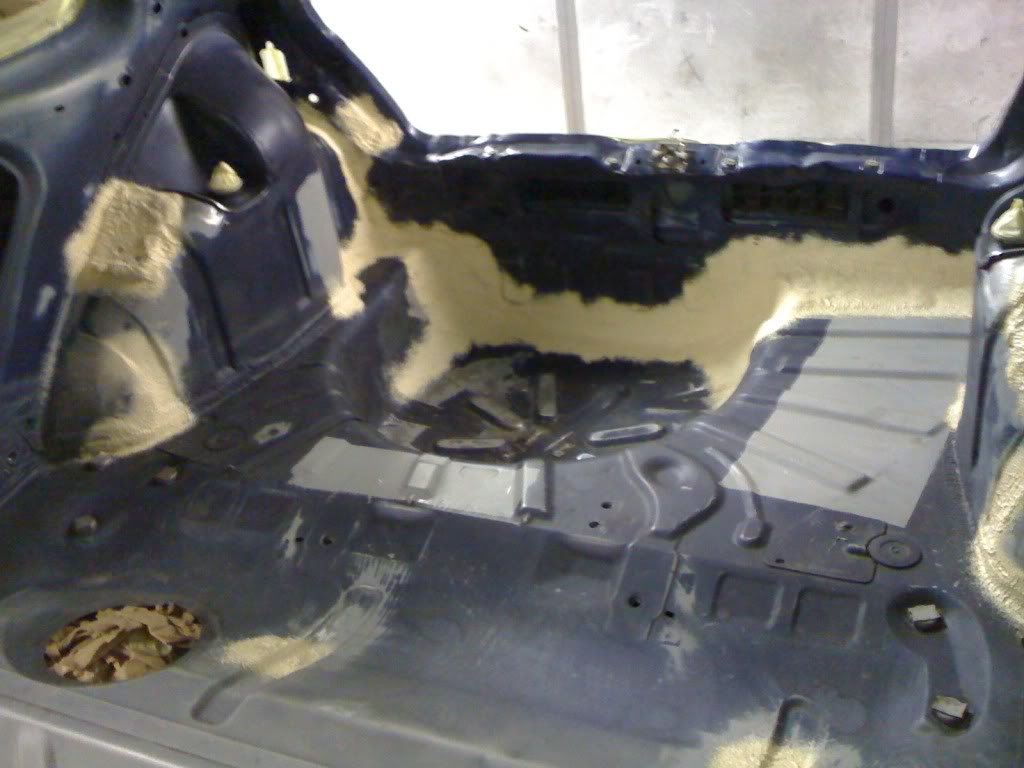

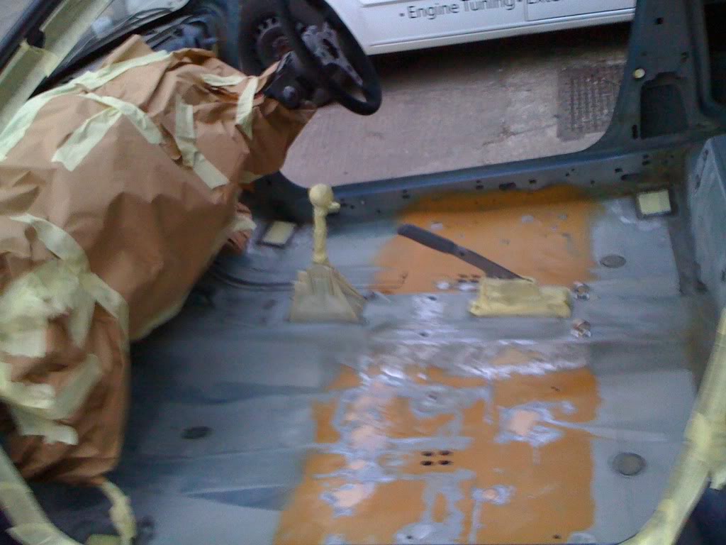

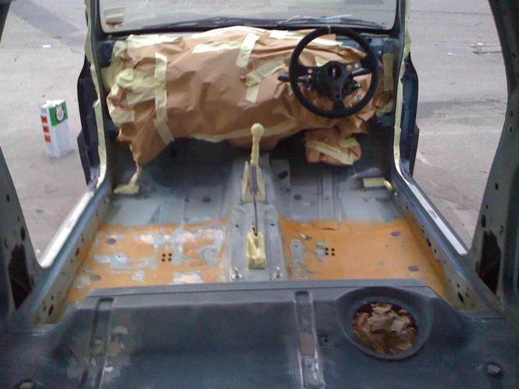

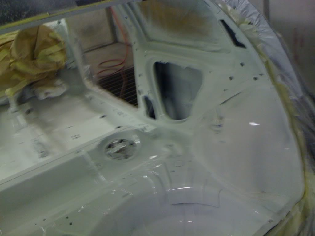

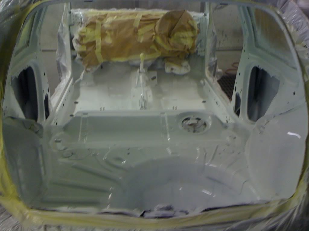

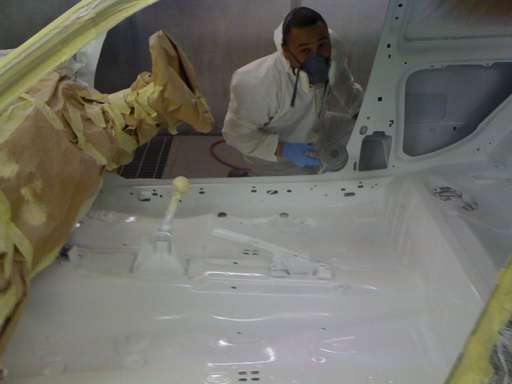

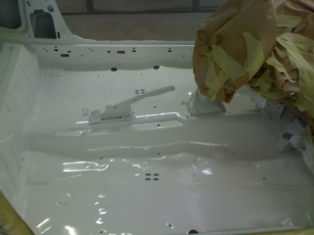

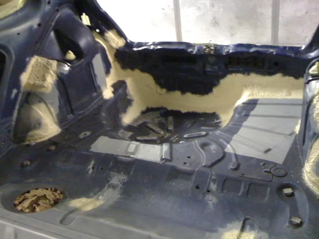

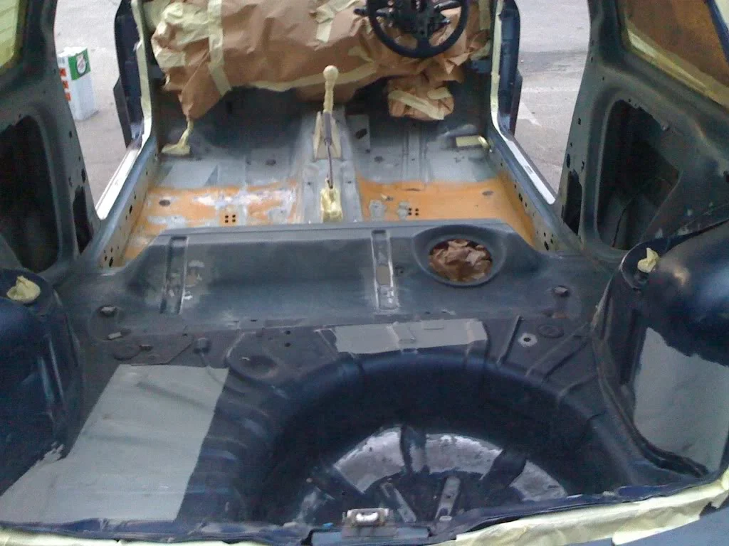

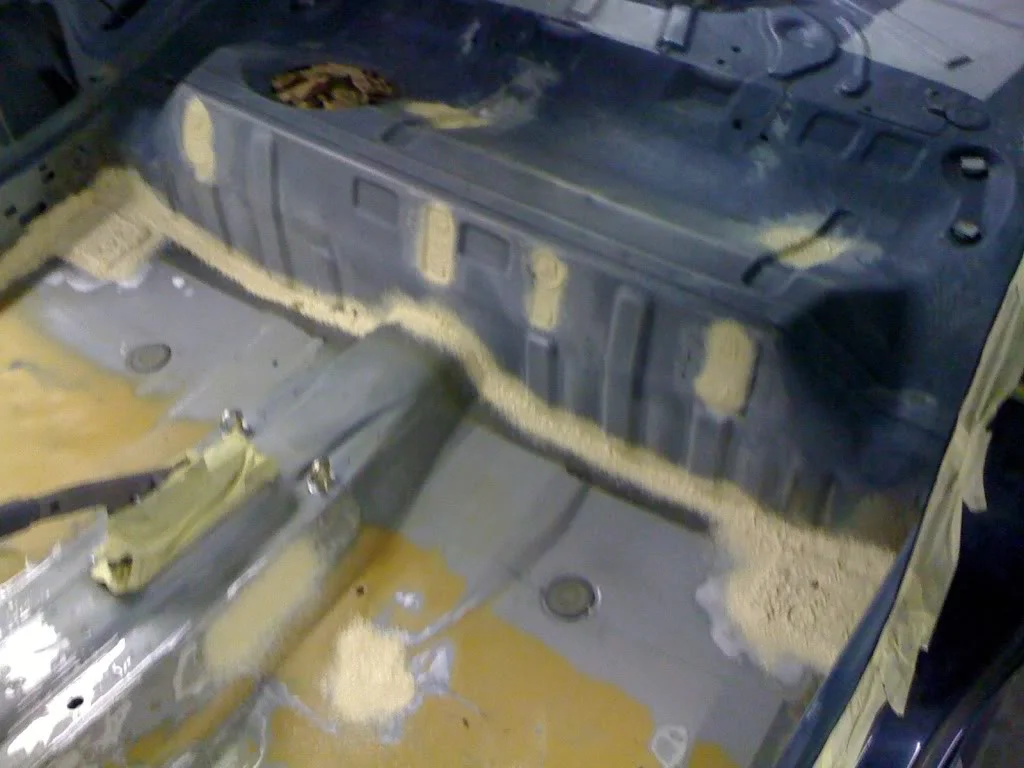

after the cage had dried i wrapped it up in bubble wrap and stored it well out the way and got started with preparing the inside for paint.

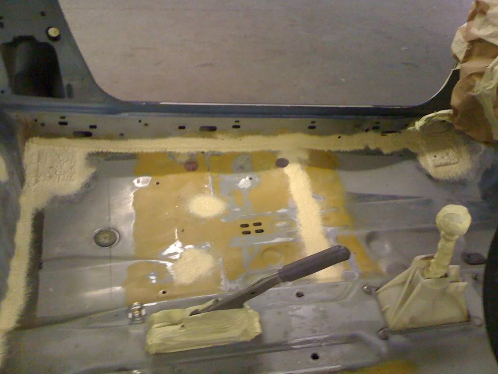

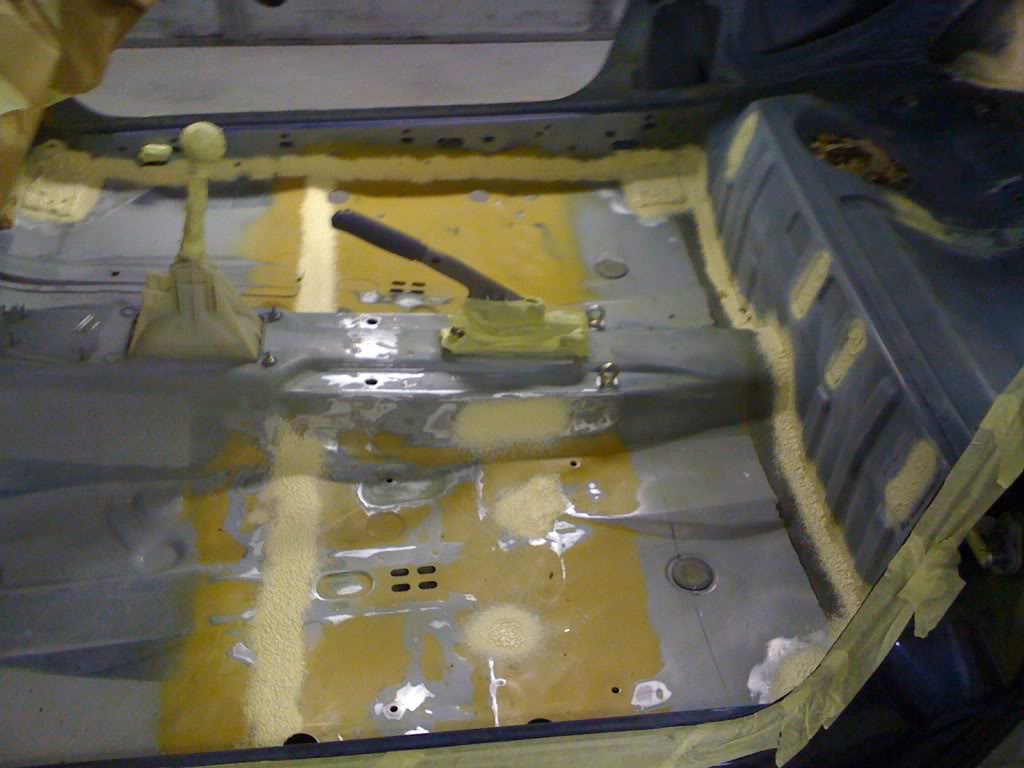

had to put some filler where id drilled a bit far on some of the spot welds, also i prepared it for the seam sealer ( its great stuff and hides a multitude of sins ie the creases in the boot floor)
then after the seem sealer :)
  e91 330d/type r mini

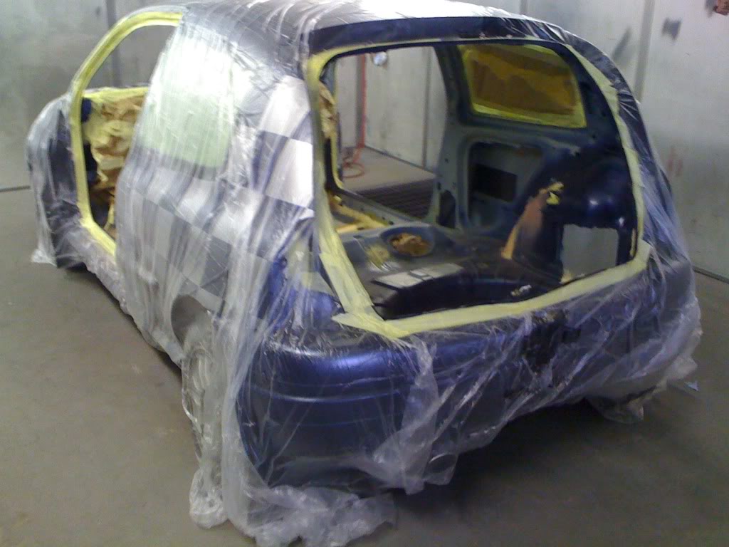

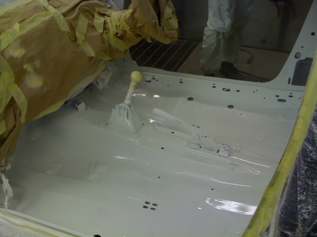

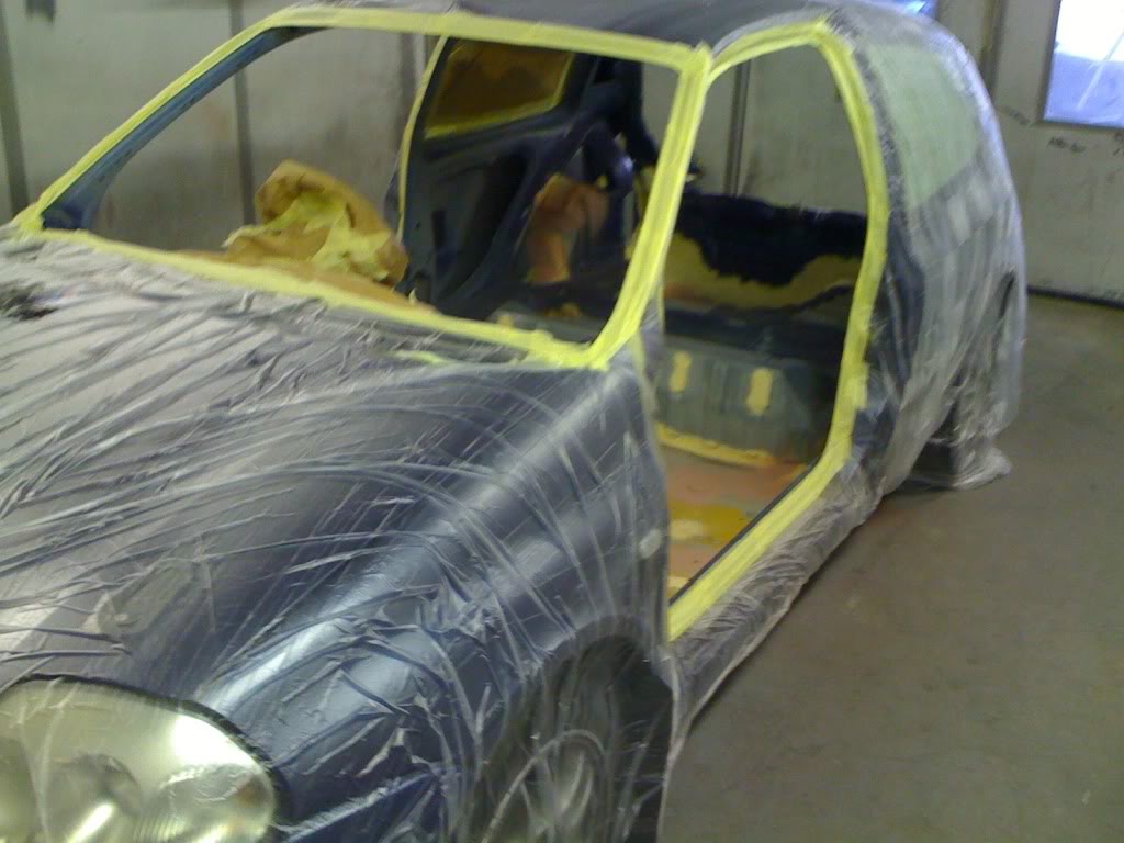

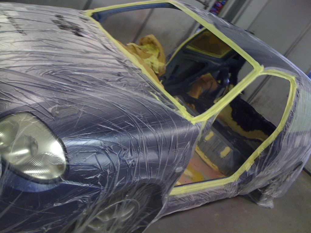

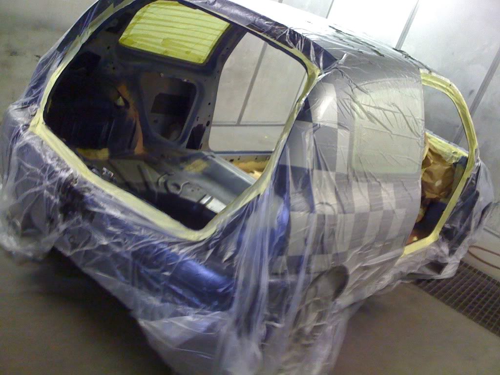

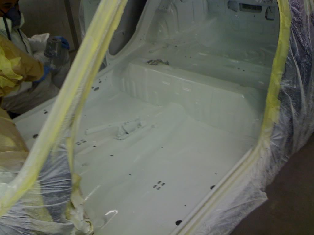

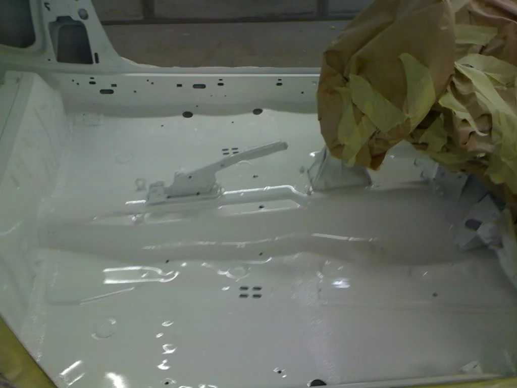

then we got it all masked up for paint and cleaned it and degreased it for about the 10th time lol
then the paint went on :D:D:D:D:D:D:D

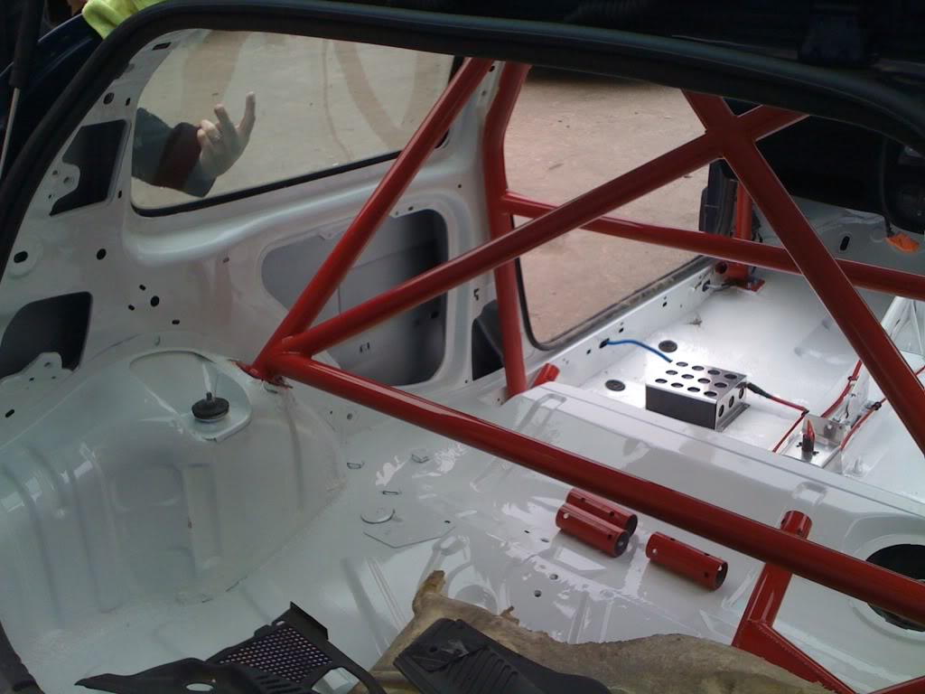

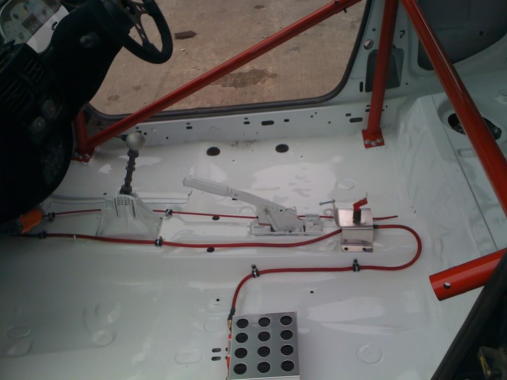

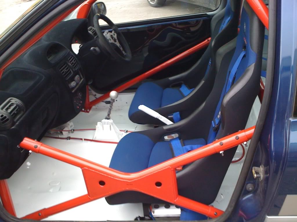

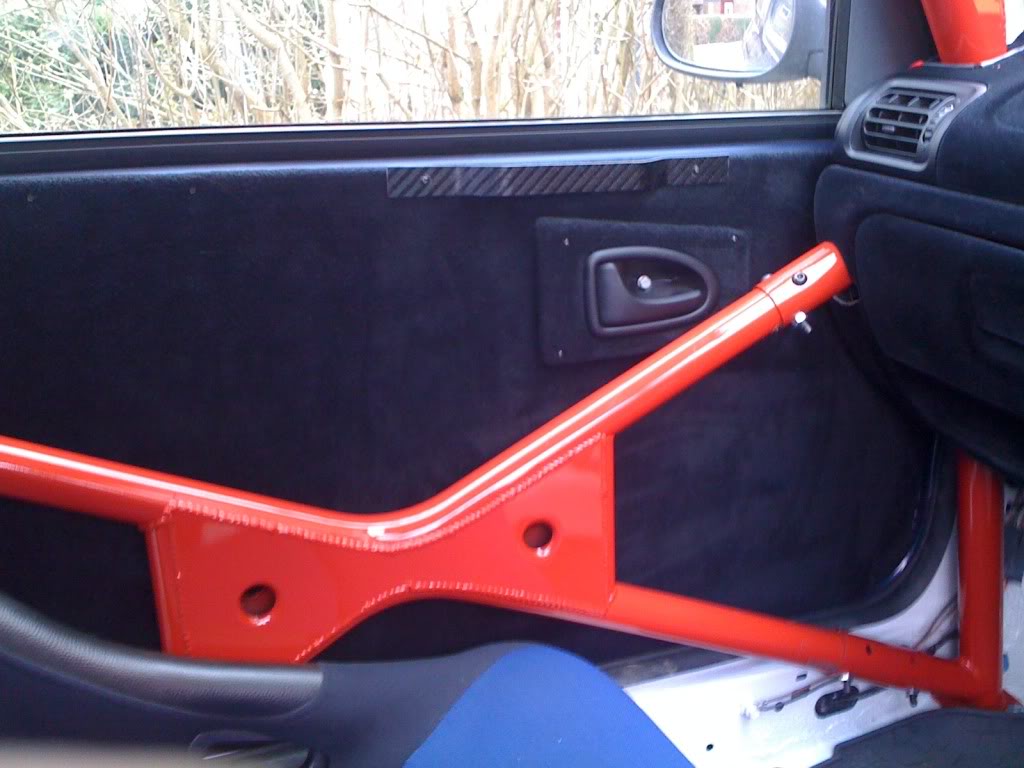

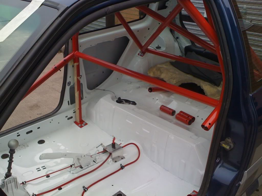

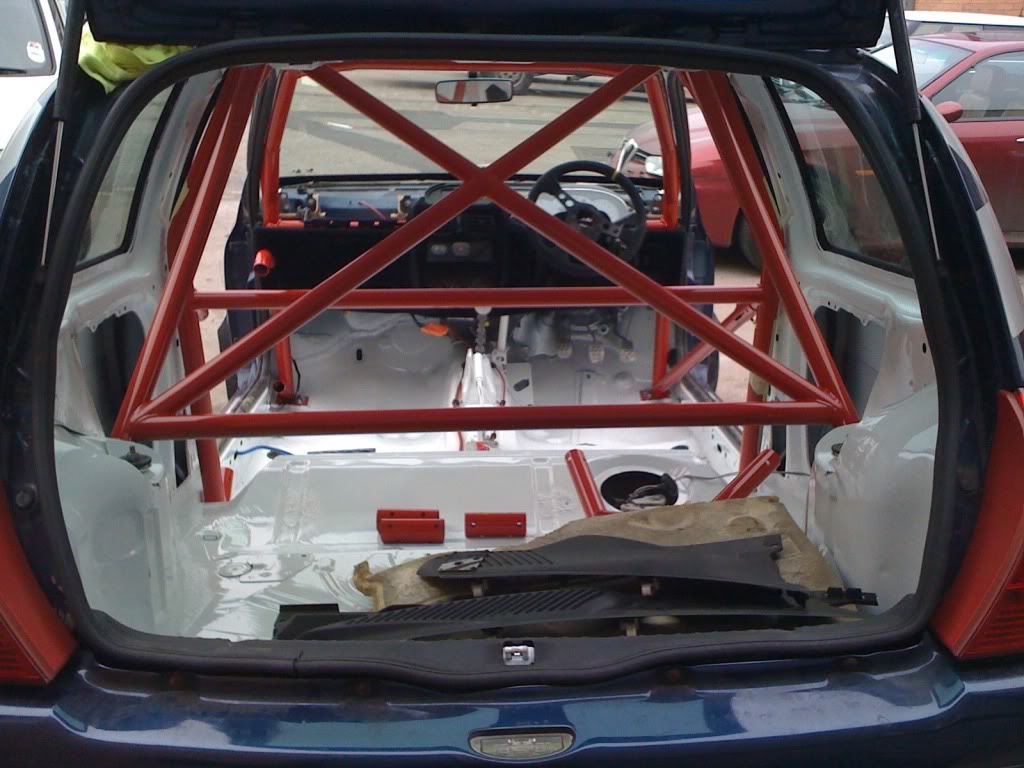

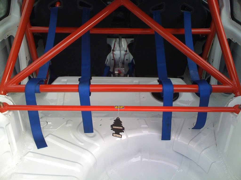

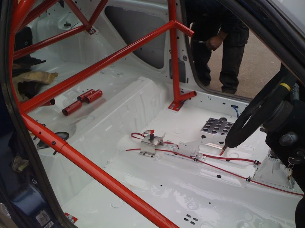

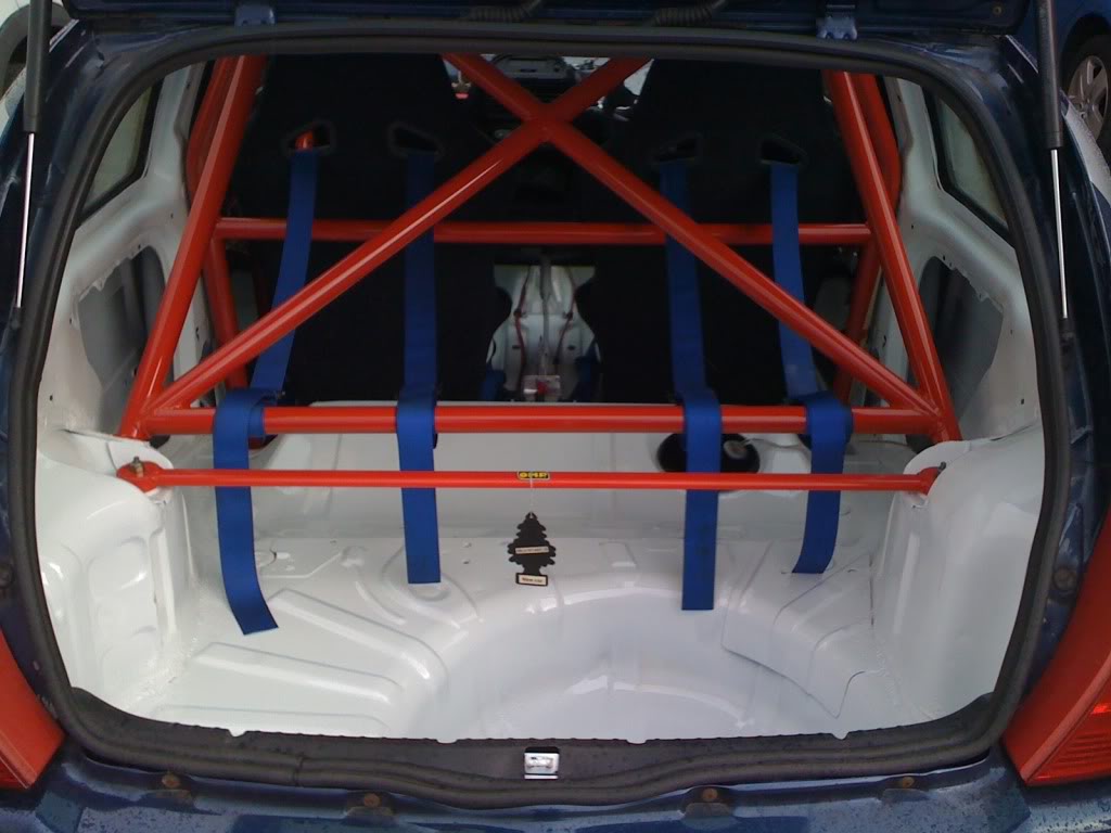

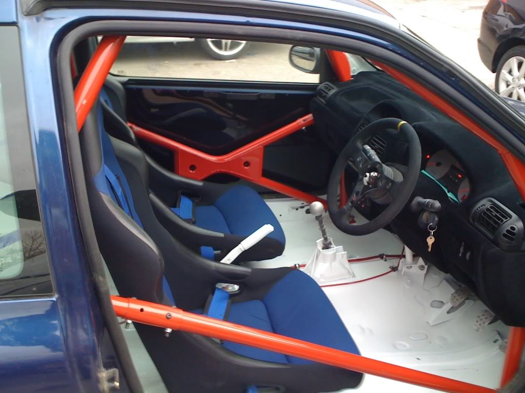

next day after the paint had dried we dug the cage out and started fitting it:(
what a frickin job that was 3 of us lifitng it in and still managed to scratch it in a few places (nothing a litle local cannot sort)
after that i put in the new lightweight oddysey battery (thanks burp :))
and put in the cable along with the cutoff switch.

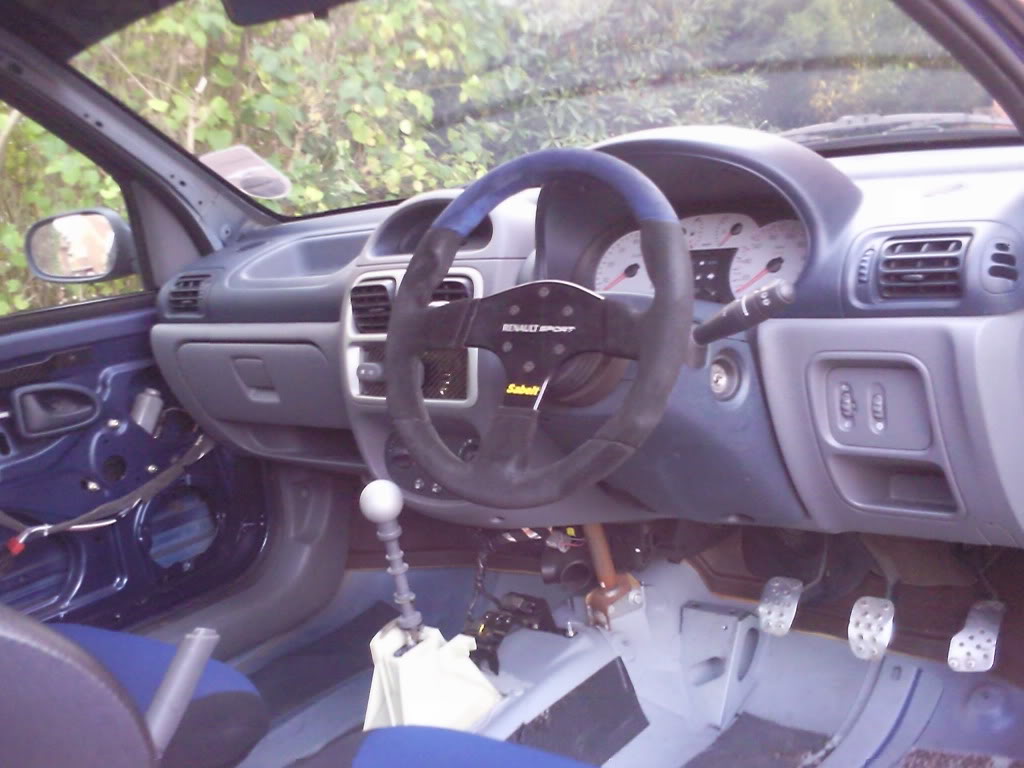

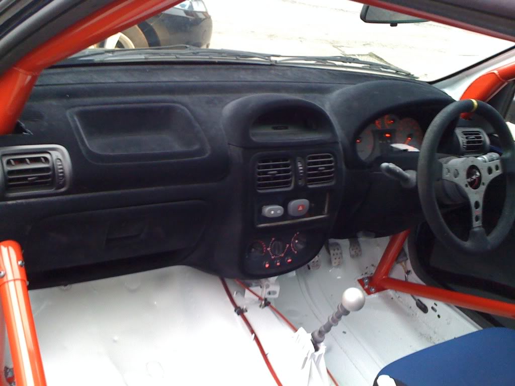

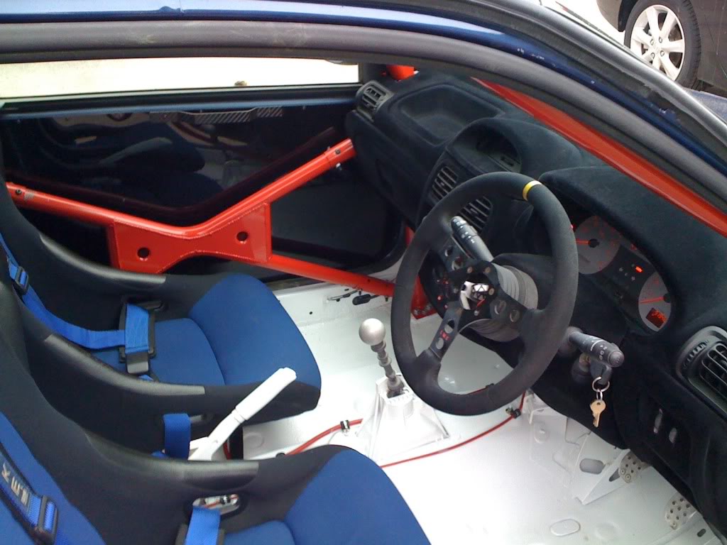

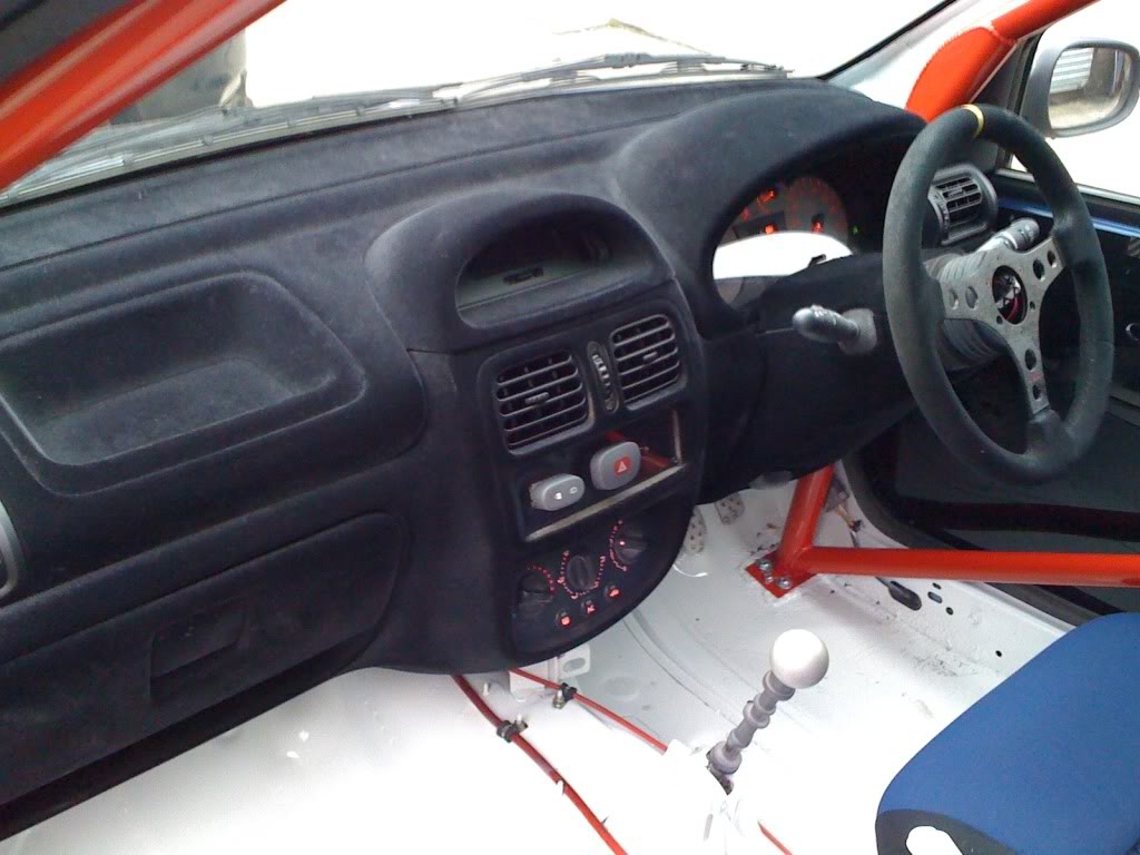

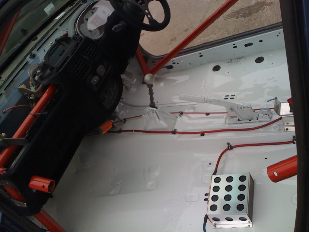

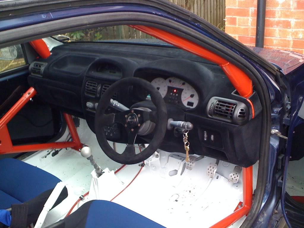

then came he job of refitting the dash bottom, time to see if all my measuring and cutting and grinding has worked (fingrers crossed )
IT FITTED YEY :D:D:D:D

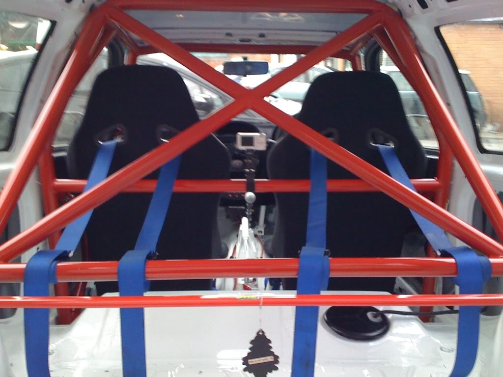

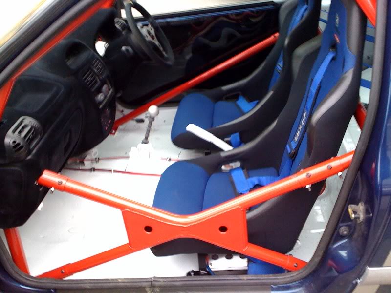

then i set about fitting the seats and harnesess
and then the hard bit fitting the dash top to go round the cage,
i seriously hought it was going to snap when we were bending it, rowan at SPRAYFIX did the measuring and cutting to perfection as i was just sure i was going to do it wrong lol
she is back together and seemed like one hell of a long road but i think it has been worth it :)

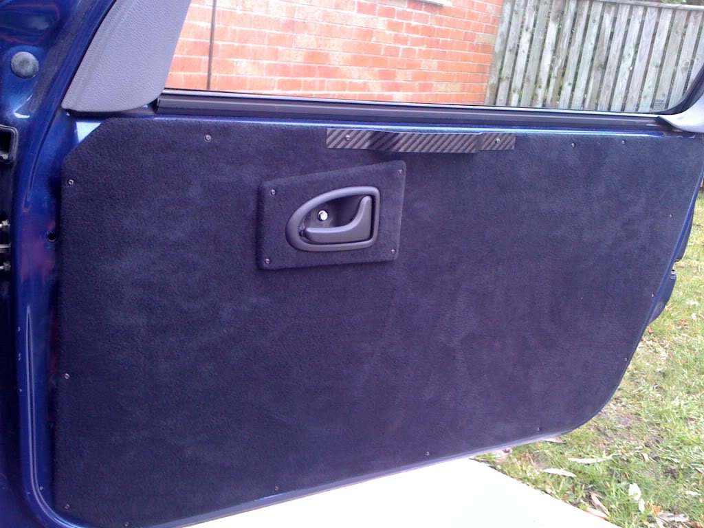

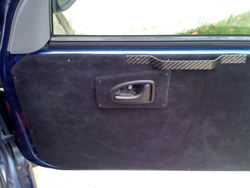

managed to get a few pics of the front door cards that i made,
i made the out of 3mm mdf and covered them with some suede material i had.
also had to make some spacers for the handles as hey dont sit flush without them.
i also got the pro race 1s fitted, they do have the wrong size tyre on but that will be changed for my slicks then these will be used for trackdays only :)

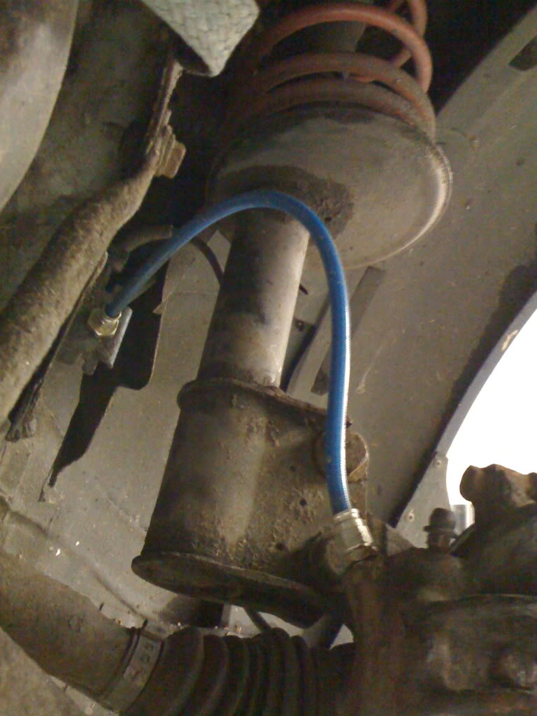

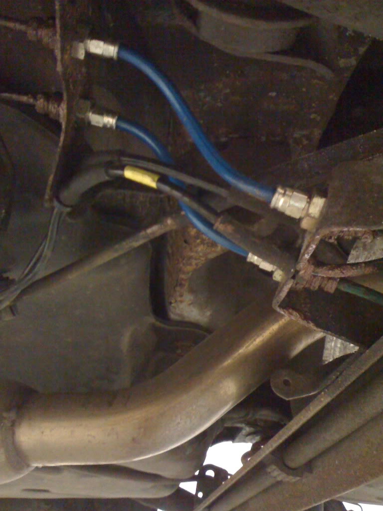

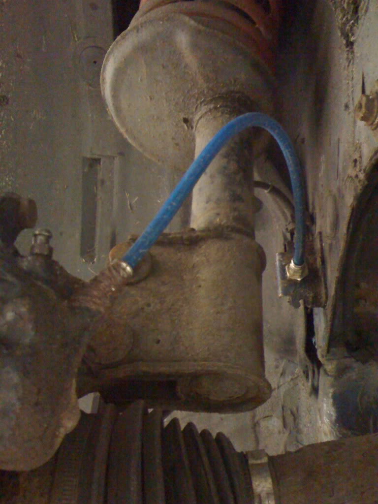

a little update i have had the braided brake lines fitted and new fluid flushed through again just to be sure
pedal definately fulls a bit more solid now, the old rubber flexis must of been a bit tired and past there sell buy date :)
