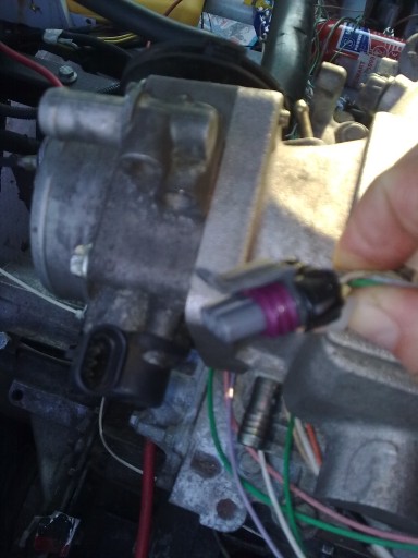

Phase1 172 3pin connector on throttle body and alternator help
  RB 182
Does anyone know where I can buy it with the pins or what to ask for at Renault as they're usually funny if I'm either not precise or have the chassis number

so I can just ask for a throttle position sensor plug at renault? will they sell me just a plug? - thanks for the help

I doubt it, they will try and sell you the whole loom. best try a breakers, a lot of Renaults use that same plug.

You should be able to buy the marelli plug for the stock TPS. Maybe not from renault but should be doable.
