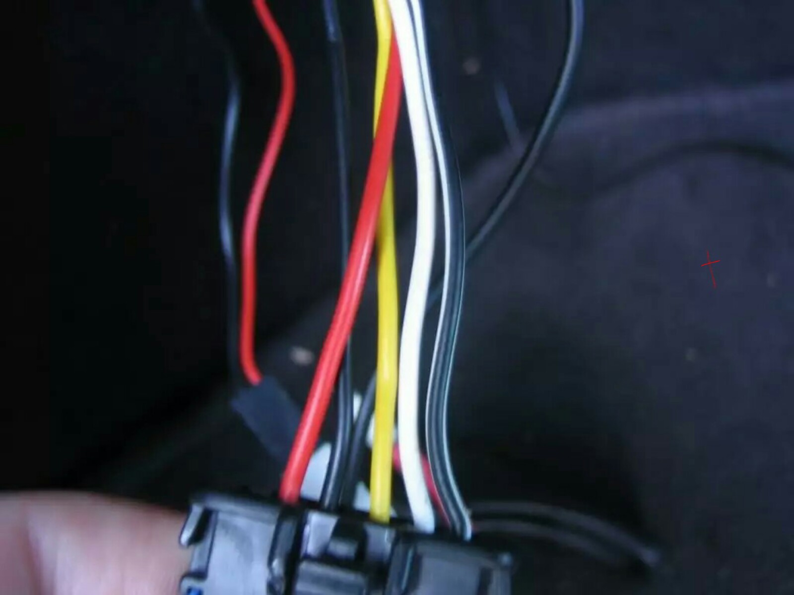

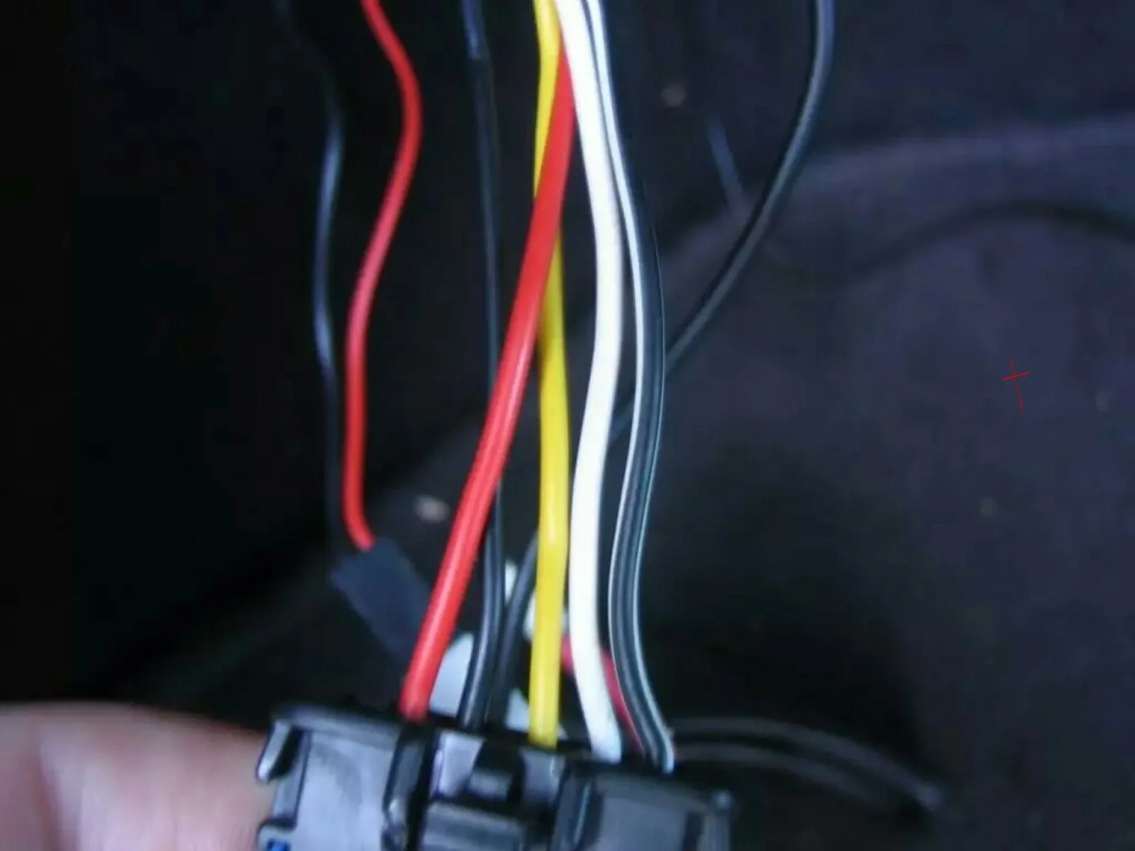

I had a look today at the wires for the alarm and traced them back to behind the centre console, removed the radio and found a few wires that had been cut and taped up and 2 wired soldered to the radio wires, one soldered to the door lock button and one soldered to the hazard button. I have no idea where the cut wires are supposed to wire in to, weird.
  182

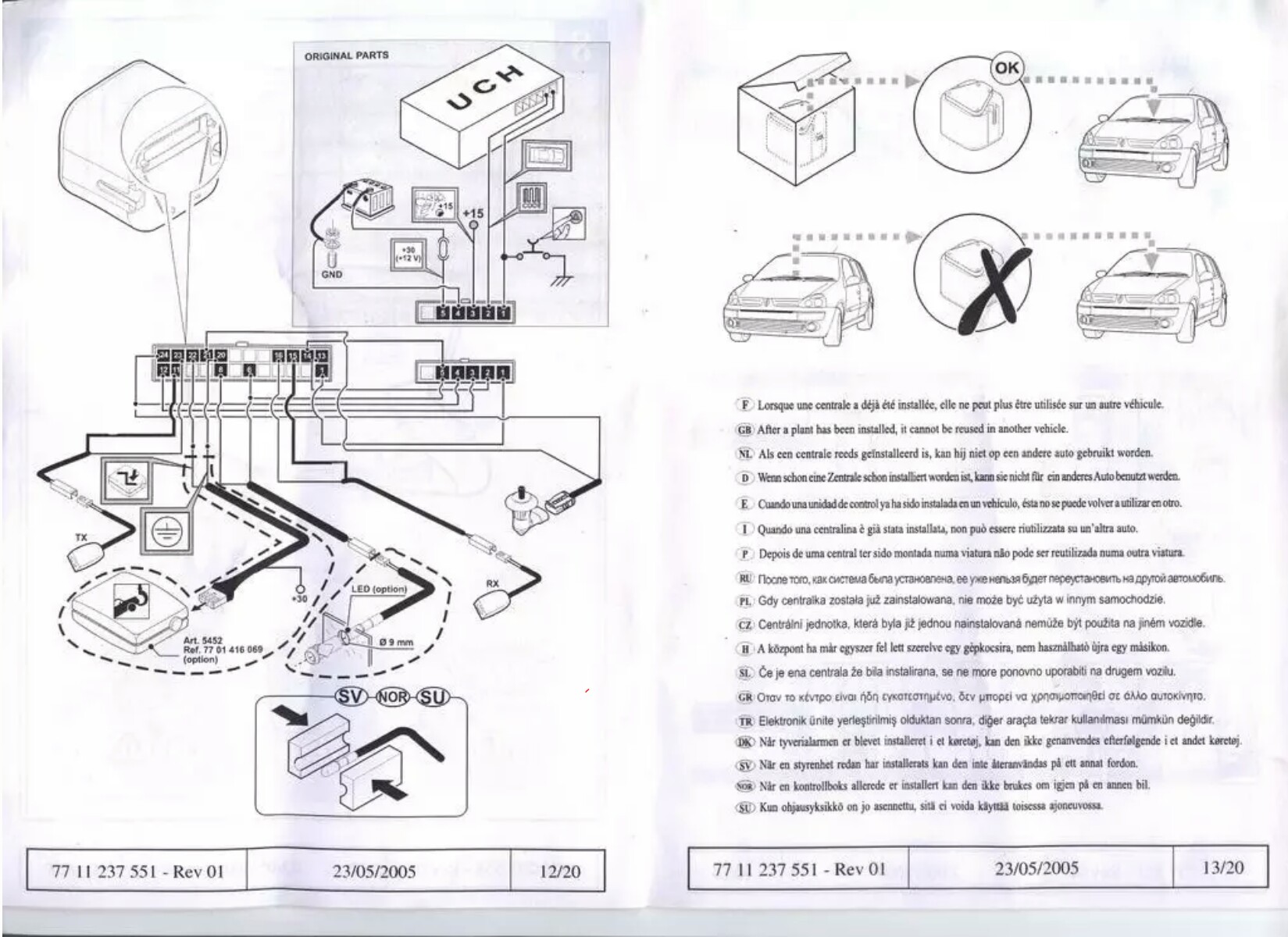

So the alarm black/white goes to the 2 green wires.
Alarm white goes to the 2 brown wires.
Alarm yellow goes to yellow/brown wire.
Alarm black goes to black/brown wire.
Alarm red goes to red/brown wire.

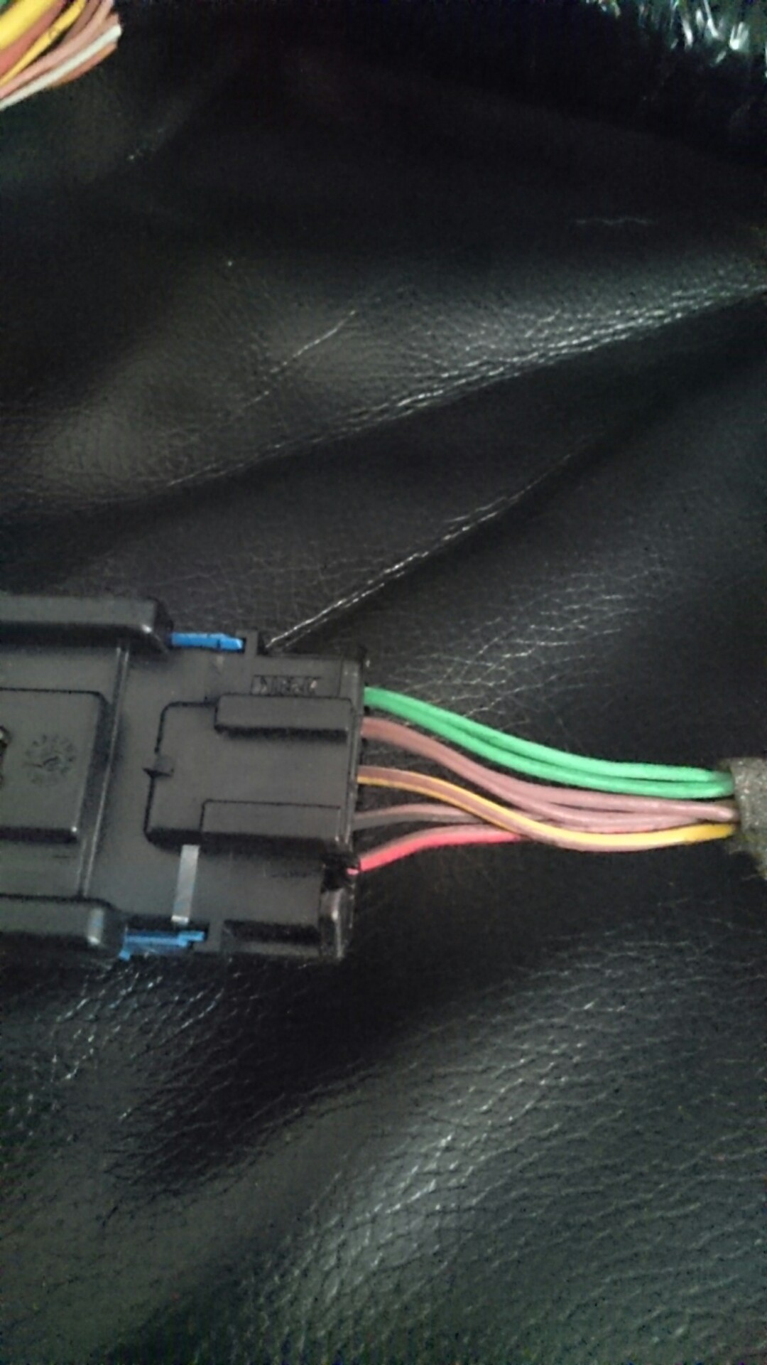

Now i've traced these wires back in the spare loom i have and this is what ive got.
Green wires: 1 runs off to hazard switch(green wire) and the other to the uch green connector(pin29)
Brown wires: 1 runs off to auto lock button(brown wire) and other to uch brown connector(pin15)
Yellow/brown: runs to fusebox s7 15A
Black/brown: ground
Red/brown: runs to fusebox s29 20A
Check the wires you have connected already to see if they correspond with above.

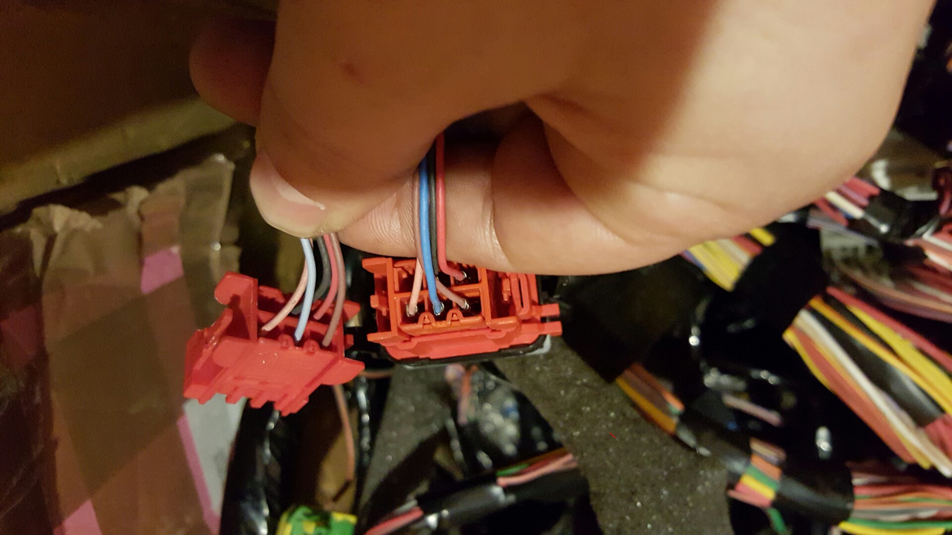

What i can do is post a picture of the wires going into the back of the lock button so you can see if they correspond with yours.
If i was you i'd do a continuity test on the alarm wires just to confirm where they go and see if it matches the alarm info above.
  182
The 2 red plugs are both the lock button plugs but on 2 different looms and shows the slight difference in wire colours.
I also noted down what pin goes where.
A1:Empty
A2:Black
A3:Red
B1: Pink
B2:Blue
B3:Brown
