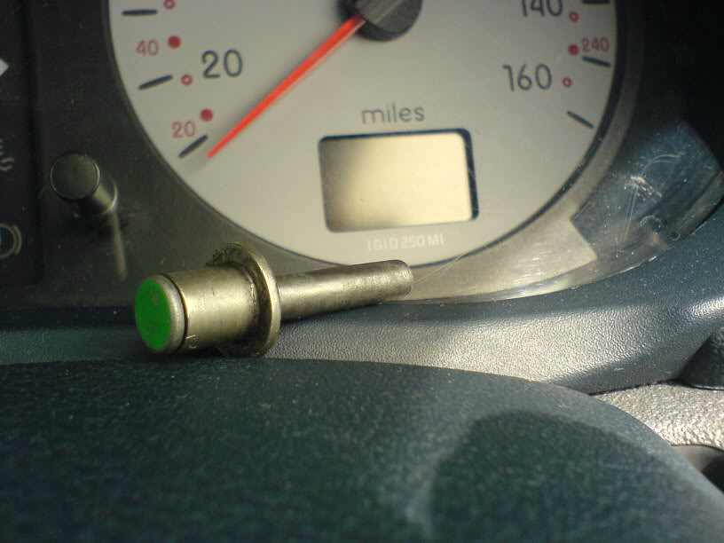

I have some sort of bolt in my glovebox that I found lying in the car somewhere I'll pop a pick up later to see if thats it, if not I'll have hoovered it up!
  Monaco Blue Mk2

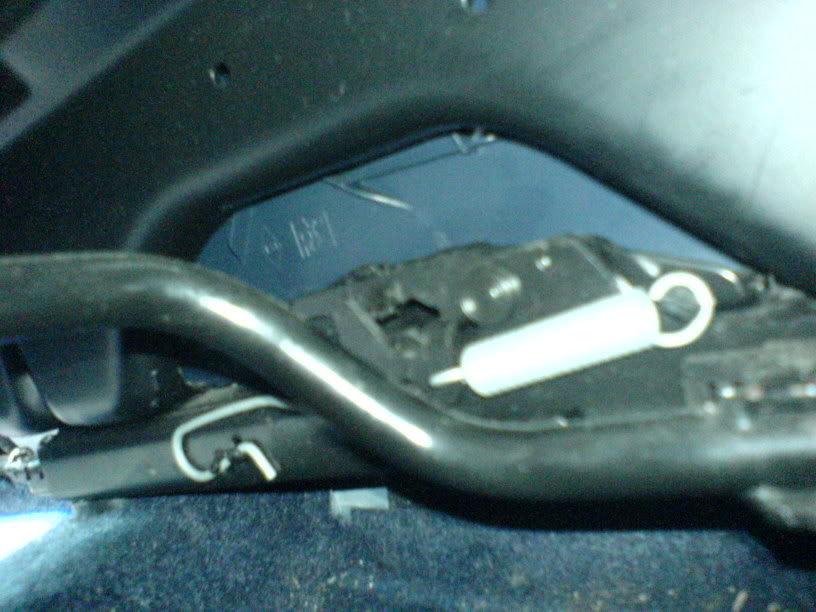

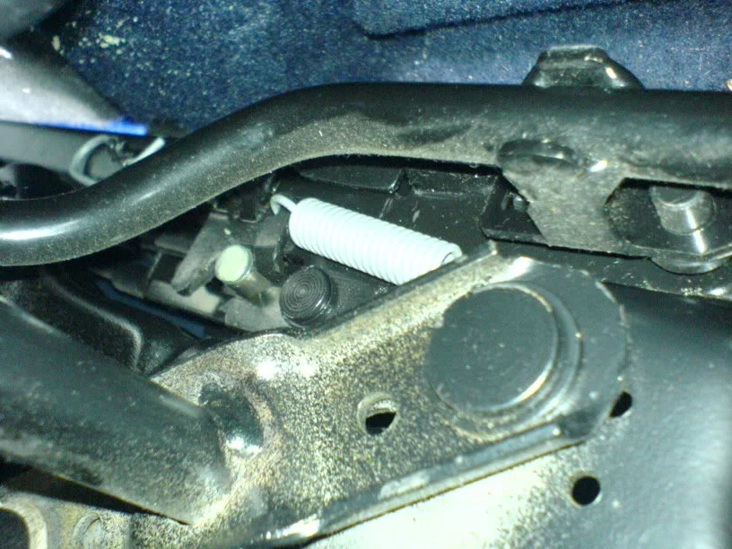

I think the bolt I found is the one from the seat, I had a look under the driver seat and found a similar looking one, went round to the passenger side to look in the same place...no bolt!

This is the bolt I found,
This is the driver side, bolt in place just after and below spring,
Passenger side, missing bolt :(

If Giles see's this, could you confirm that I have the right thing and the right place to put it. If so can I just push it in from under the seat or do I have to take the plastic cover off by the handle to get into the back? If that has to come off, how does it come off, lol! Thanks.
