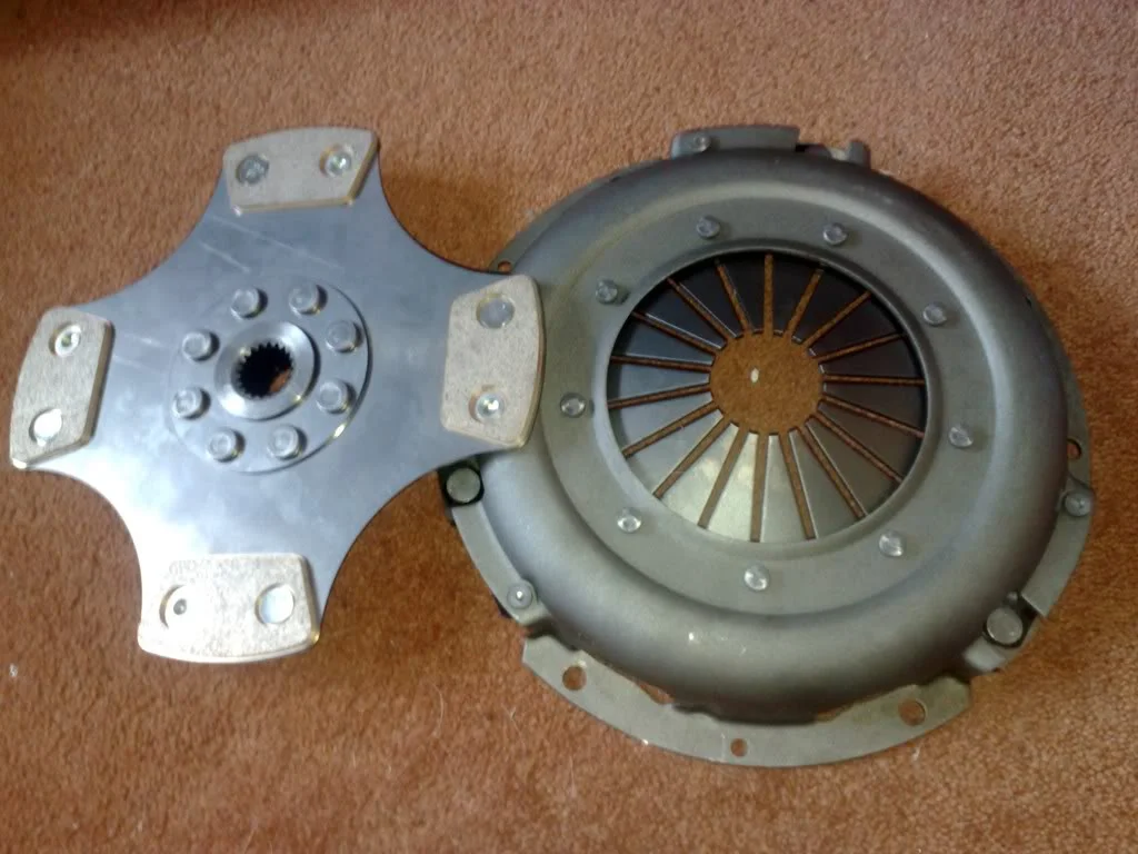

    Seeing as the standard 197 clutch doesnt cope well with the extra +60bl/ft of the car and how its used on the strip alot, i've gone about ordering a more manly setup.
    Very little avaliable for the 197 so had Helix make a custom clutch through a retailer for my needs, only problem is its a 4 paddle cerametallic clutch with uprated pressure plate.
    Been doing some reserach and although im obviously expecting some sacrifice in driving comfort/ease i've heard alot of horror stories that the car will be undrivable and destroy the whole experience due to its on/off feel.
    Has anybody had any personal experiences with clutches of this sort and road driving? Fact not fiction please. Will it be an utter nightmare around town? Will it kill my engine mounts? And will it destroy my gearbox internals early?
    Thanks.

    I once had a skyline (we're talking 5 years ago + mind you) and that had a paddle clutch.
    Honestly, it made me hate the car. In traffic I was s**t scared of launching at mach 10 straight into the car in front. You needed a minimum of 2000 rpm and a flat out start just to get moving. It made getting off the drive interesting. Especially on the gravel....
    Awful for road use. Just awful.

    Paddle clutches are truely horrible, when ever I get caught up in slow moving traffic I feel like just pulling over and burning my car out.
    There is literally 2mm of pedal travel from fully disengaged to fully engaged, and every single person who drives my car stalls it.
    If you can avoid one I would.

    Hated mine! Its on off as you say, very difficult/impossible to do a nice hill start, i had to rev and just boot it off.
    Worst thing i bought, and was totally unneccessary for my needs.
    It sounds cool, "running a paddle clutch" but id rather punch myself in the face.
    Mine was an un sprung one as well :worried:

    I have a Helix sprung 4 paddle clutch in mine, and it is no problem at all. other people have driven it too and never had any problems either. I had heard of horror stories, but don't believe everything you read.
    If you wanna try my clutch, you are welcome to...............

    I can't stand paddle clutches, and I've time and again proven that for road use a stronger cover plate is the way to go. Only real need for a paddle is under hard use for serious motorsport, and even then it should be with the knowledge that your flywheel and pressure plate will get eaten (that's why they get lighter with use.....they're doing less). I've had a paddle clutch ruin a flywheel in 3k by munching its way into it, leaving me with a 3mm deep groove in my flywheel.

    Sorry Danny but it must have been fitted wrong then, because my paddle has done 10k, and there's not a spot of wear on it anywhere, when i last had to take off to refit my flywheel correctly after it came loose! ( it was fitted by GDI)

    IF you can justify the requirement for an uprated clutch, then it is certainly liveable in a roadcar. Bear in mind i was running a standard clutch for 6 months with approx 220 bhp and 170 ftlbs and it was fine until i Santa podded it!
    And further to what other people put, no more hill starts sitting on the clutch, you will have to use the handbrake! :wink: and as for traffic, i learnt to leave a bigger gap, so i can trundle along in 1st at idle(ish) so as to not use the clutch.
