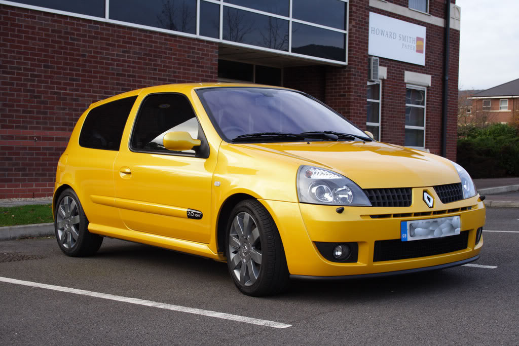

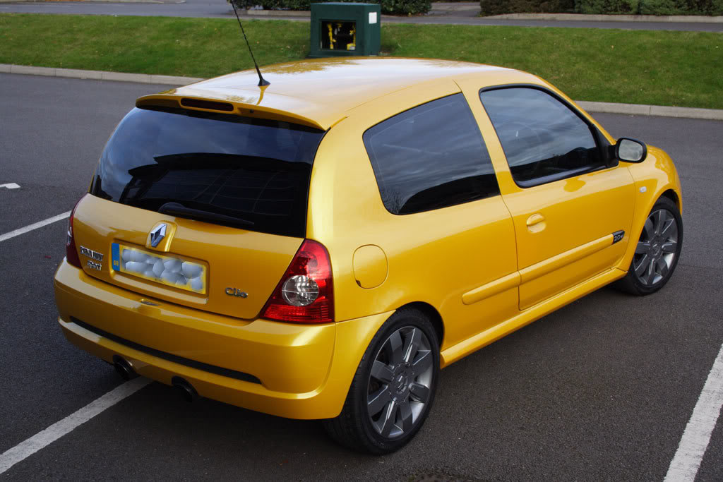

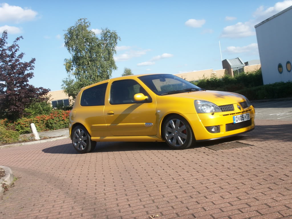

Anyway, after a good clean this is what she looked like

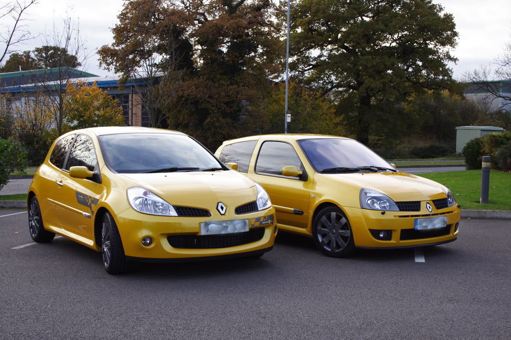

And one of it next to what was then our brand new R27

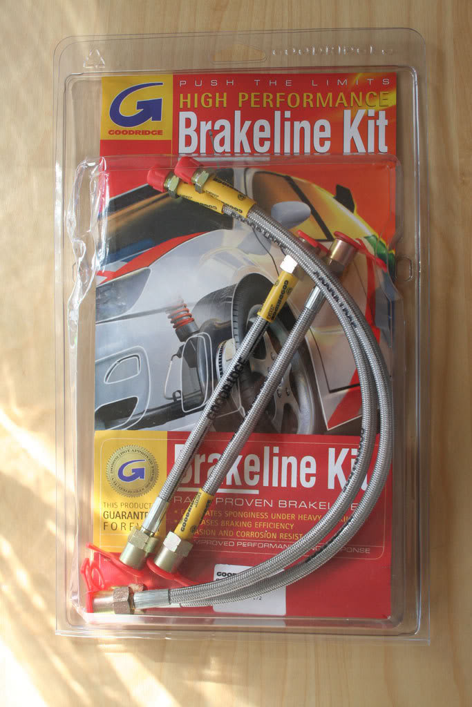

After a few months I needed to sort some new pads out so I thought I'd fitted a set of stainless braided lines at the same time.

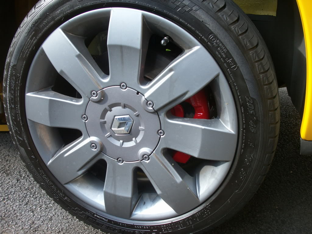

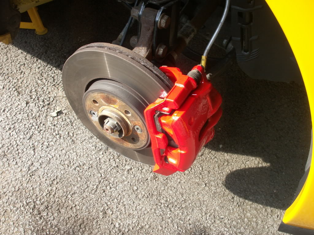

Given that I wanted both the Clio's to look a like I thought I'd paint the calipers, so I order some of that caliper paint stuff off the tinternet.

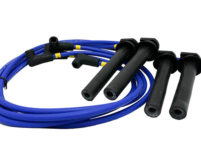

The car started acting up one morning and I tracked it down to a misfire in cylinder number 3. Turns out the lead had broken down and popped the coil pack. So after a new coil pack, new plugs and a set of Magnecore leads the problem was solved. There not too desimilar to these

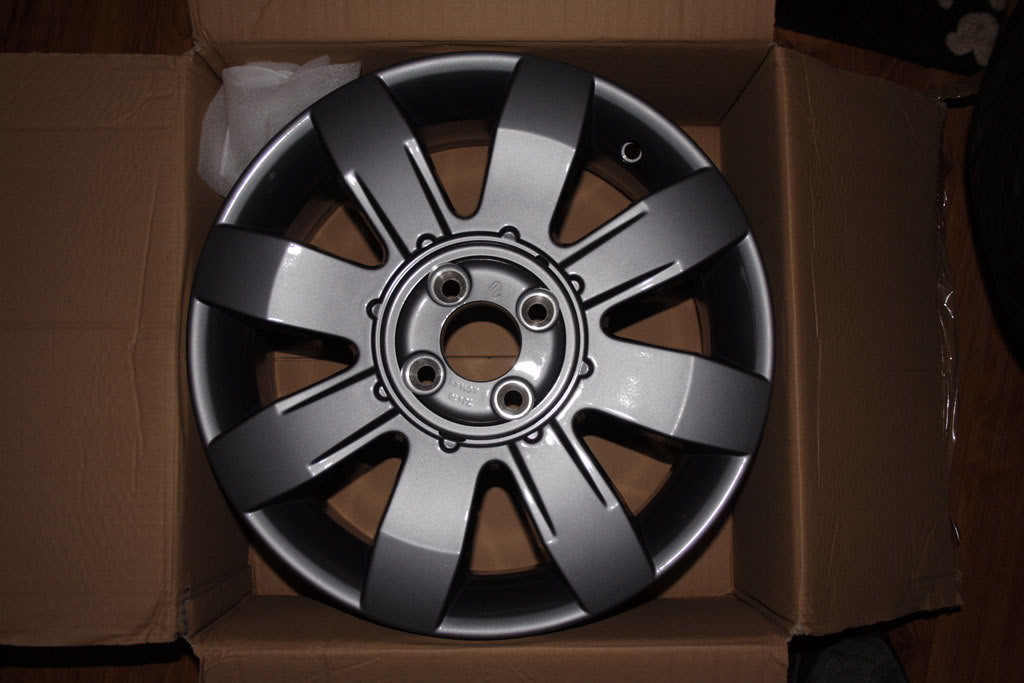

Next was a new wheel coz one of them had a bit of a scratch on it, so now I have a spare

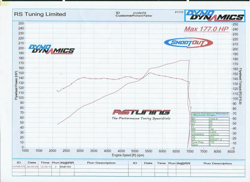

Just after it came out the bodyshop I went up to RS tuning for a rolling road day. I was well chuffed with the result to say the least especially for a standard car

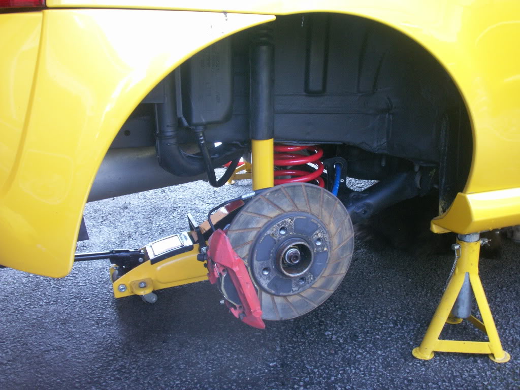

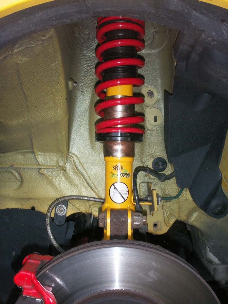

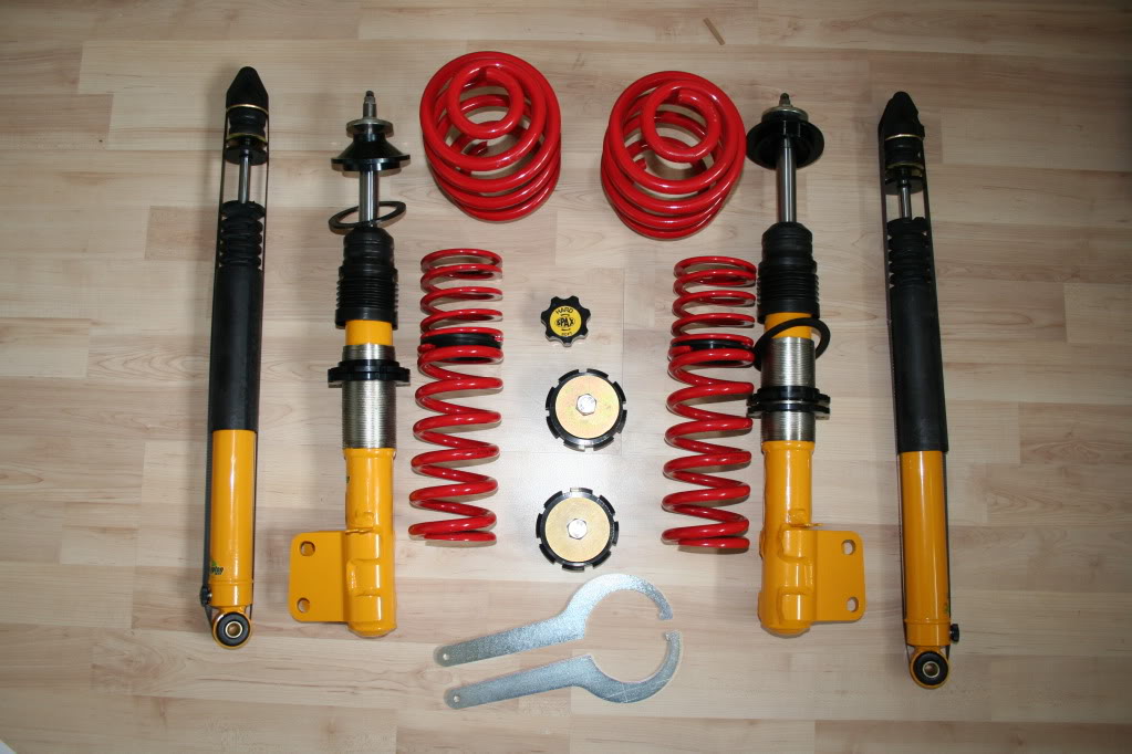

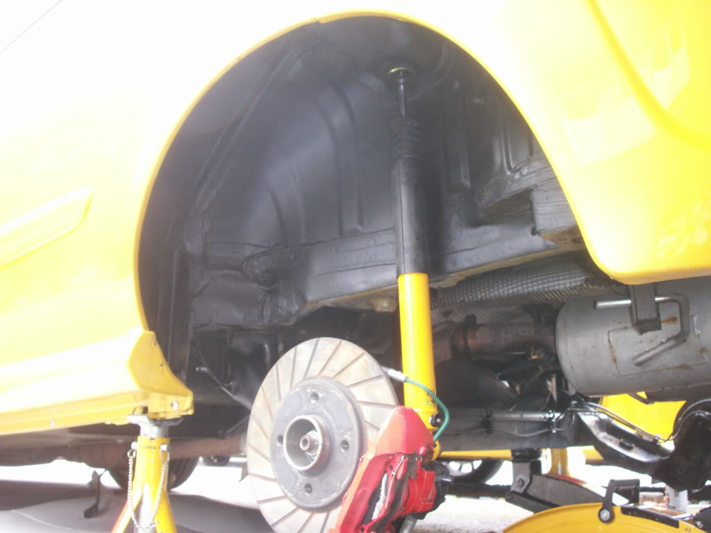

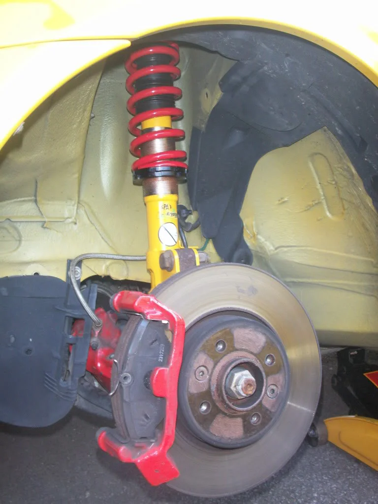

Things started getting a little more serious then. I wanted to replace the eibach lowering springs with coil overs as I found the ride a little crashy. It did prove a little difficult as the car has the cup suspension and I didn't want to spend £1300 plus. But after some discussions with the lads at work (I'm the engineering manager of a steel pressing company) and some stress analysis on my design software I ordered some Spax RSX and "tweaked" them to fit.
Fitted
While I was fitting the rears I replaced the handbrake cables and tarted the archs up

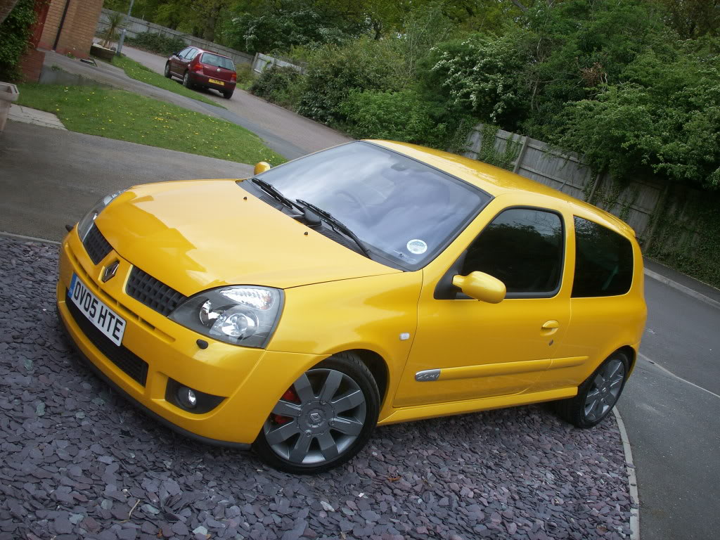

Some pics of the car once all done. The coilys are height and damper adjustable and its taken me a little while to get the settings just as I want them but I'm about there now. They have improved the handling and reduced the body roll, the area I've noticed the most difference though is the braking you can brake a lot harder now. They have taken a little getting used to but now I have they are great

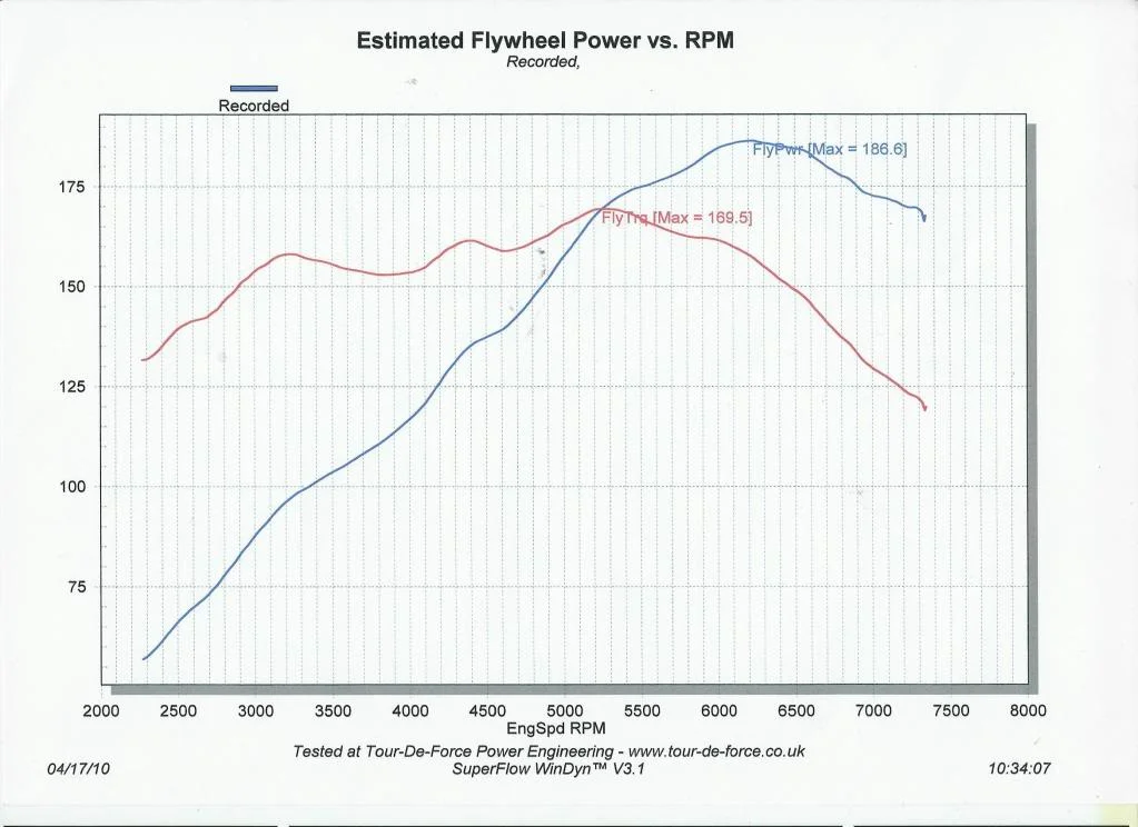

Next came another rolling road day, this time at Tour De Four. The result was withing 0.2bhp of RS Tunings result

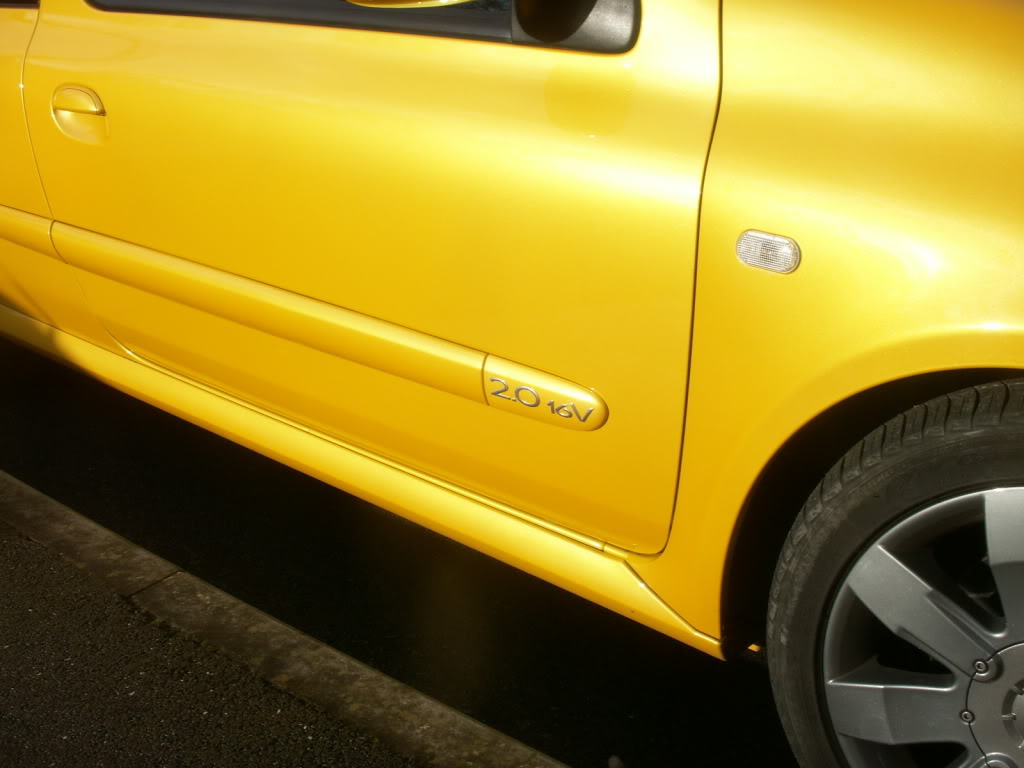

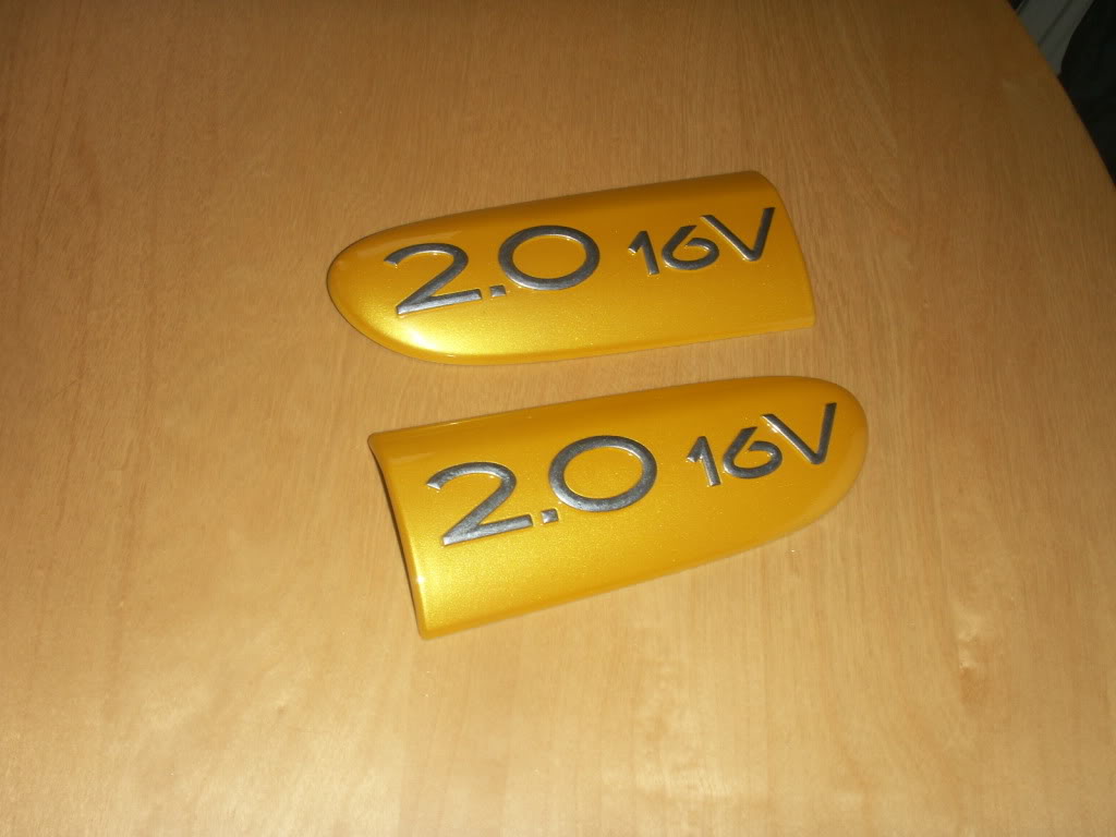

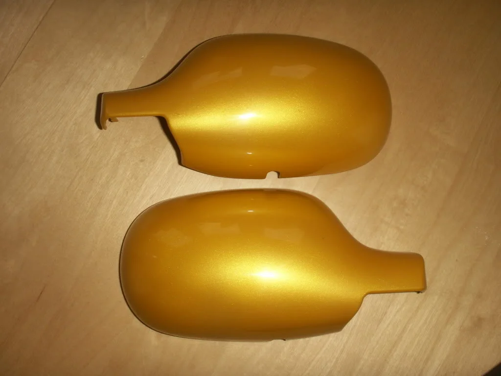

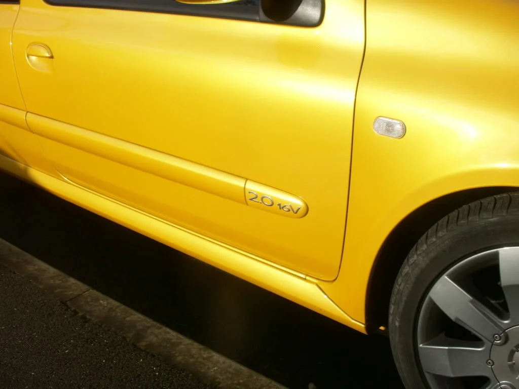

One of the things thats never looked right imo was the silver bullets on the car I wanted them in LY and the lettering to match the wheels. I sent them off to NATHJ on CS and this is what he sent back

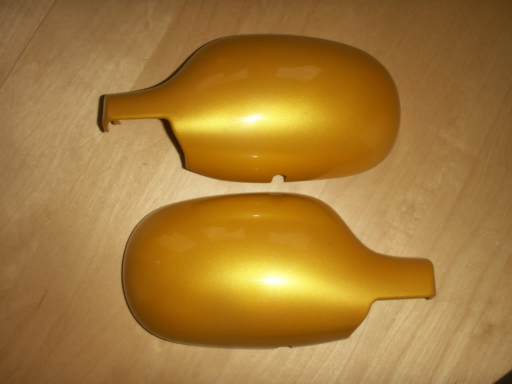

While I was at it I got the wing mirror caps redone
And this is how they look on the car

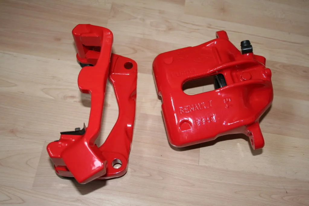

After regretting painting my calipers coz the paint chips easily I've brought another pair of front calipers which I'll smooth off and get powder coated at work Plus it need some new discs so I'm gonna cut a custome groove pattern into them before fitting.

I dont like the bullets :( all too yellow IMO, but other than that.. spot on :D

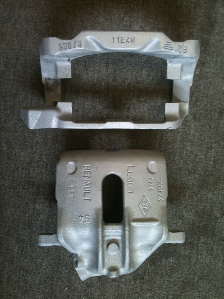

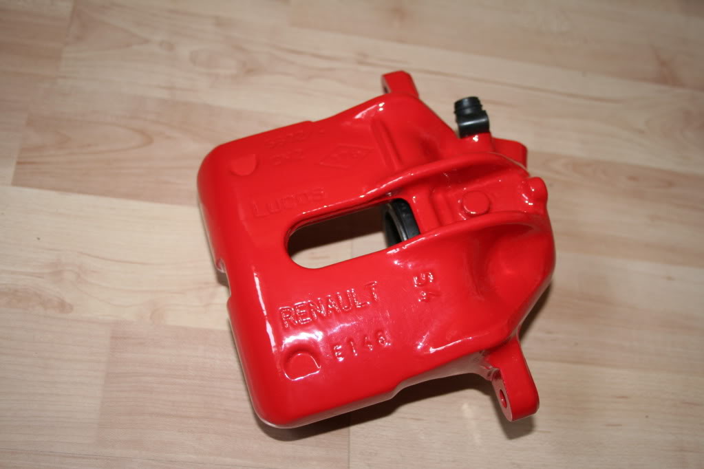

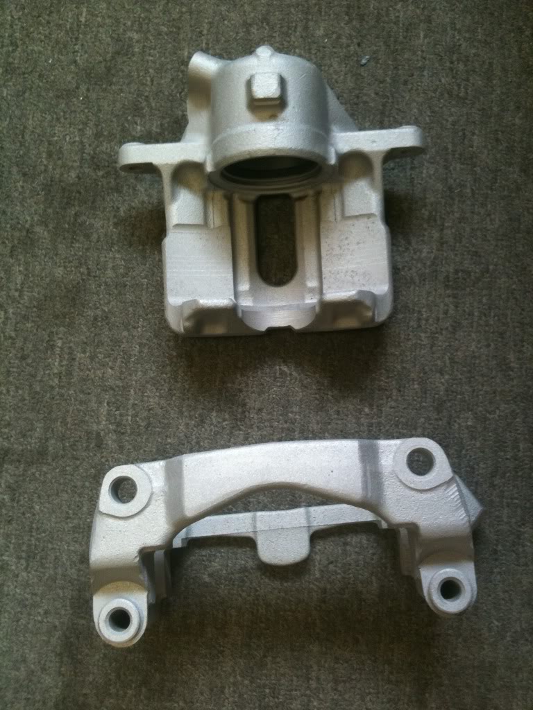

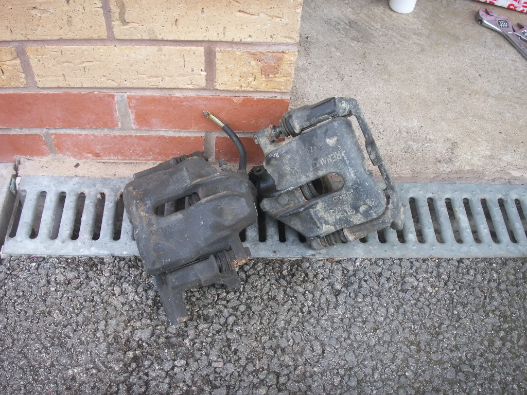

I've smoothed out the front calipers I brought off ebay, and got them bead blasted
Then I got them powder coated in red, and while they where in bits I thought it would be an idea to replace all the seal etc.

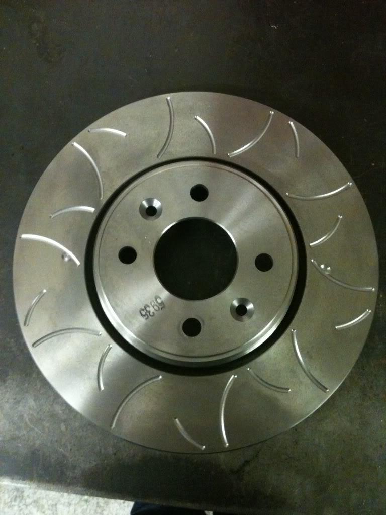

I got a set of ferrodo pads and Brembo discs, I'm going to groove the discs before fitting them, not decided on a pattern yet.

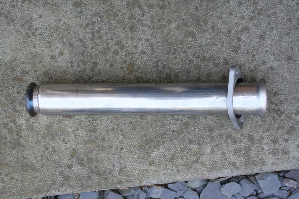

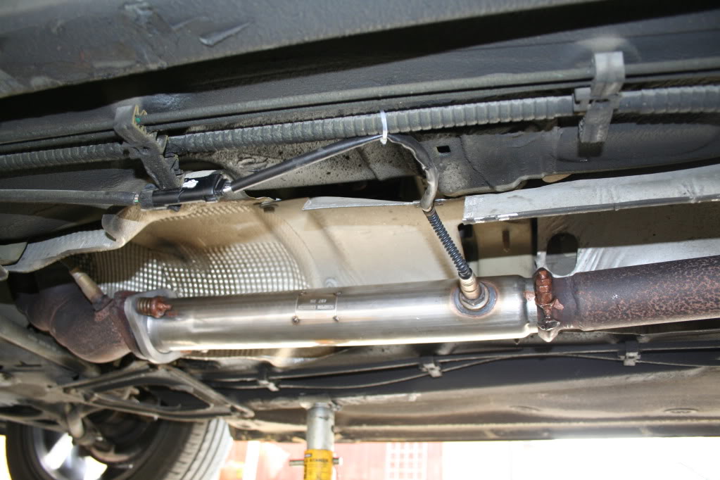

Then today I fitted my Scorpion decat pipe
I was expecting it to be a nightmare job given how rusting the bolts looked, but it came off pretty easily the only bit that was hard was getting the Lambda out the cat. A quick phone call to Fred @ BTM, a spanner and some precision swings with a lum hammer soon shifted though. All fitted
Went out for a blast and omg when your accelerating the noise is amazin, cant wait to get it through a tunnel ;)

Great looking car. When you said you 'tweeked' the front struts what exactly did you do??
LiquidRich
  LY R27
I took the front shocks to work and slotted the holes out, and opened up the gap between the 2 bits of steel. The cup hubs are 0.9mm thicker where they bolt onto the strutt so they wouldn't quite go on.
As I said I ran a stress test on the software I use at work and consulted all the lads I manage (who have about 150 years experience in metalwork between them). So I was and am confident they'll be fine. They've been on for a few months and they're still good :)

Got the new discs sorted, genuine Brembo's with and custom groove pattern :)

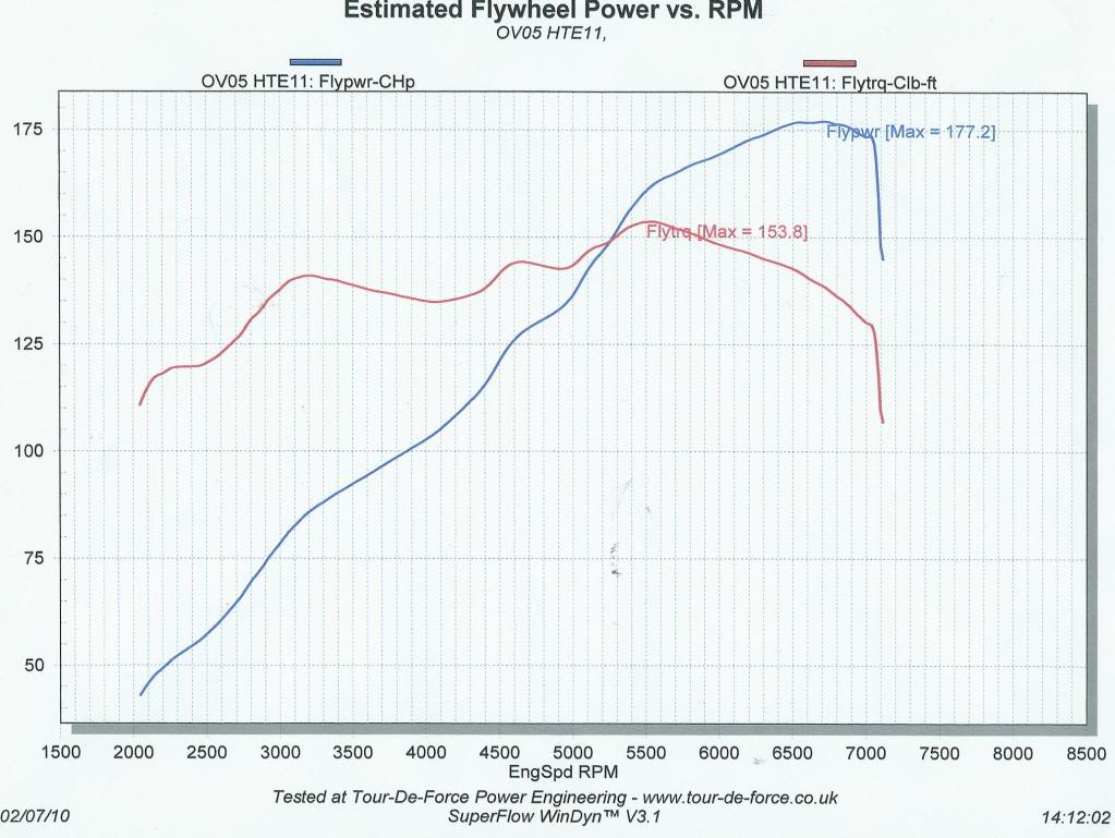

I had it remapped at TDF this weekend, the graphs and comments will be posted later ;)

where did you find the Spax kit, and was it expensive?
I've been trying to find a suspension kit for mine as I also found the eibach springs a little crashy with OE dampers.
LiquidRich
  LY R27
Car looks lovely.
Got the Spax kit from a place in Corby, can't remember what it was called now. I got the kit for £500 after a bit of haggling lol.
They wont fit straight on your car if you have the cup pack though ;)

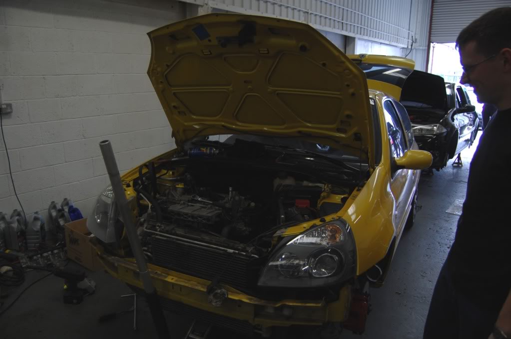

**CATCAM UPDATE**

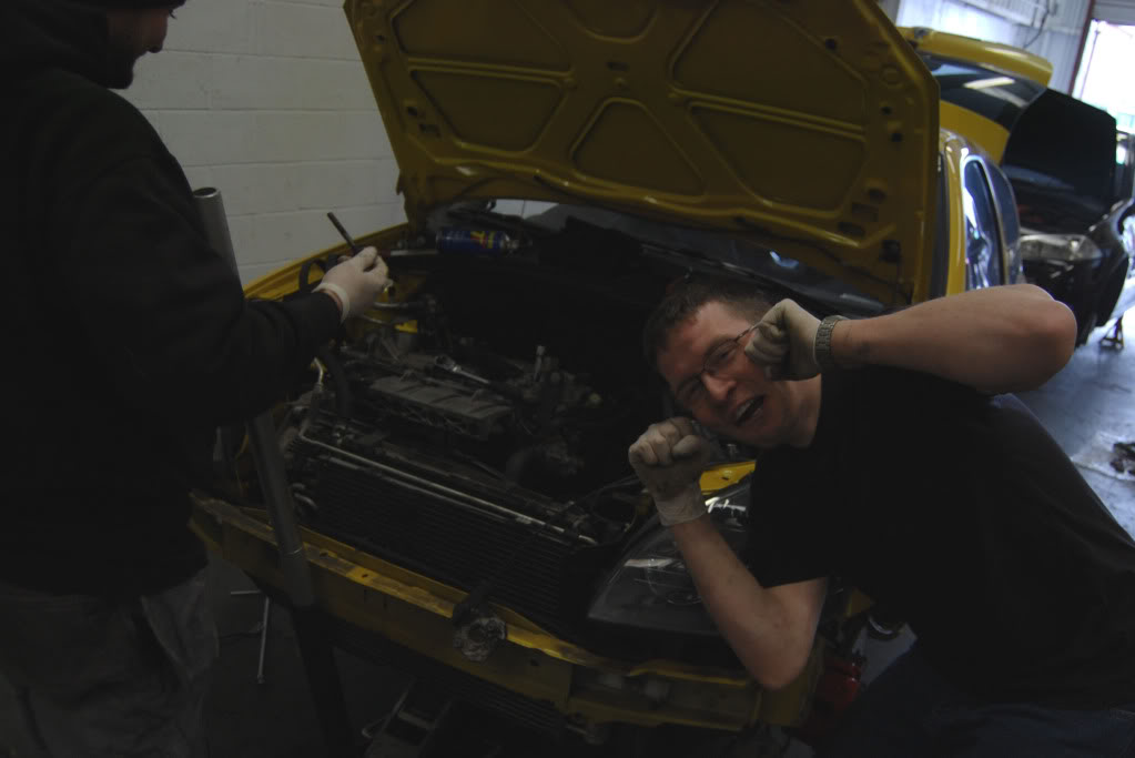

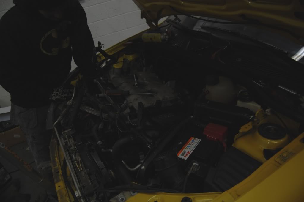

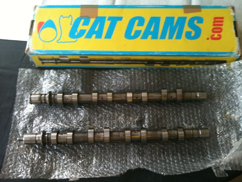

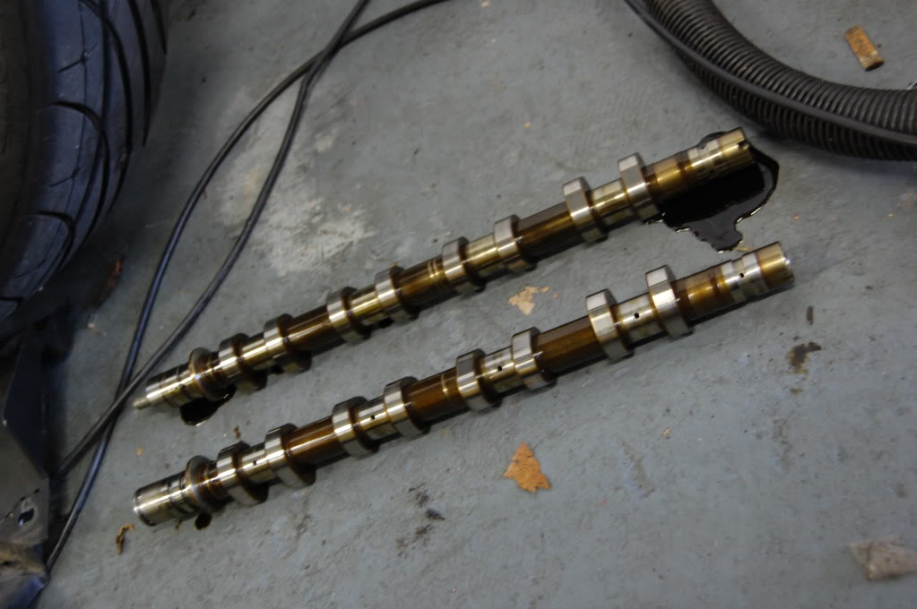

2 weeks ago I popped over to Birmingham to see Fred at BTM. The car needed a new Cam and Aux belt so this was the perfect time to get the CatCams fitted. Fred was recommended to me by Matt @ TDF (recommendations don't come a lot higher imo) oh and Naith ;)
Me and Naith got there at 10:30, no Fred lol
Now what Fred lacks in time keeping he makes up for with knowledge and ability, the bloke is a legend. I'm anal about making sure my cars are well looked after and I will have no hesitation about sending either of the Clio's to him in the future:hail: Fred you are my new mechanic :)

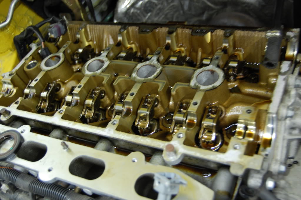

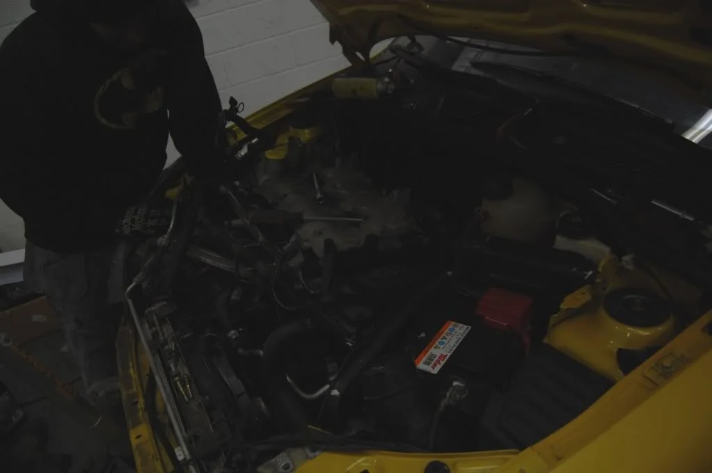

So the work began
Me crying at seeing her in bits lol

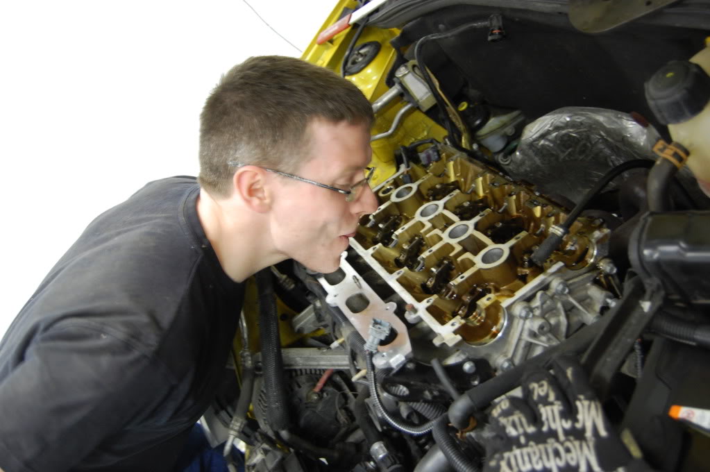

Old Cams out
mmmmmm engine
Me constantly bugging Fred with lots of "whats that" and "hows that work?"
While Fred was working on the 182 I was fitting these to TDK
And the car going back together

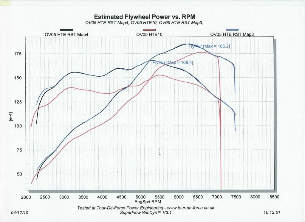

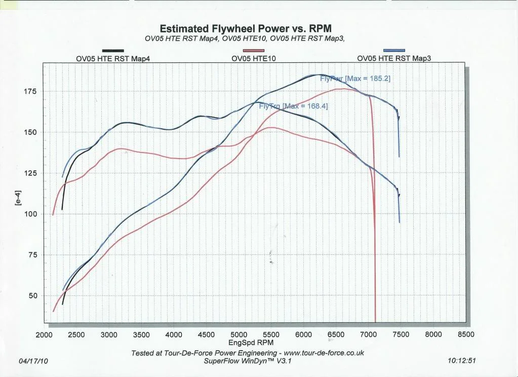

Anyway, I left BTM and could instantly tell a massive difference, when the car got to 5K it went mental. I got home and the car stayed in the garage until last weekend when I went to TDF so Matt could remap the old girl. And here are the results.

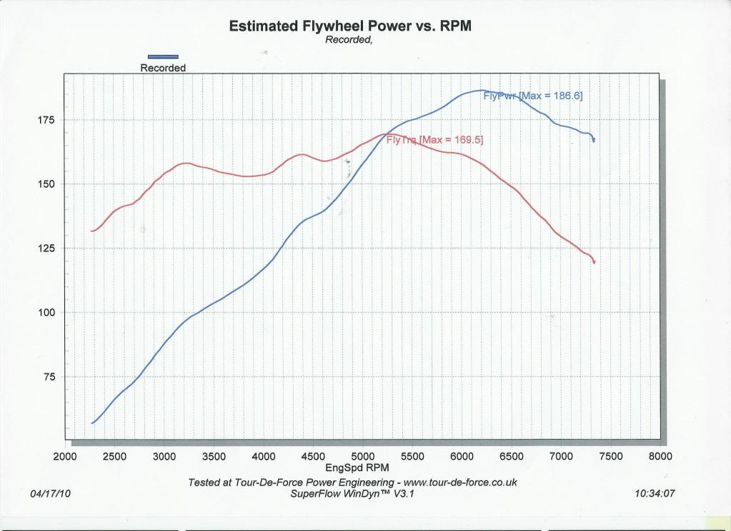

This is a comparison to when I had it rolling roaded in Feb, but not quite the final result
This is the final figure. An increase of 10bhp peak power and nearly 20 foot lb of torque :D
All I can say is WOW, I am well chuffed with the result. The car was quick before but its feels mental now. There is so much more power between 4.5K and 6K, which is right where you want it :)
Just want to say a massive/enormous thanks to both Matt @ Tour De Force and Fred @ BTM. These blokes really do know what they're talking about and what they're doing, they don't have the reps they have for nothing people, you are both LEGENDS. Thanks :D

which catcams did you fit, out of interest?
Thanks
I went for the 428's after speaking to Matt @ TDF
