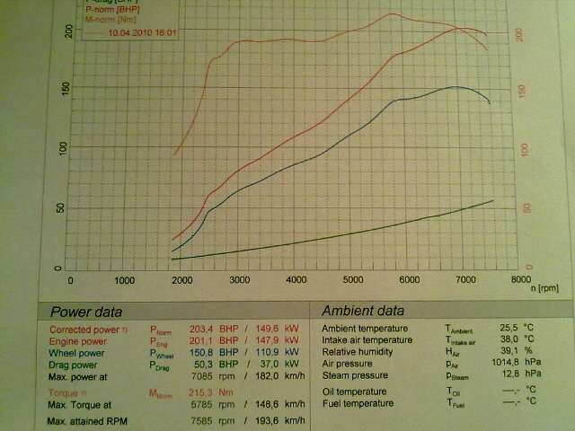

On the dyno today
  clio 182cup
At last...on my 182 engine.
this is on correction according to iso 1585 . On Din 70020 kick's up to 208Bhp
421's
12.8:1, wossner pistons
clio 197 inlet
scorpion exaust
Siemens ecu

Awsome result.
Is the hard work of fitting the 197 inlet on worth the ouput or has most the power come from the other modifications?
  Lionel Richie
50bhp transmission loss?
great to see something different, but no way in hell does a clio lose 50bhp through the gearbox! no way, no how!
  clio 182cup
It's a MAHA dyno, Yea i agree it is lot...
Look at this dyno ;)
It's standard renault engine (and 44Hp gear lose) on DIN 70020 correction
from 174 Bhp to 208 is a 30+ gain. That's impressive:approve:
But please look at the torque!!! This come's from 197 inlet and CR.
I forgot to say that idle is little higher @ 1000rpm due to 421's . Work beter there!
Mixture/ign fluctuate between 13.8 to 13.5 / 22° from 7000rpm and on.

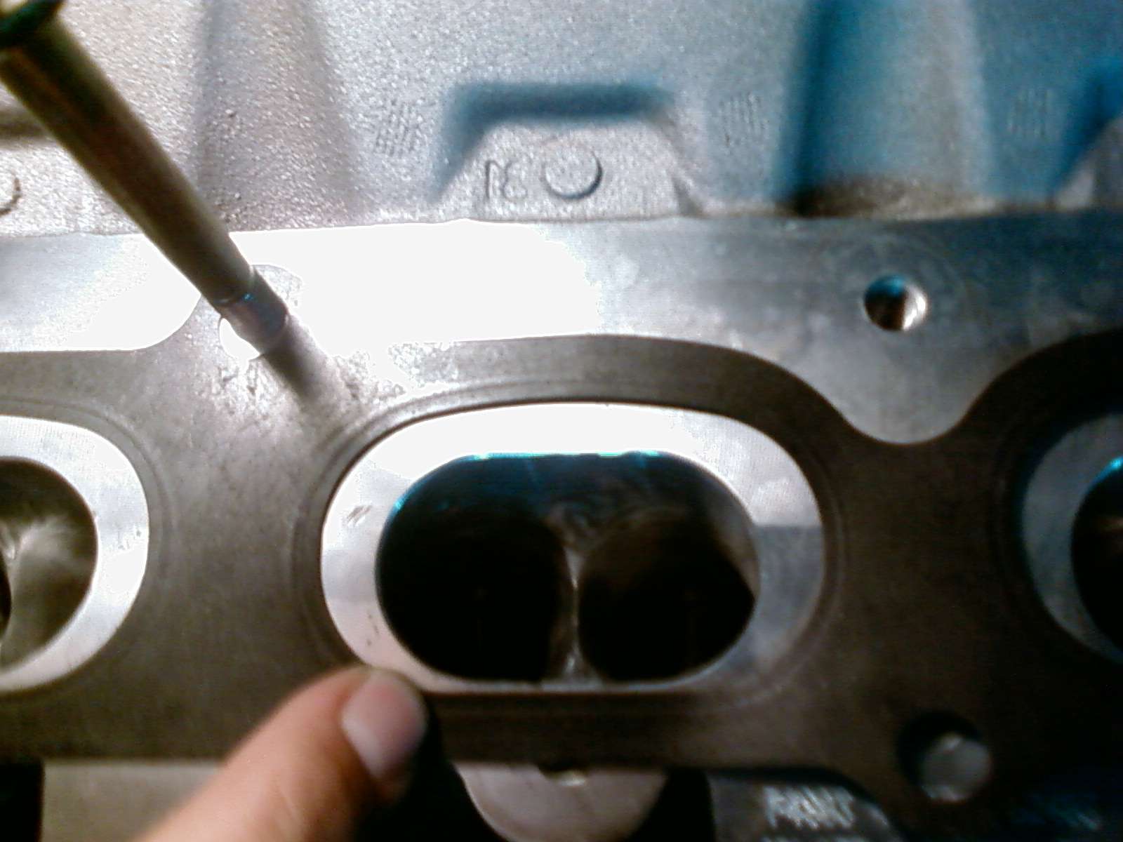

I'd like a bit more info on the 197 inlet mod . . . . Please!!! ;)
  clio 182cup
Need to drill 4 new holes to the head
And that's the diffrence between 182 head on 197 inlet gasket... Need's work there.
Some inner cutting to the bonnet 'cause it hit a little!!!
And to solve the the air intake problem. I 'll relocate my battery at the boot, flat the siemens ecu to make more space.
Need's remap with lot of work.

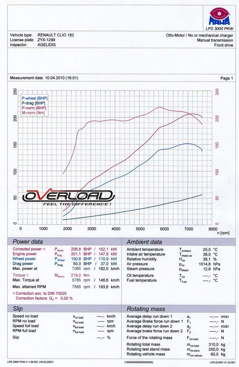

  clio 182cup
So here it is From this (DIN correction 70020)
to this (DIN correction 70020)
On MAHA Dyno.
  172 - 249bhp @ the wheels
Mine was losing 8% at the last RR it had, 249bhp @ the wheels and 270bhp @ the fly. Those look like the Dastek printouts you get?
  Clio 197 BMW Msport
Is the 197 head compatible on a 182 block? Is it pretty much the same except for the inlet and outlet sizes?
Very interesting to see this mod being done! and not only that you can actually get at the plugs!!!! ;)
