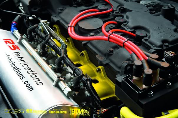

  R26
Does look nice, I like tdf, Matt mapped my megane a few months ago. But if it was me I would go for gen90 still.
