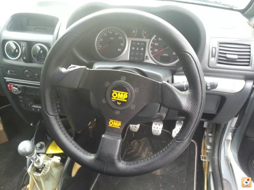

Have you got a photo of where you fitted the gauge?

It's not exactly pretty but it will be serving a purpose.

Looks alright, I'm looking to bin the radio in mine to fit an oil temp and pressure gauge strikes me as a good idea seeing as I've just shelled out for a new engine.
