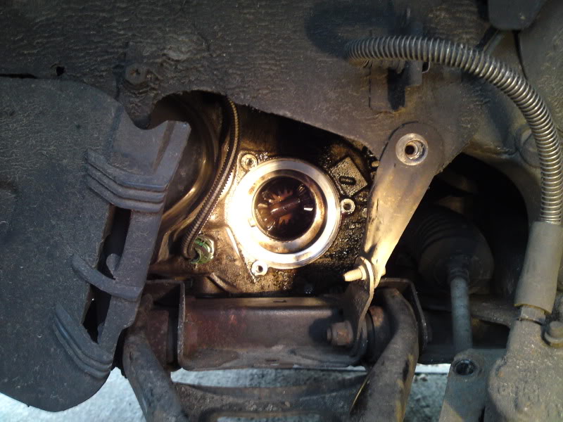

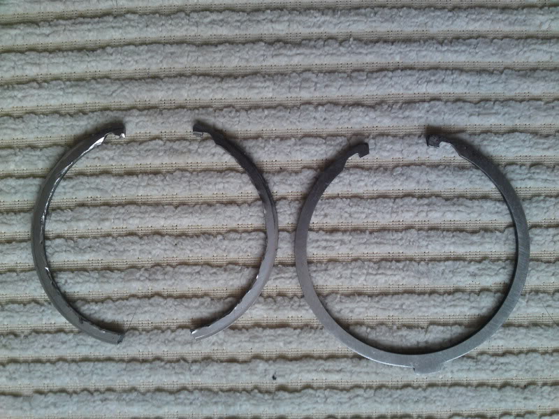

Stripped off the n/s driveshaft, the engine has indeed spat out its sun gear & circlip etc... :eek:
Cheaper than a new clutch I suppose... will get pics up asap, new circlip & washer on order, here Tues - £6 the pair? Driveshaft has been off before so might be the second time...

Found my washer & circlip nesting in the n/s boot...

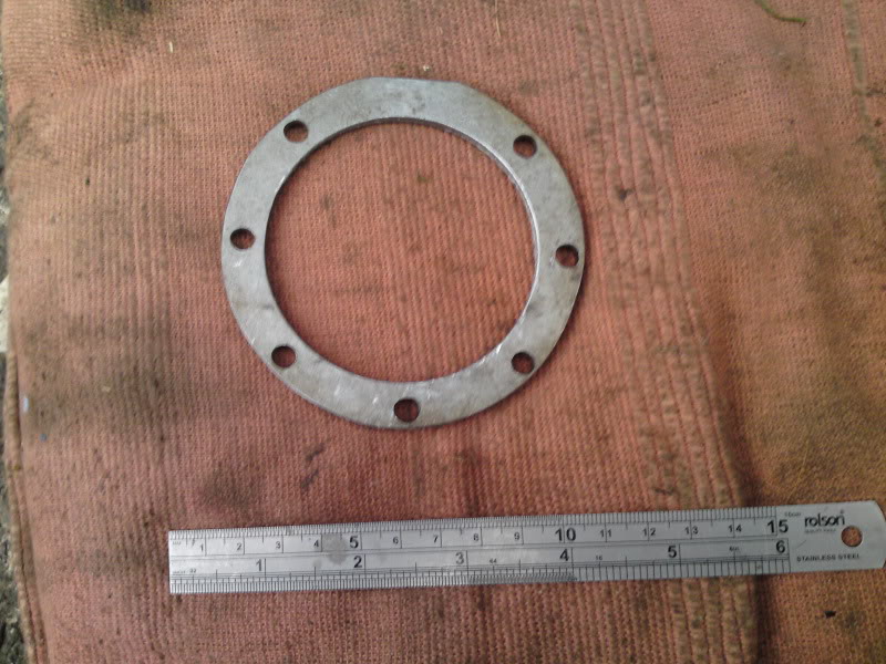

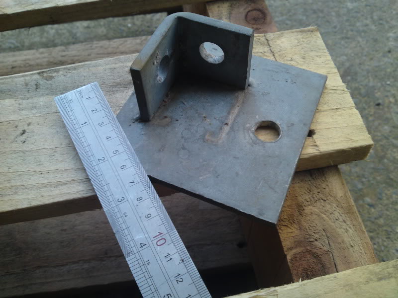

A quick measure up gave me an I/D of 70mm, an O/D of 95mm and at least 4 mounting holes needed - M6 bolts centres 5mm in from the O/D? There was also a 4.5mm gap to fill in inbetween where the circlip sits and the plate - the thrust washers are 1.75mm thick, giving 3.5mm depth for two, meaning I had to fab another shim washer out of 1mm steel plate to give me the total shim pack of 4.5mm.

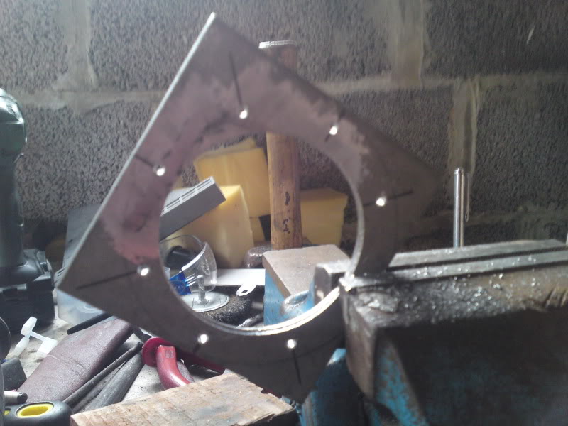

Swiped a suitable 4mm thick piece of plate out of the scrap bin at work:
Removed the L-shaped bit and marked out the ring, 3mm pilot holes for the 6mm bolt holes:
Finished - one of the holes sat over the recess for the lug on the circlip/tab washer so I didnt drill that one...

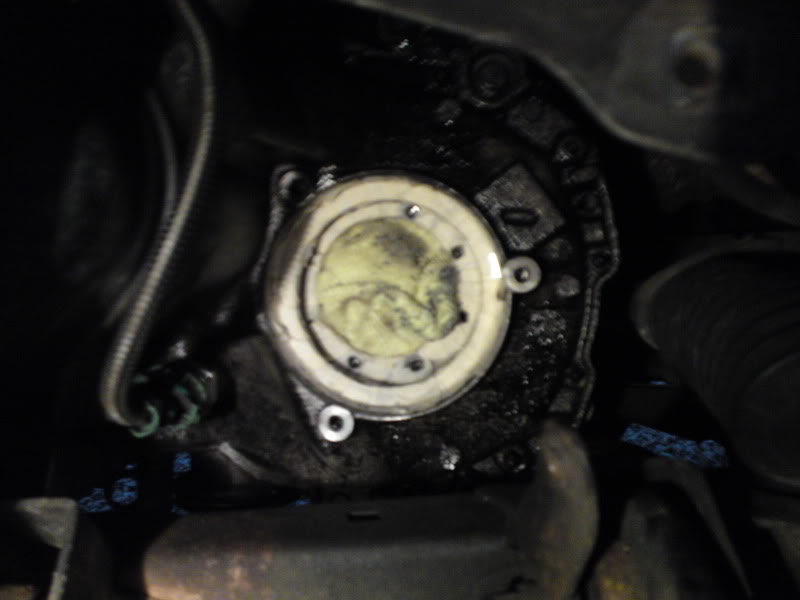

Access to said diff is understandably limited. ;)
I removed the bar in the middle right of the pic but nevertheless got extremely acquainted with the inside of the N/S wheelarch.

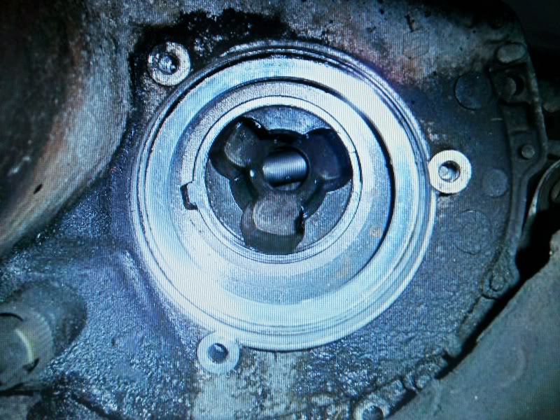

Tape from the inside out in layers to prevent any swarf dropping into the gearbox, mark & drill all mounting holes for tapping. Hoover the worst of the swarf out then have a delve round with a magnet stick. The diff itself is cast iron & drilled ok with normal drills?
You have the bump the diff round to do the far holes as it sits in an eccentric? Pop the car in second gear and nudge it round on the starter until you have access.
Driveshaft back in, hub, caliper, oil, disc etc - and drives a treat!

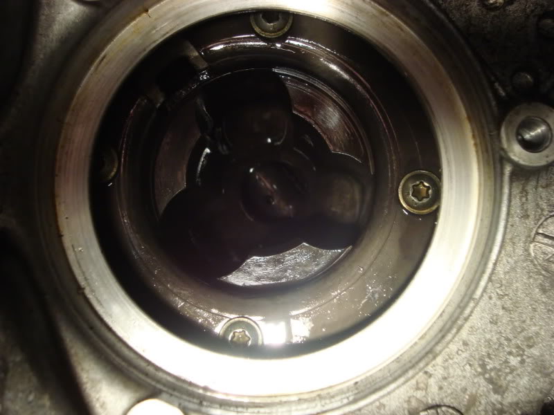

This is the Renault bolted arrangement, cant remember which box?
