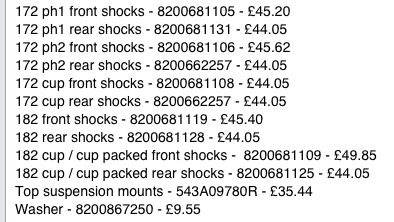

Wests renaults price says £45.05 each for OEM, Ebay is £86.90 delivered for the pair, again OEM.

All the dampers are different across the range apparently mate, cup packed is different to the Cup, normal 172's are different aswell etc

172 and 172 cup rear dampers are the same.
OEM last longer, some non genuine last less than a service, especially if lowering springs are involved
  DON'T SEND ME PM'S!!
No they're not
bullllllllshit! I've seen genuine last less than 8k. They're only made by KYB, they're nothing particularly special. The sachs ones are OK, but they're equivalent to a normal 172, no cup/cup pack equivalent available

No they're not
This would very much suggest that they there, except the Ph1.
I'm only going from experience from myself and others on here, I've had a non genuine pair last about 6k and genuine on Apex Springs last 20k
