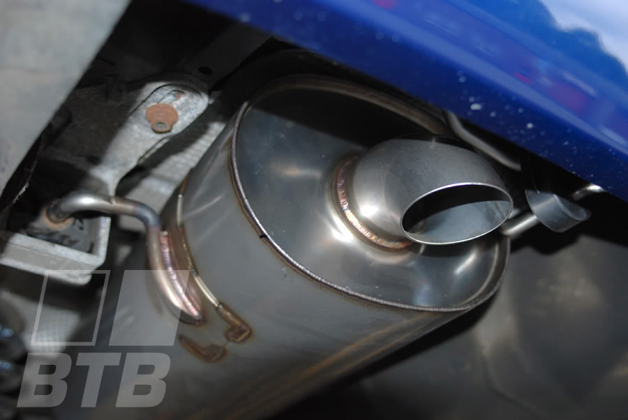

Thanks, the BTB looks nice, will the welds rust? If you look at the pic below, it looks like the welds on the backbox bracket and tailpipe look a bit orange/rusty already?
I may be totally wrong as i know very little about welding!
  Sprint 172
That's not rust mate - proper TIG welding.
