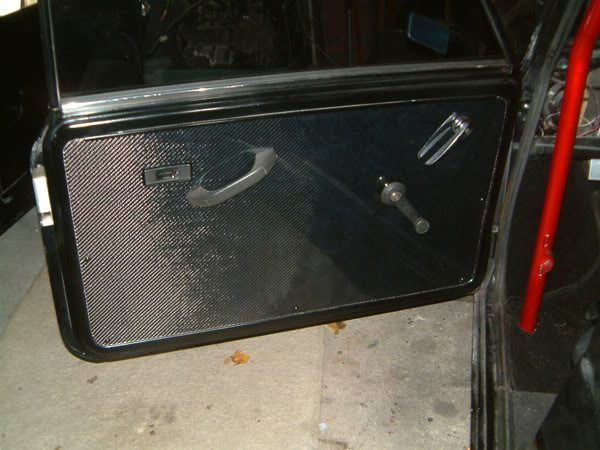

Carbon Fibre door cards

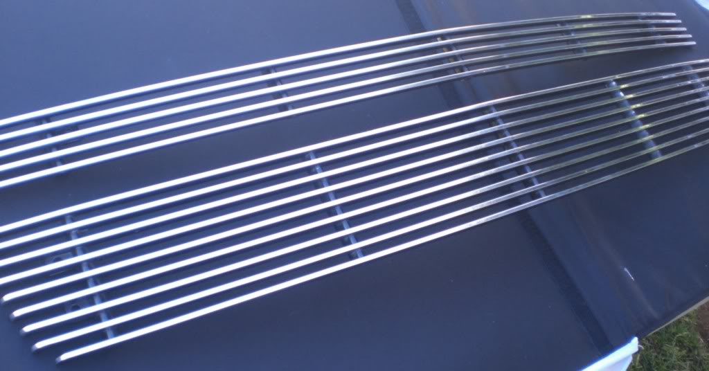

Chevy Tahoe Suburban Grill
This is the only grille I could find with the slatts how I want them, gonna be a bit of a mission getting them to fit in the clubman surround.

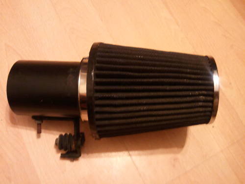

K&N Filter

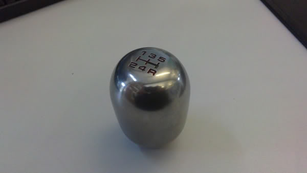

Type R gear nob!... (cant believe how much it weighs!..)

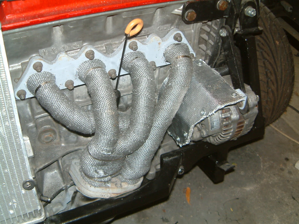

As mentioned the car is about 95% complete - got exhaust wrapped and made a heat cover for alternator.
