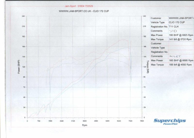

did a bit of work on the clio last night, people have always been saying the standard inlets are rubbish, very poor matching etc. so i took the liberty of finding a spare inlet and matching it, open it up to match the head etc...
to be honest i was impressed with the gain, but it matches what everyone else says.
i also added a new exhaust at the same time so i dont expect the gain to all be from the inlet!
as standard the car was:
166bhp 141lb ft
with matched inlet and cat back yozza sport system:
185bhp 156lb ft

how accurate is our rolling road, well we calibrate it every 3 months.
however one run to the other was a few hours apart, the proof of there being a gain is still there, did 3 runs with no difference rather that just one run on each set up.
I didnt believe the gains would be anywhere near what they were,
  53 Clio's & counting
even if the power isnt 100% accurate it doesnt take away from there was a good power gain there, i say fair play chap
Coby.
Same Dyno = Same Higher/Lower readings so the Difference should still be Pretty accurate

well as can be seen above it works well with a ported inlet! i should have done a run with the exhaust and one with exhaust and inlet, but i didnt have time and i wanted to go to bed!
exhaust fits really well tho, makes a change from some of the systems we see thru our workshop!

the jamsport dyno was pretty spot on compared to another on my bro's c20xe corsa... broster, you know the one ;)

Before a cat , after no cat ?
