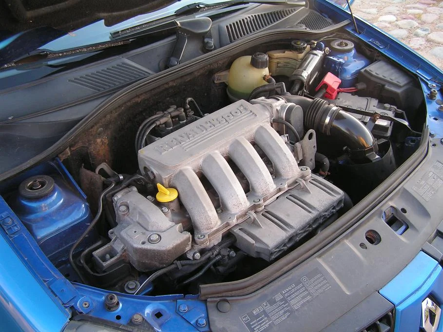

Nothing special almost stock except noname induction kit.

EPAS (custom alternator bracket)

Interesting, is that a straight swap in then, and how do you control the ecu for it, do you have any form of adjustment for it?
(like previously I used a corsa b one, and had a dial to allow me to alter the amount of assist)
On my corsa where I used a similar controller, I still had to run the original power steering ECU as well, do you do that on this one or does it talk directly to the column and motor?
Is the motor on the column itself, or on the rack? any pictures of it?
Yes this controller needs oem steering ecu - and the motor is on column. Will do foto later. I'm not realy happy to use EPAS - in future i hope to find clio 172/182 hidraulic rack (it's not so easy here :) ) - and use it whit kangoo electric/hidraulic motor.
You might surprise yourself with how much you like the electric setup once you can adjust its firmness, I used to really like my adjustable Corsa one, you could have it featherlight for manoeuvring and then on track you could have it set really firm so you got lots of feel for what the car was doing.
