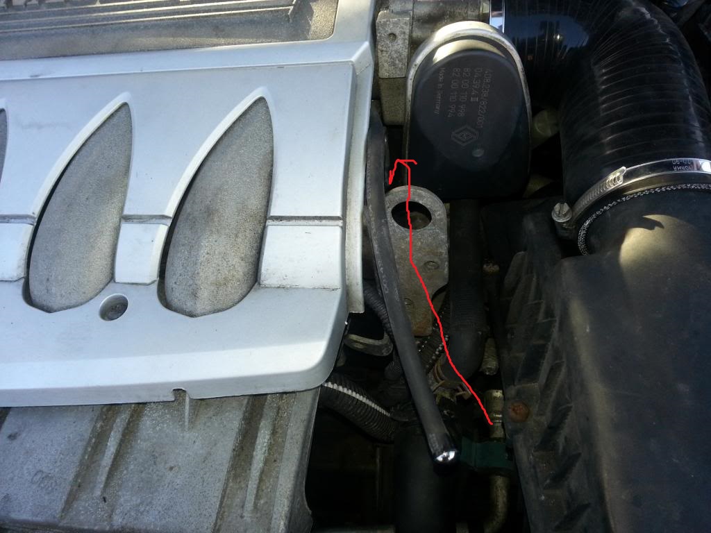

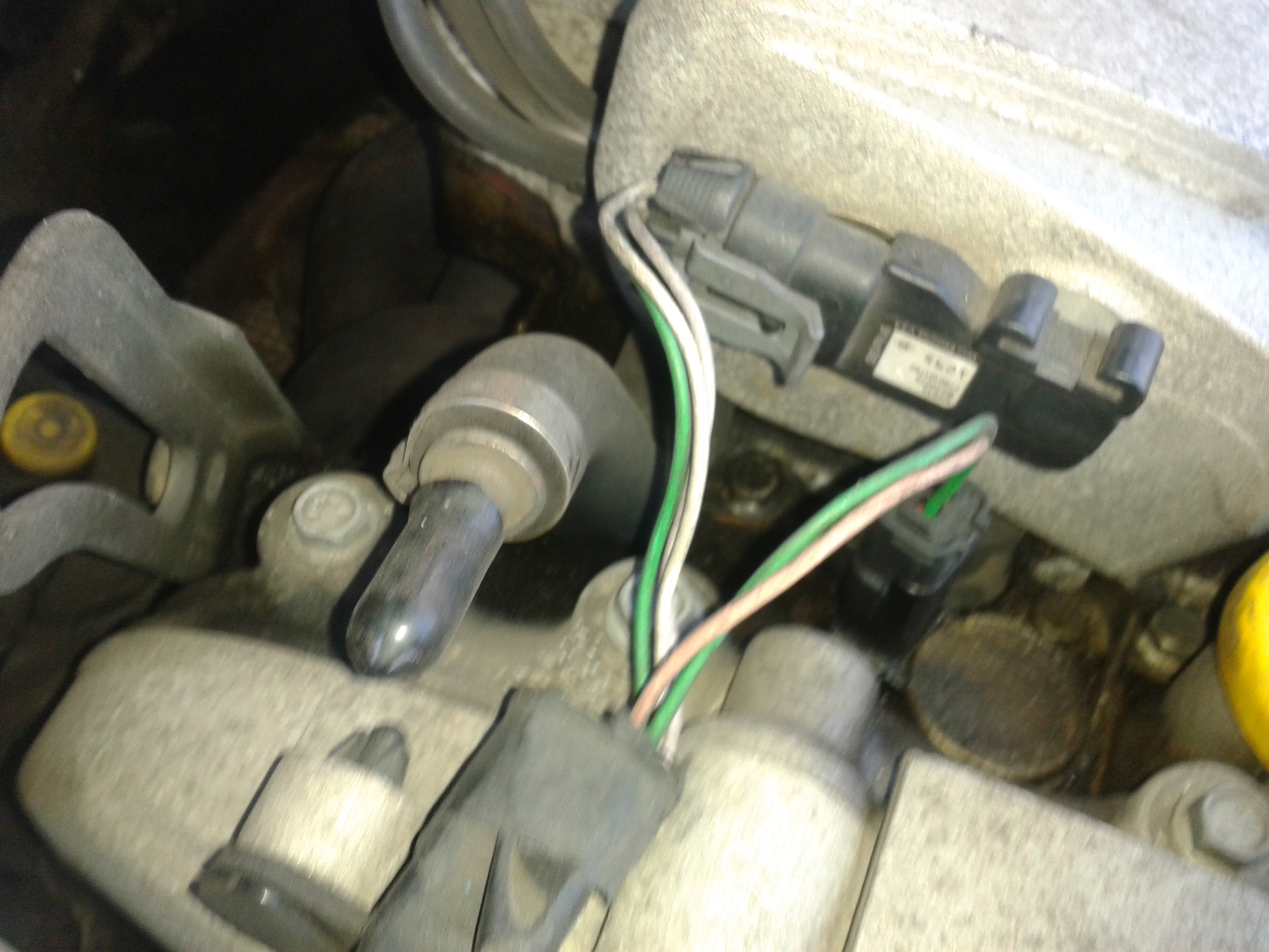

Acoustic valve you say....? Hmm.. i remember removing that a year or so back, but i don't recall blocking of the pipe..
And the top of the carbon canister has a habit of popping off.
Cap the take off here.
Acoustic valve hose take off point.
  172 Ph2
Yep, will block off tomorrow - i've got a good feeling about this lol
Not touched my carbon canister yet
  172 Ph2
Acoustic valve vacuum was already blocked. (Would have been surprised if i hadn't really)
Will cap carbon canister as per your picture. Just need the feeling to come back to my hands.. fook its cold.
