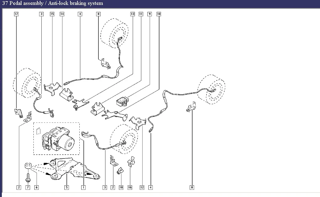

Does anyone know what holds the ABS sensor in either front hub on a Phase 2 225 Megane cup?
Ive been told its part of the front bearing assembly - is this right???
The sensor is poping out apparenlty.
  Megane dci 130
It's not on that page. It's part of the wheel bearing kit. Try tightening the metal part where the sensor clips in.

Yes they come with the bearing kit. They break with time so you have to replace them, which means a new bearing as they are sandwiched between the bearing and the swivel hub.
